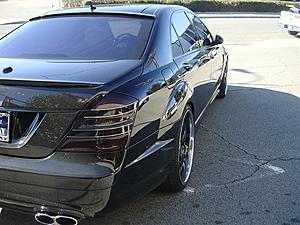

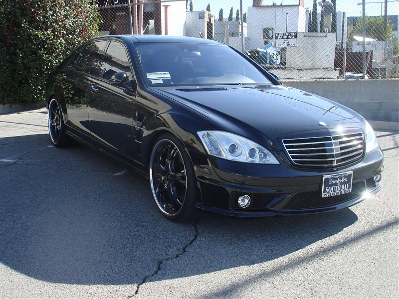

Just finnished this S65 for a client.
Chipped, lowered, custom bodywork, 20" wheels, custom made exhaust and painted calipers red.
This thing is a monster, no speed limiter, dyno charts to follow, but we think close to 700bhp.

Powerchip for the ME control unit. Car is set up for 100 octane gas, but can run on pump 91 ok. Exhaust on the S65 only has rear boxes, so we cut infront of the rear axle, and fabricated pipes, with a small resonator , and put on the original tips(clients choice). Sound is not much louder (turbo's prevent this) but it is deeper and has more "throat" to it when on the pipe. Lowering is as easy as other Benz's we fabricate custom linkages to the clients desired ride height, readapt the suspension control unit, and trim the fenders/bumpers as required.
Trunk lid spoiler and front fenders are also custom made.
Wheels are a personal choice of the clients, not to my taste but they fit the rest of the car.
I will get a video as soon as I can. I cannot get the guy to stop driving it, to much fun !!!

DAMN that is one sick S65, u don't play around lol. ur car looks rediculous and evil
quick question, did u paint the calipers with enamel? or did u have them powdercoated? i heard u shouldn't powdercoat these calipers thats why i ask.
Reply 0
Mar 5, 2007 | 10:53 PM
Quote: DAMN that is one sick S65, u don't play around lol. ur car looks rediculous and evil
Thanks, I think the paint is enamel based, I would have to ask my painter. We do the same thing on lots of Ferrari's and Porsche's, even did an SLR for a client before red callipers where available.Works good, but you have to be careful installing the pads otherwise they squeal like a ******!!

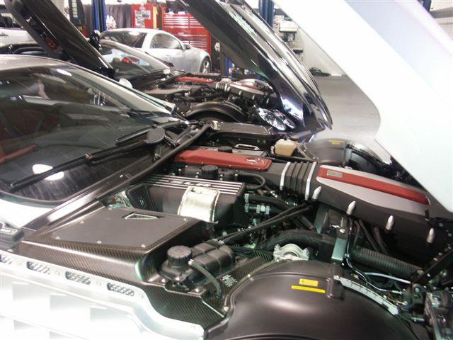

Quote: Damian,
Glad to see you take a break from the SLR's The S65 has an awesome stance and I'm sure the wheels are an acquired taste
I some times wish I got to take a break from them !!
