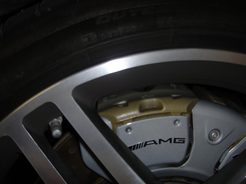

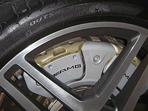

No mods yet. I shipped the car to Cory @ Kleeman last month so they could fabricate the downpipes for the S63 for mass production. I am dropping it off on the 4th of Sept for: Headers, Downpipes, HighFlow Cats, ECU & Rear differential mods.
I am starting to go with an overheating issue. Fuel level was at 50%. I am taking it in for a fluid change hopefully today (engine & trans). I have an exploratory service scheduled for Monday but hope they can plug in and pull the readings from the CPU to check vitals and maximun levels reached on the guages/sensors.
To give an idea of driving agressivness -- My front brake rotors are now permanately baked to a gold color. The badge plates are still silver and the pad retention frames are silver but the calipers definately got some heat
hahhaa u definitely worked ur s63!!!!
