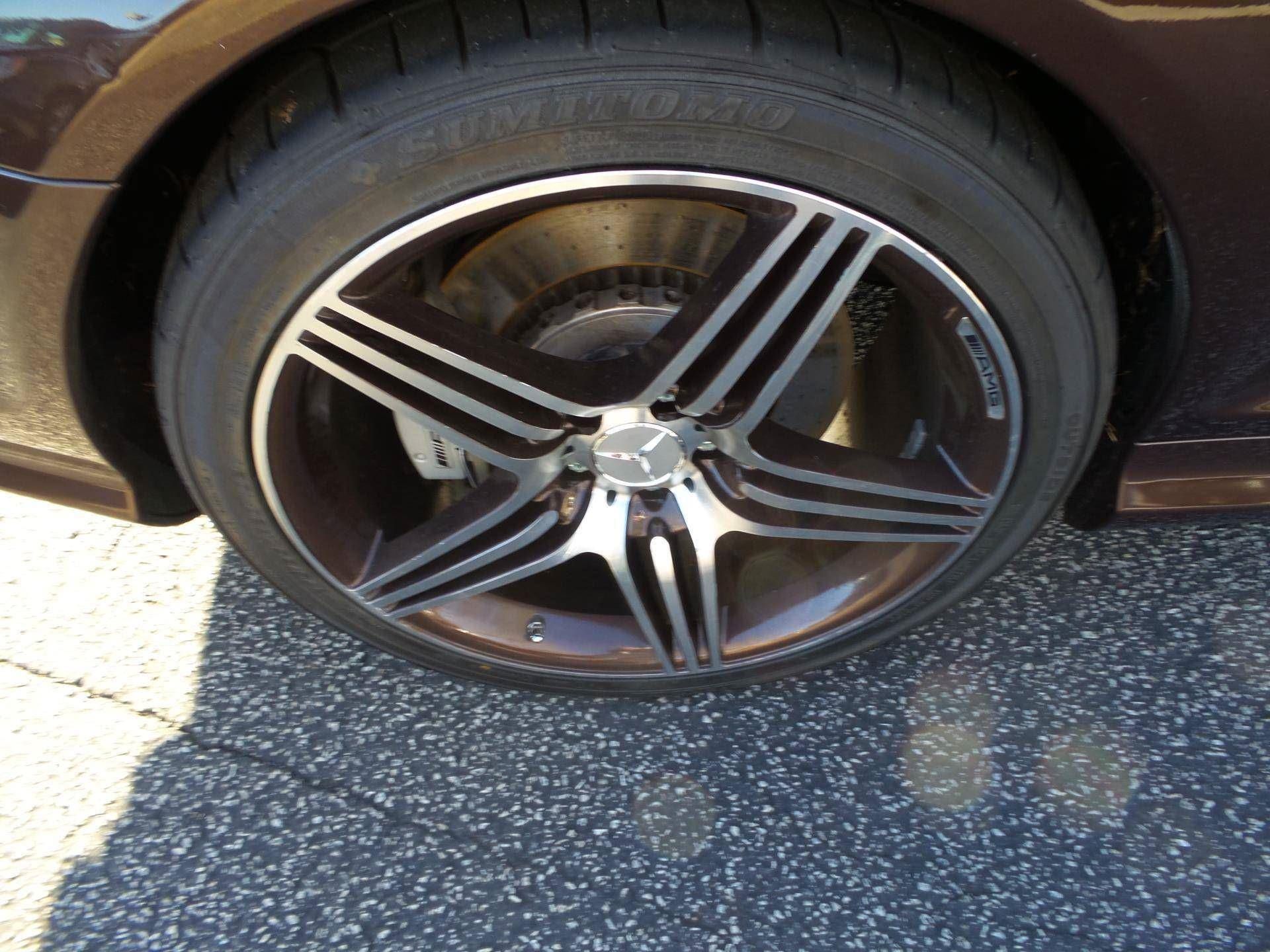

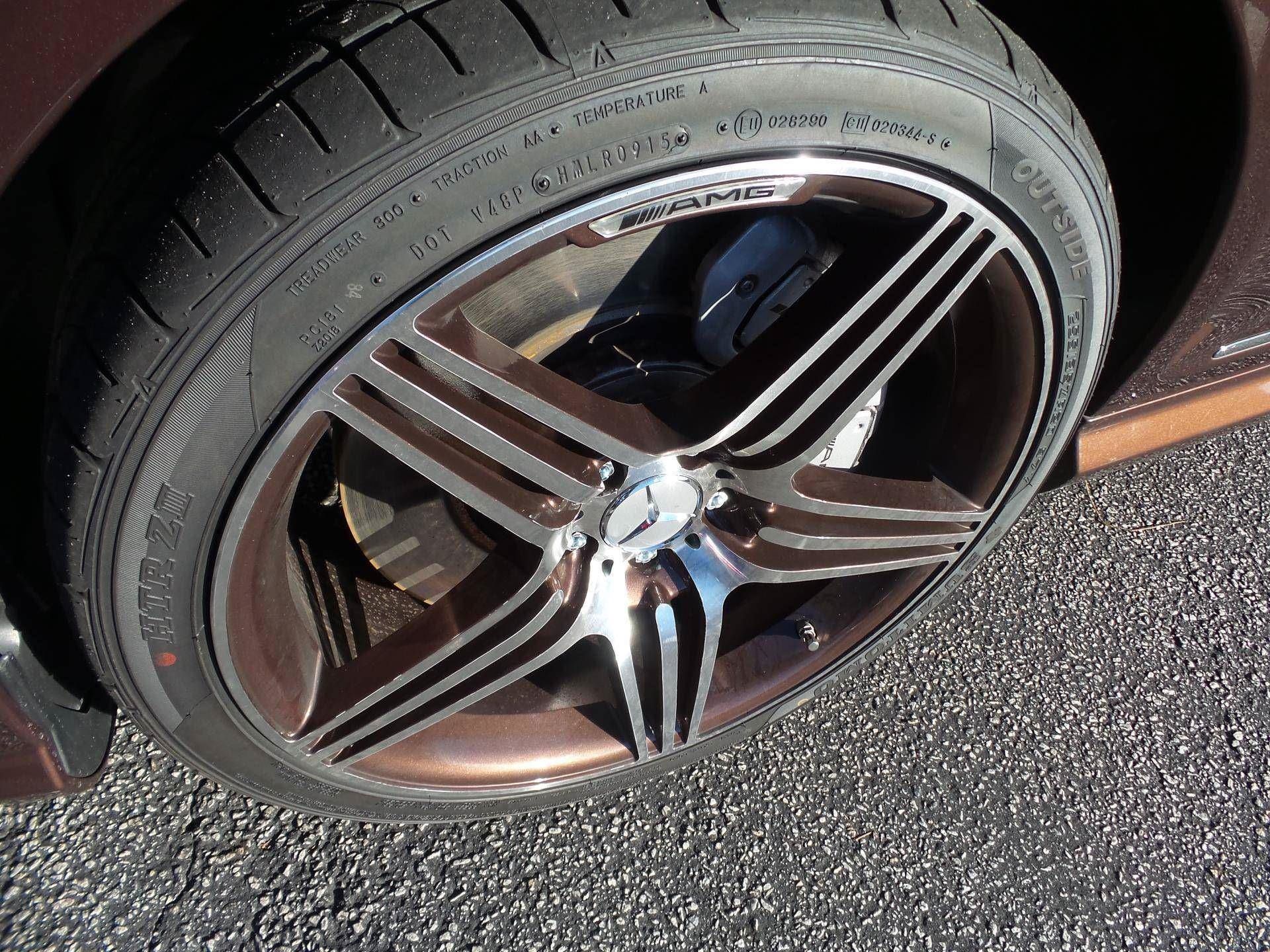

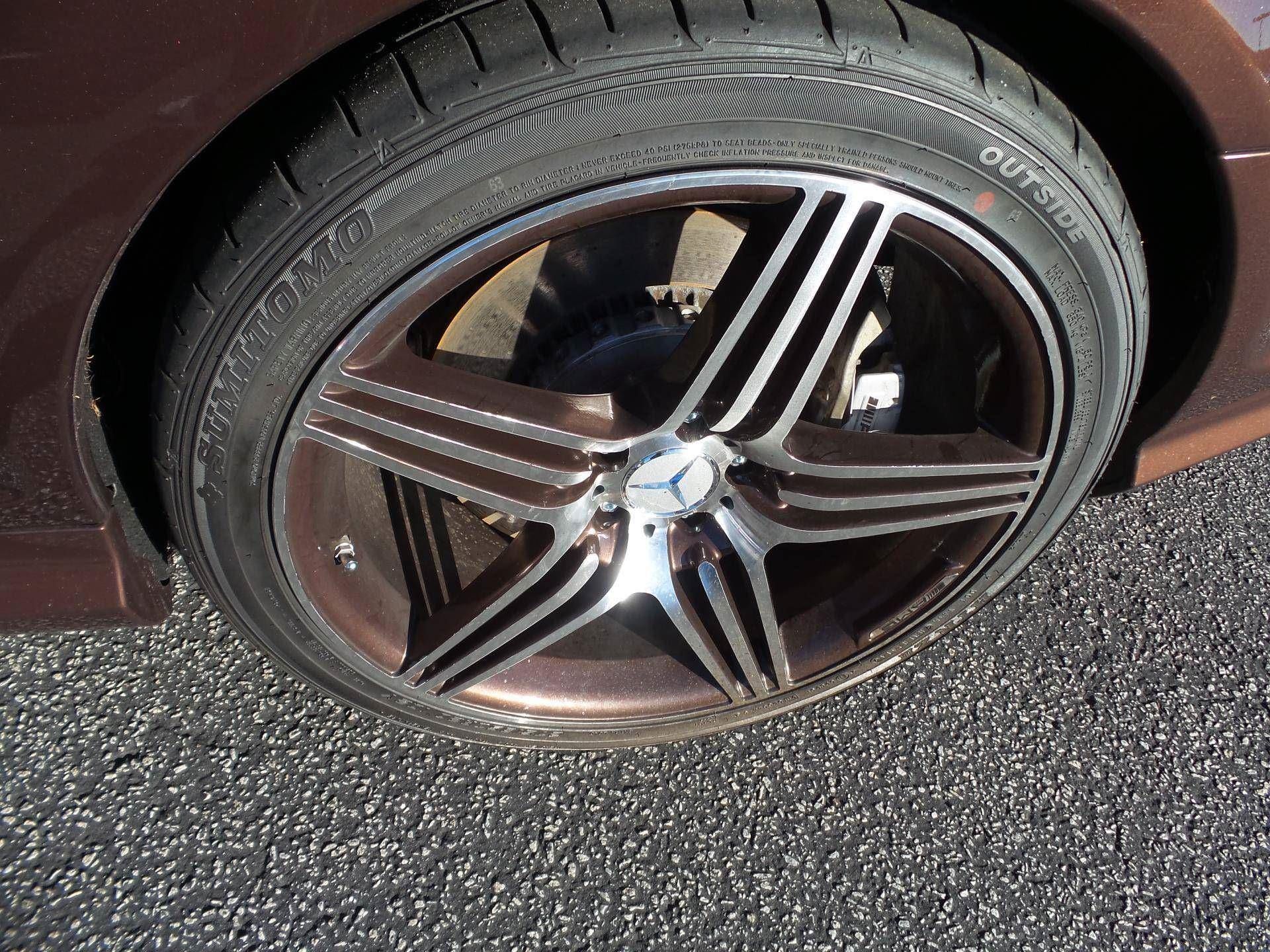

Sorry to revive this old thread, but I'm looking at a used 2011 CL63, and have a similar situation.
I have attached pictures of the current rotors on the car, which don't seem to be cross-drilled. Does anyone know if the S63/CL63 also had these dimpled rotors? On the first picture there are some circle visible but I'm not sure whether it's just some surface marks or worn-down dimples.
Is is possible that the rotors were replaced with some cheapo aftermarket rotor that wasn't dimpled? Or would only the OEM rotors be compatible with the brake system?
Appreciate the help!

I wore the rotors down enough that the dimples just disappeared. Could be that the rotors are just worn below spec.
