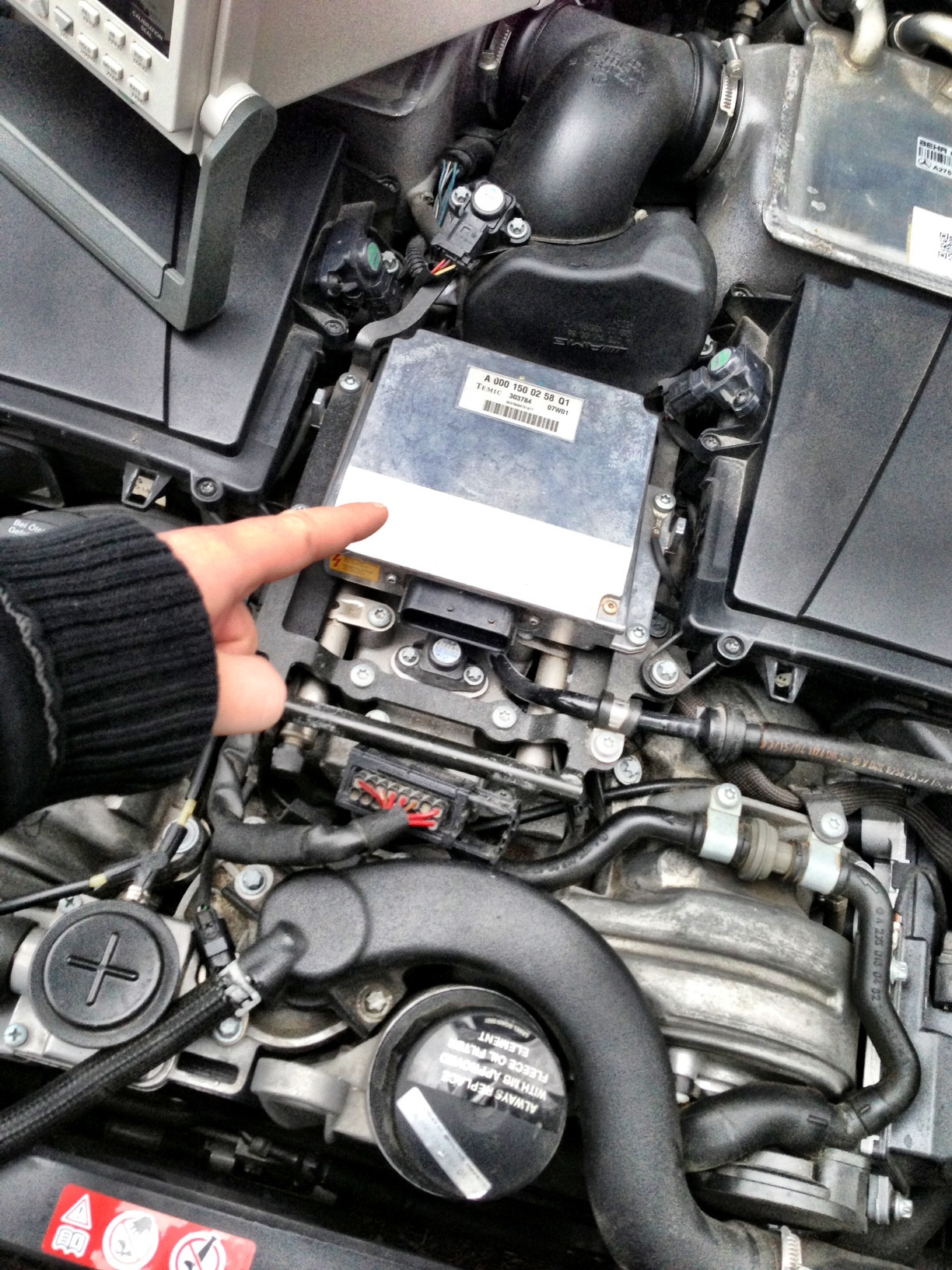

can you post a pic of the part that went bad
Here you go:
W220 S65 - Fails to start / No Crank / Nothing-afzk64d.jpg

Originally Posted by Oxygen
Here you go:
It always scares the crap outta me when one of our cars fail, expecting some mondo bill...Nice that it was a fairly minor fix!

thnak you sir
