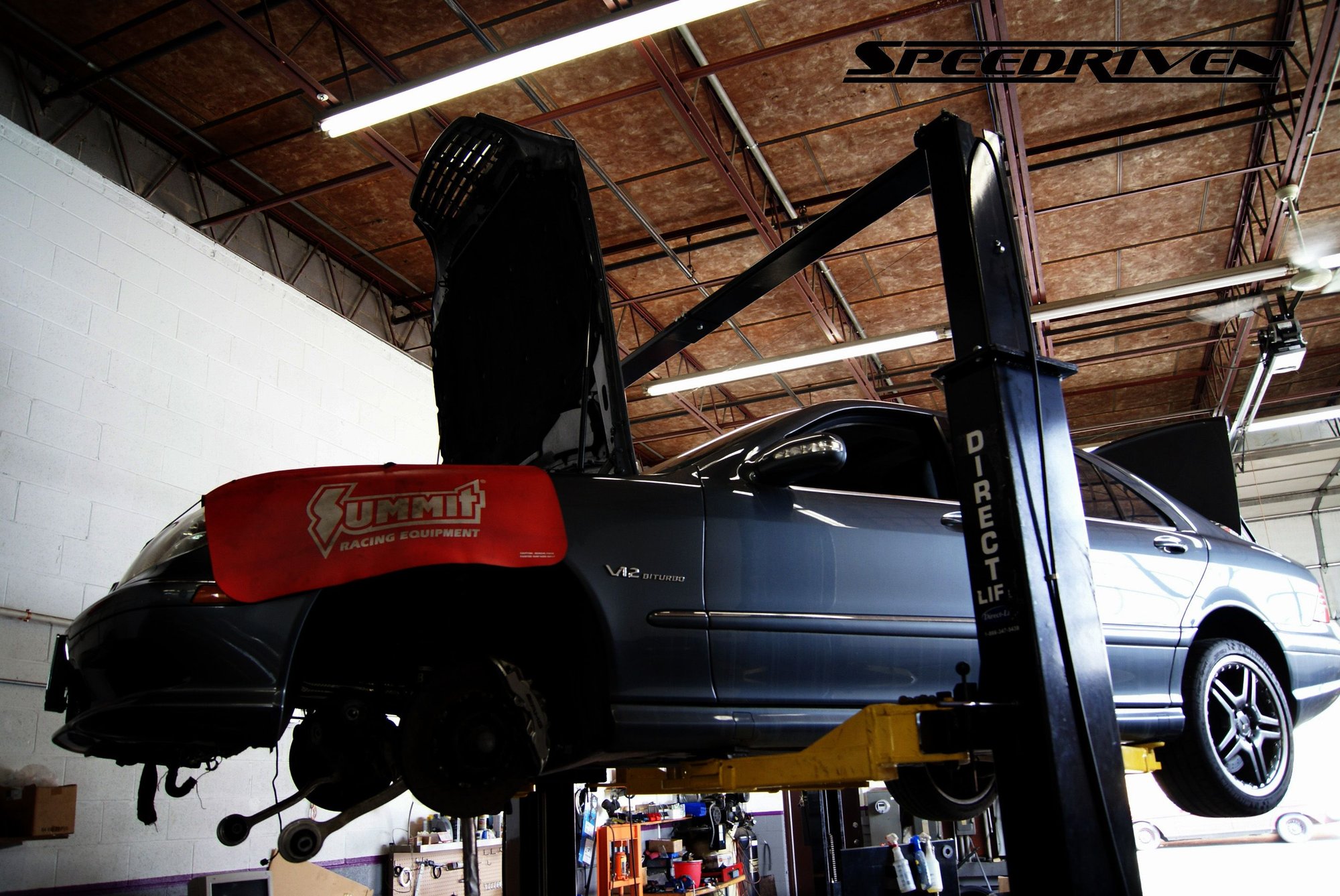

Since the car is nearing completion. Waiting for turbo's to get finished, we will start posting pics daily. We will start with old pictures and catch up. So here is some dis-assembly pics from a month or so ago. All we have to say is "this is a fresh engine". Its a low mileage motor and it is visible.
Clean under-body as-well!!!
The s sits in the air without its heart
Got to love the way v12's look!

Car is coming a long great, same mods as mine just missing the LSD hmmm maybe that's something I should look into before June comes around.
Quick question the pic with the S65 on the lift, is that a car with BBS wheels in the background?

w123 chassis with 30 pounds of boost, rolling on bbs rs wheels
Nice I knew it was something special
