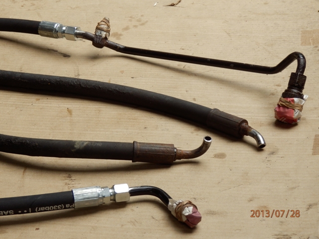

Old Jun 7, 2017 | 04:58 PM
Welwynnick's Avatar
Joined: Nov 2010
Posts: 2,605
Likes: 343
From: Welwyn, Herts, UK
2006 S600
I think the best option is to cut out the flexible hose sections and fit new sections with either flared or compression joints.
I've been doing that for a few years now, and never had a problem.
Standard hoses, standard fittings. Cheap & available in any large town.
Nick
