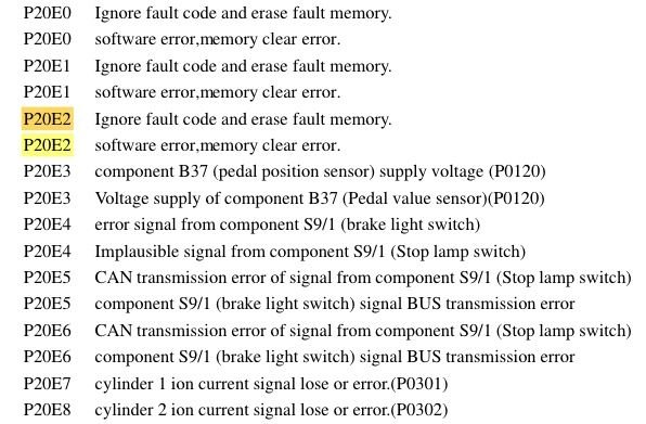

I don't recall ever seeing this code before... and it is a weird code. According to several MB sources, P20E2 just says "Ignore fault code and erase fault memory" or "Software error, memory clear error". Has nothing to do with boost or charge air, as those are completely different codes. Only my MBII comes back with this message.
I don't believe I mentioned it in my original post here, but when I was test driving the car yesterday, I had cleared that code. Floored it a few times to the point that the rear end got real squirrelly. Stopped the car, checked the codes and it was there again. Reset it once more, then drove back to the house. Floored it a few more times (that's when I was able to see the mbar boost readings from the ECU) on the way home. Parked, checked the codes, and no DTC.
So who knows... maybe you're right and the ECU was doing something... maybe adjusting to the new battery? It's going to have to wait though... won't be driving it for the next few months as I just put the car in winter storage and I'm leaving the US for business in a few weeks.
Here's what's from MB specifically:

Xentry shows 20E2 as "boost pressure too high".
Also, 27psi is high for that car, is the car mapped?
My guess if it is, is that the car is aggressively mapped and overboosted during cold weather (anything above 30psi is past the limit of the map sensors). If it is not mapped, then possibly you have a leak in the wastegate control (from the pass side IC Vac hose which goes to the boost pressure control solenoid.)

Car hasn't been tuned to my knowledge, but it's interesting that Xentry shows that code as an overboost condition when other web resources says it's not related to anything pertaining to boost.
Anyway, cleared the code and drove the car several times since then in similar weather conditions and the code hasn't reappeared.
