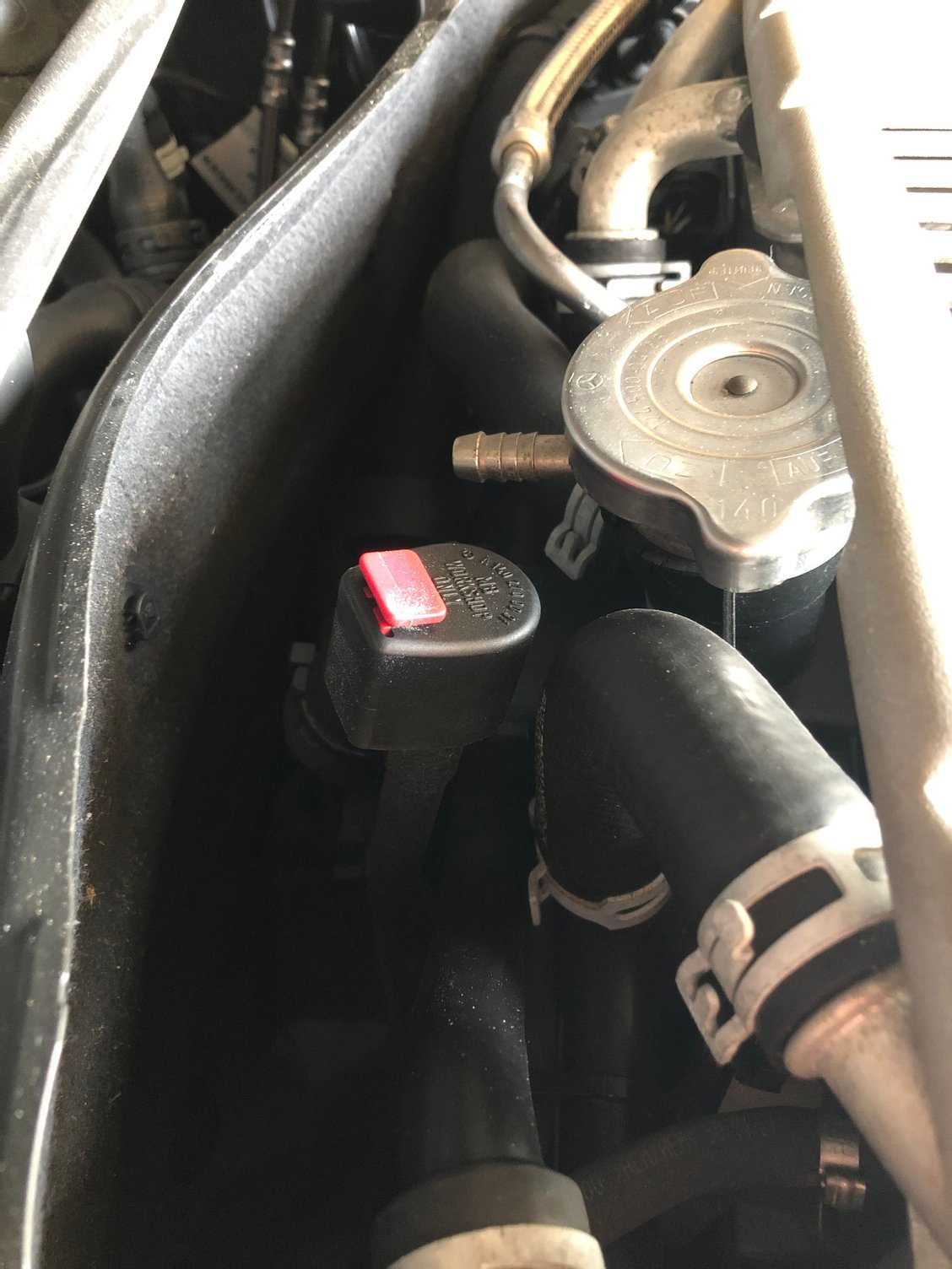

Seems like there’s spots on the windshield after I push it on the highway. It’s happened when it’s been fairly cold so I don’t think it’s bugs. Popped the hood didn’t see anything out of place but didn’t break out a flashlight. Worried that it was fluid venting and spraying the windshield.

Maybe this is the source.

Sure it's not bugs? We have them in quantity early this year.
That 'radiator cap' is for charge coolant. Be sure it is full to the top and that the coolant isn't crusty. That cap gets cruddy with age. If there is a leak it will be on the plastic underneath.

Doesn’t that barb fitting need a hose on it?
Nope! No hose on that guy. I always check that it is full to the top. Squeeze charge coolant hoses to burp air into the neck.
Charge coolant doesn't run at the pressure or temperature seen in engine coolant.
