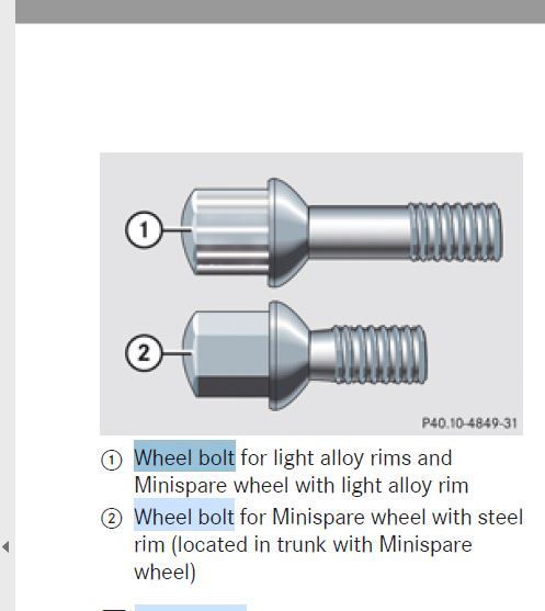

I'm confused. My car has one of the daisy style bolts on one rear wheel. All of the rest are normal 6 points. This screen grab from the operators manual shows that the daisy style bolts are what I should have.
Did one of the po's monkey around with the lug bolts?

The main difference in those is the length. The steel wheel has a thin hub section, and if you tried to use the long bolts from the regular wheels they'd bottom out on the hub, the wheel would still be loose, and if you tried to drive, you'd cause significant damage.
The "daisy" doesn't mark it as a longer bolt when you're looking at the bolt. Here's what I had when I bought my S55, one on each wheel:
There was no key socket with the car, so I hammered an 18mm socket onto the bolt and was able to remove all four. The other bolts were regular hex heads. I was replacing the junk wheels with genuine AMG wheels and needed longer bolts anyway, so I bought a full set of 20 regular hex bolts.
