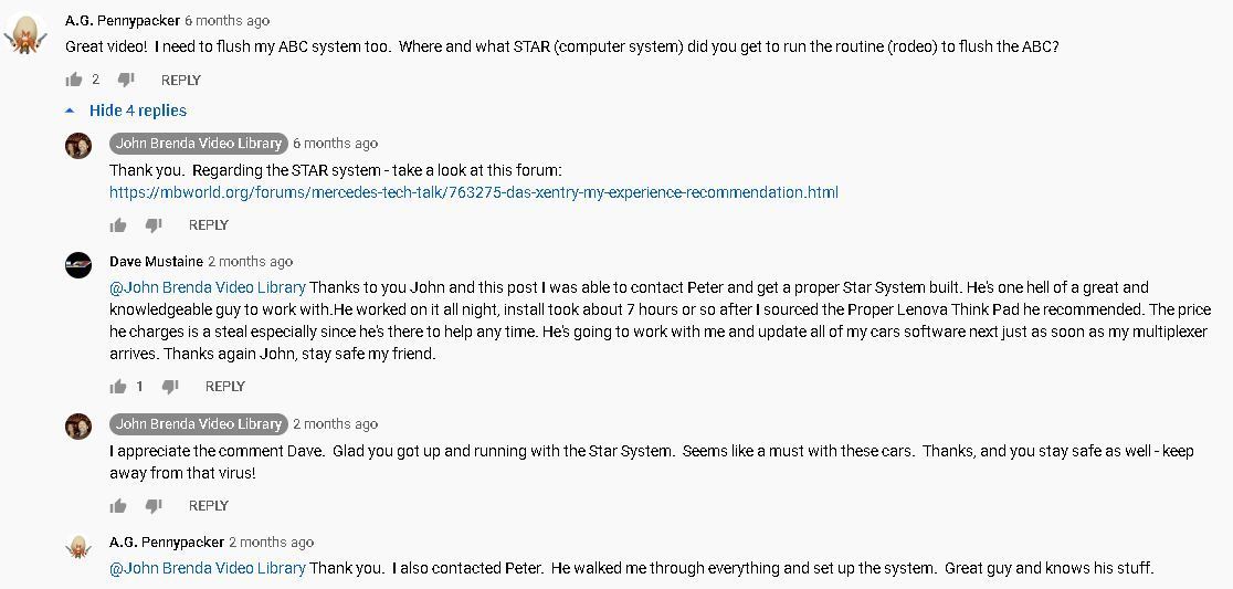

From what I've seen you can complete a flush using the AGA tool attached to the return in the fluid reservoir where the filter normally attaches. You install the tool and run the car through a rodeo. As the return fluid drains, you continuously fill with new fluid so that the pump doesn't run dry, until all fluid{or at least most of it} is replaced. I put a link to a video I saw on youtube of someone doing it on their 2012.
https://youtu.be/PC1vDOcw54M
look in the comments

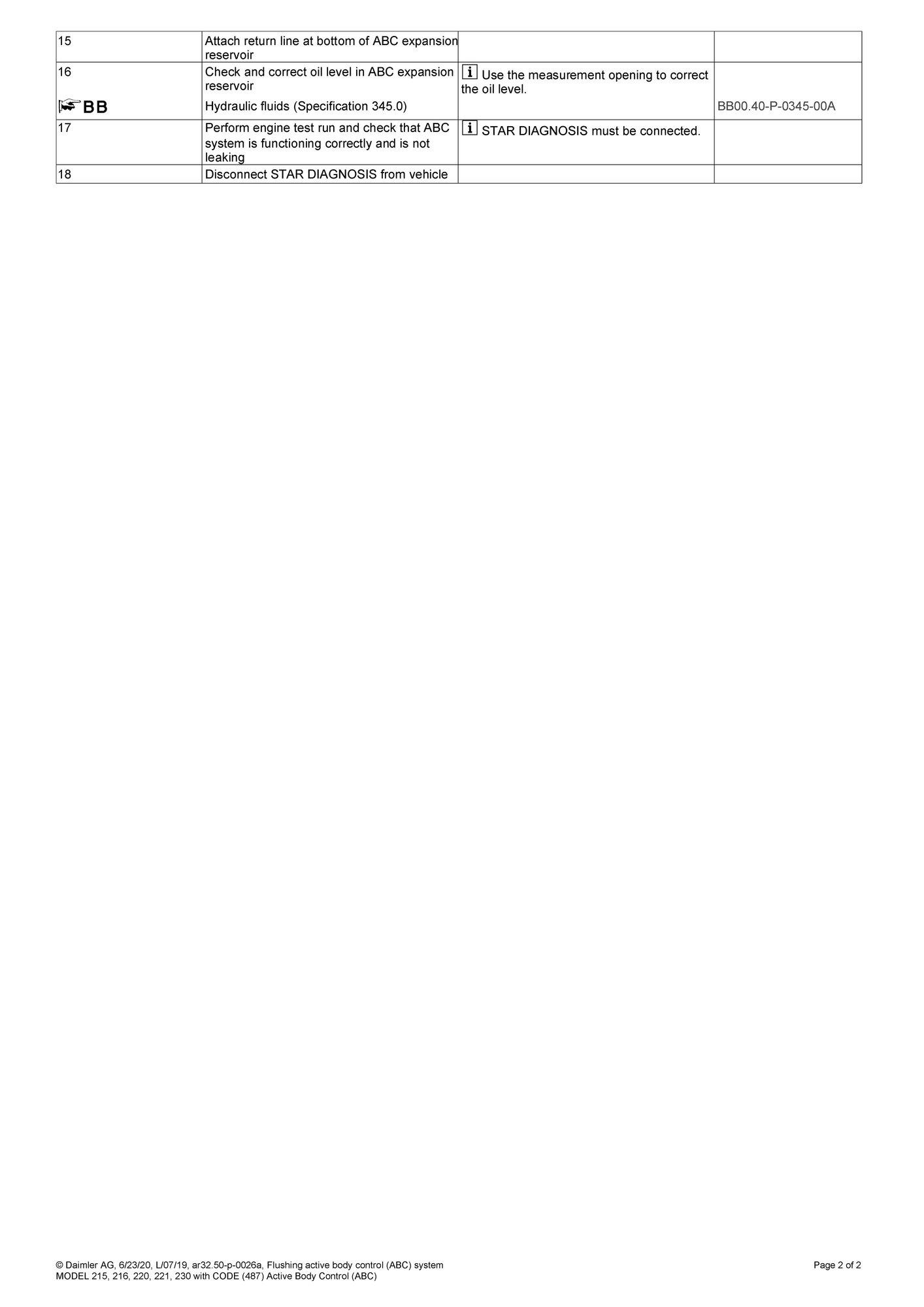

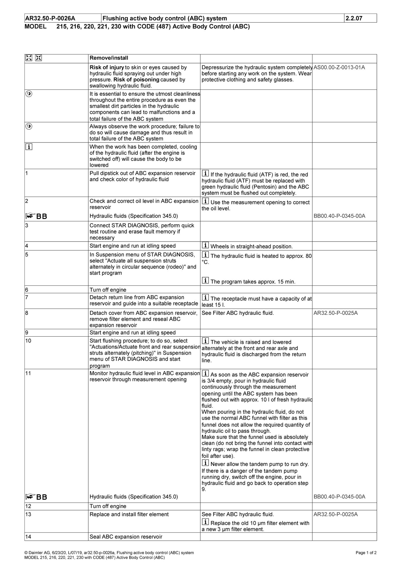

Rodeo Mode is used to warm the fluid up as a first step. To cycle the fluid, you need to activate the system via a Pitch Actuation:

Happy to help. On your W221 with the newer ABC setup (should be very similar to my R230), the following sequence can be used:
1. Connect Xentry and initiate Rodeo Mode to warm the system up (make sure it is inactivated once up to temp).
2. Remove the cap and filter assembly.
3. Manually extract all the fluid you can from the reservoir.
4. Refill the reservoir with clean fluid.
5. Manually extract from the reservoir a second time.
6. Insert the AGA tool into the reservoir and route the hose into a clean container.
7. Refill the reservoir with clean fluid.
8. Make sure all of your fluid containers are open and close by.
9. Start the engine.
10. Initiate the Pitch Actuation (it is what causes the system to circulate the fluid for the flush).
11. Monitor the fluid level in the reservoir like a hawk and steadily add fluid to keep the level up.
12. Once the fluid pumping into the container is clean (typically after 8-10L cycled through), stop the Pitch Actuation and turn off the engine (quickly).
After that you replace the filter and top off the level in the reservoir. You can also replace the filter a second time after driving around for a few days as an extra safeguard.
Super important that you clean the area around the reservoir very well before getting started (I used compressed air, a shop vac & rubbing alcohol) and keep the entire process as clean as possible.

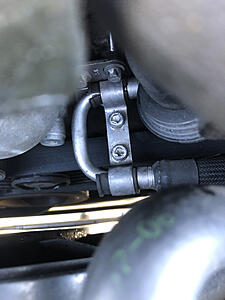

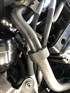

Sorry about hijacking this thread but my follow question is about ABC flush. I was under the car and noticed some wetness in one of ABC hose. View from top of the engine, one end connected to the tandem pump ABC flush @ MB dealer?-photo96.jpg View from bottom of the engine, it's the one in the center at 6 o'clock position ABC flush @ MB dealer?-photo396.jpg
It seems straight forward to replace but I know nothing about releasing the pressure and how to insert the hose replacement within the ABC flush process. Any advice? Thank you.

Nevermind. I found the hose. It's pump to front axle valve block so probably not under pressure.ABC flush @ MB dealer?-photo445.jpg
