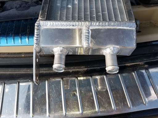

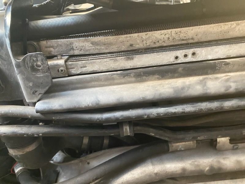

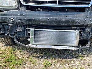

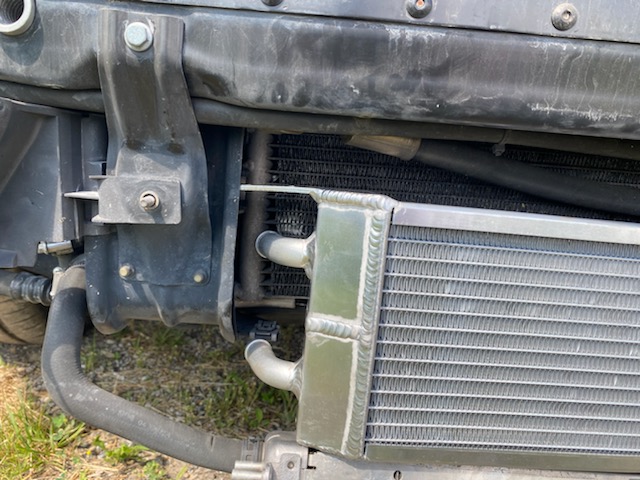

Having some issues fitting a Weistec secondary Heat Exchanger. Before I bought it, I confirmed with them that it would fit. Mounting it is no problem from what we can tell, we can re-mount the hydraulic ABC line. The issue is that the bends go right into the Primary HE... What am I missing? I did talk to Weistec but haven't revived any replies.. They don't offer phone support, only email.

Weistec was zero help. The list the S55 on their site as compatible, but there's no way.. I went through several options in my head: heating the pipe and bending it, cutting off the OEM spout from the stock HE and welding it on, cutting the bend off and re-welding. Decided to go with the latter. Took the HE to a very reputable welder in my area, and explained the situation. The results speak for themselves; im happy with it.. Seems like Weistec should have made it this way to begin with? Will follow up with some install pictures.

good work, just crazy that it didn't direct fit
aluminum welding is difficult but once you know how you can build anything
good luck

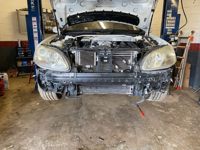

From what my guy told me, nothing has to be moved. The HE will mount directly to the bumper support and fit in the same spot as the oem HE. He mocked it up, and said there is plenty of room. The main issue was the bends hitting the primary HE.

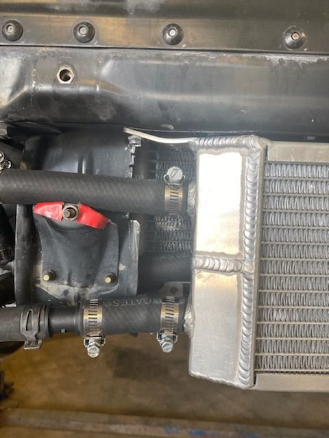

Got it all back together. The main issue was the ABC hydraulic lines which had to be moved in order to mount the HE to the bumper beam. This wasn't hard, just moving some brackets and hoses. While Weistec says this will fit the S55, it most certainly will not, without modification of the HE, and the car.

We did not have to move any other coolers, just a few lines/brackets for the lines. When we removed the OEM secondary HE, we took out all the mounting brackets & such that were with it. What was left is what you see in the picture with the car on the lift without the OEM HE installed, so it was plenty of room to mount the Weistec HE. Will wait to post anything about IATs until after I upgrade the pump. Going with a Pierburg CWA100-3 wired for ignition-on. I thought my Johnson CM30 would be enough, but there was no change in IATs.

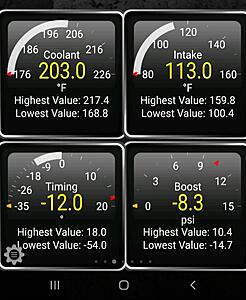

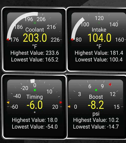

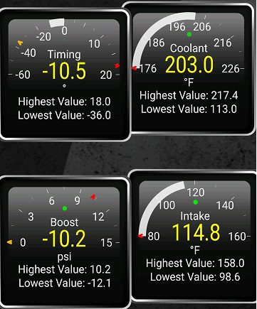

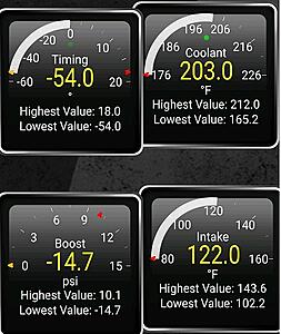

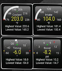

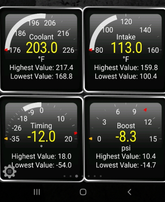

Update on this. It is going very well. Decided to upgrade the pump from a CM30 to a Pierburg CWA100 wired for ignition, and split the cooling. Temps actually increased once I split the cooling because I feel the pump was lacking. Temps were dangerously high on the track after multiple 20 minute sessions. Once we upgraded the pump, temps improved quite a bit.
