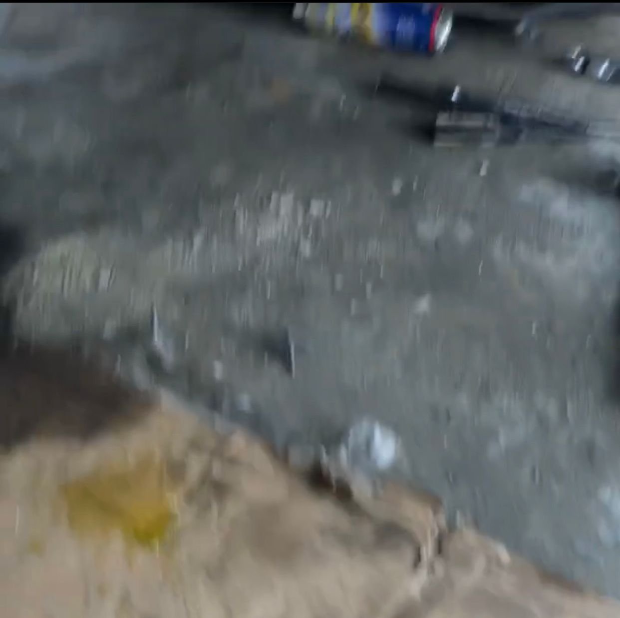

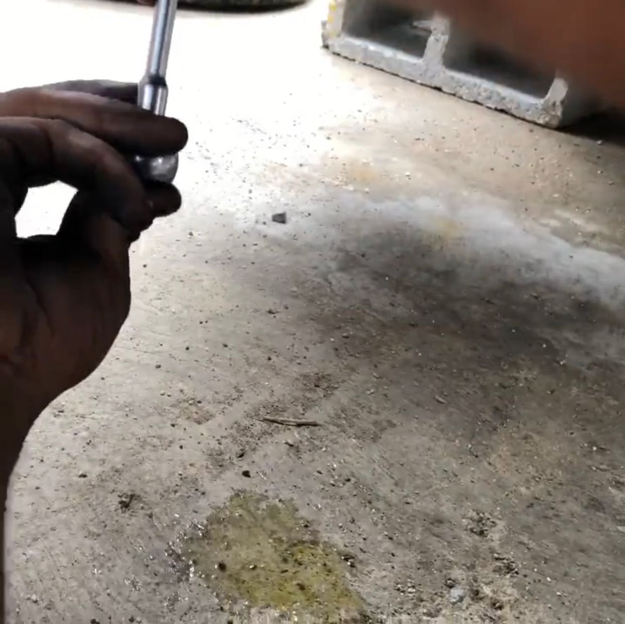

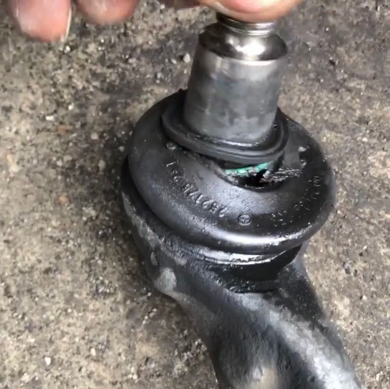

alright, so me and my dad took the car to a Mercedes Benz technician to get a ppi, the results were shocking. The car had a coolant leak and all the tie rods and bushings were shot. We came into the conclusion that the car had been hardly abused even tho the car only has 47k miles, so we decided not to buy it. We didn’t needed the car at the time so it’s ok to wait a little bit. We are now going to look for a newer s class probably an s550 or an s63 amg. Thank you so much for your help.
As you can see, totally shot
There you can see the coolant dripping out
