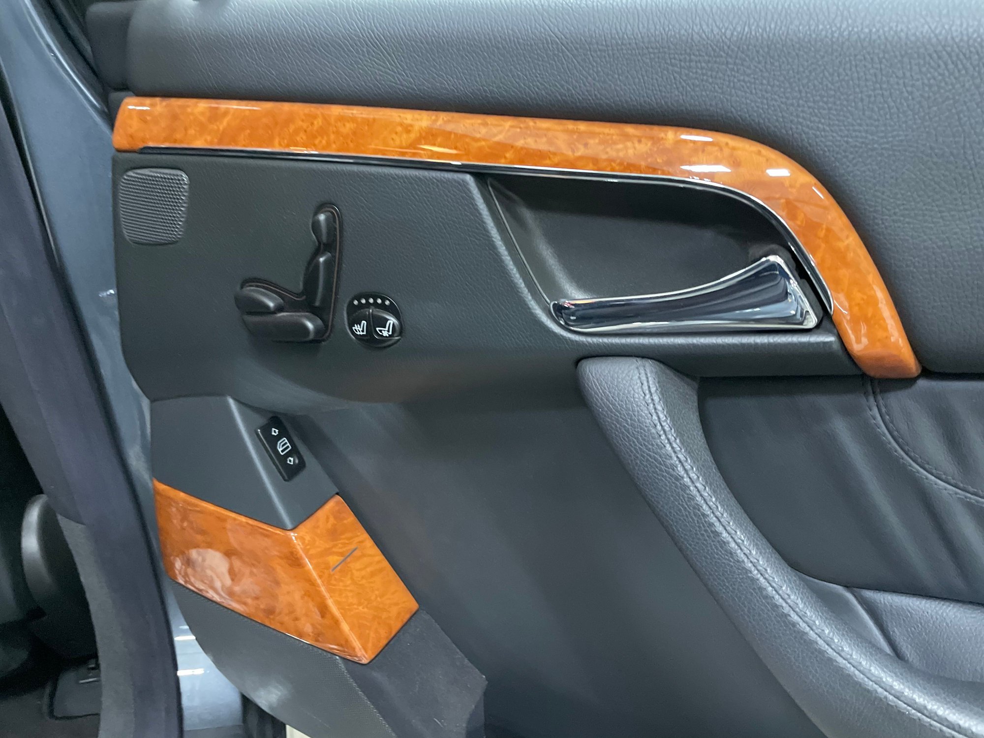

Understood... boy don't I know about those spare parts secrets... most of mine are stored with "the mechanics"... the "Parts Are Gone" issues at MB is my main concern, having lived with the 500E... I already sourced a complete Chestnut Wood interior because all of those wood bits are now NLA... but I have the attached to show for it...

Nice wood kit.

@GrepAwk Thanks... the door trim was stock but rare... looked a long time to find it in an S55... the rear power door covers were stock and rare too, but exclusive to S600/65... and long NLA ... so tracking those down took a bit... benefit of parts hoarding.
