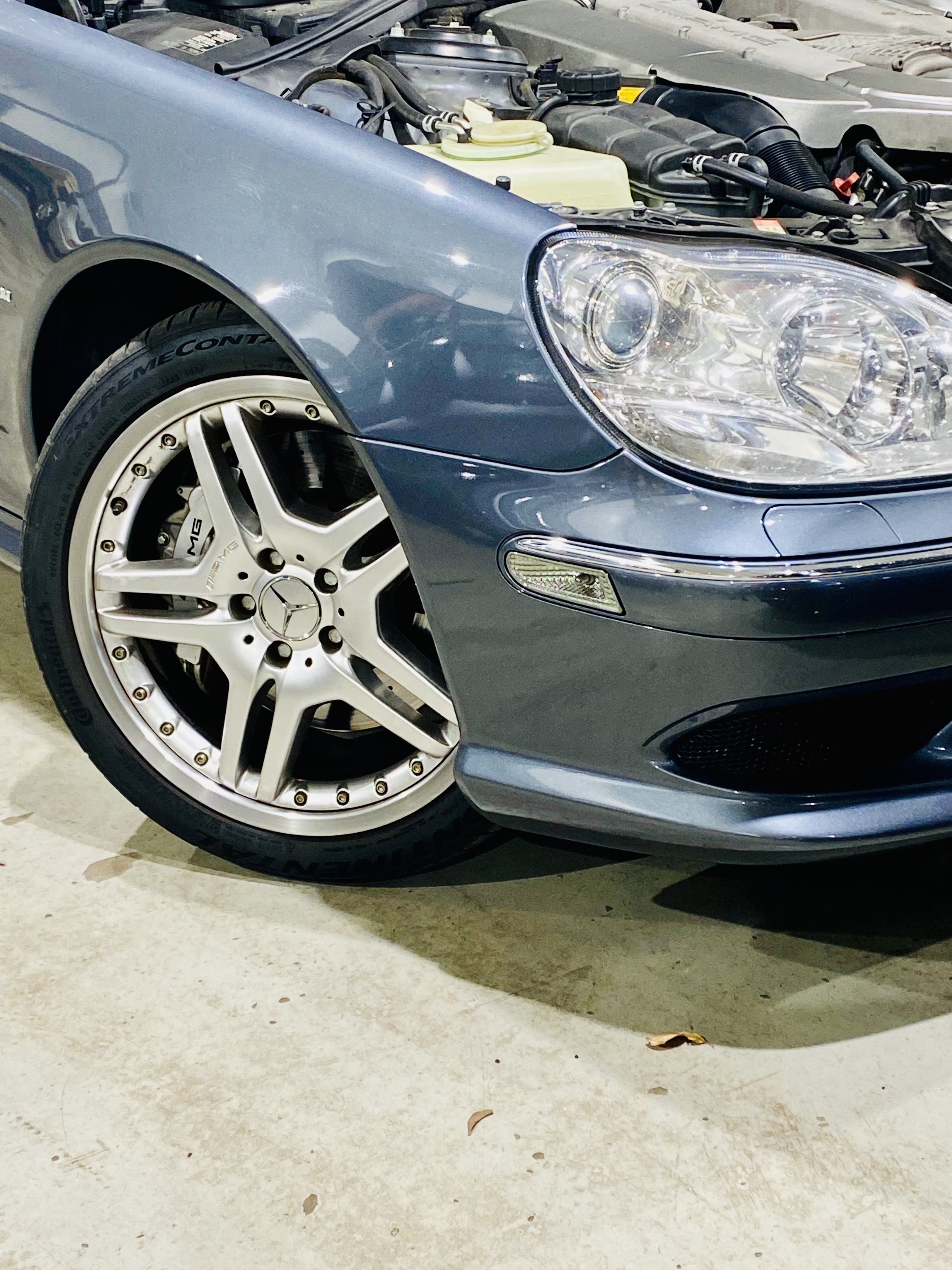

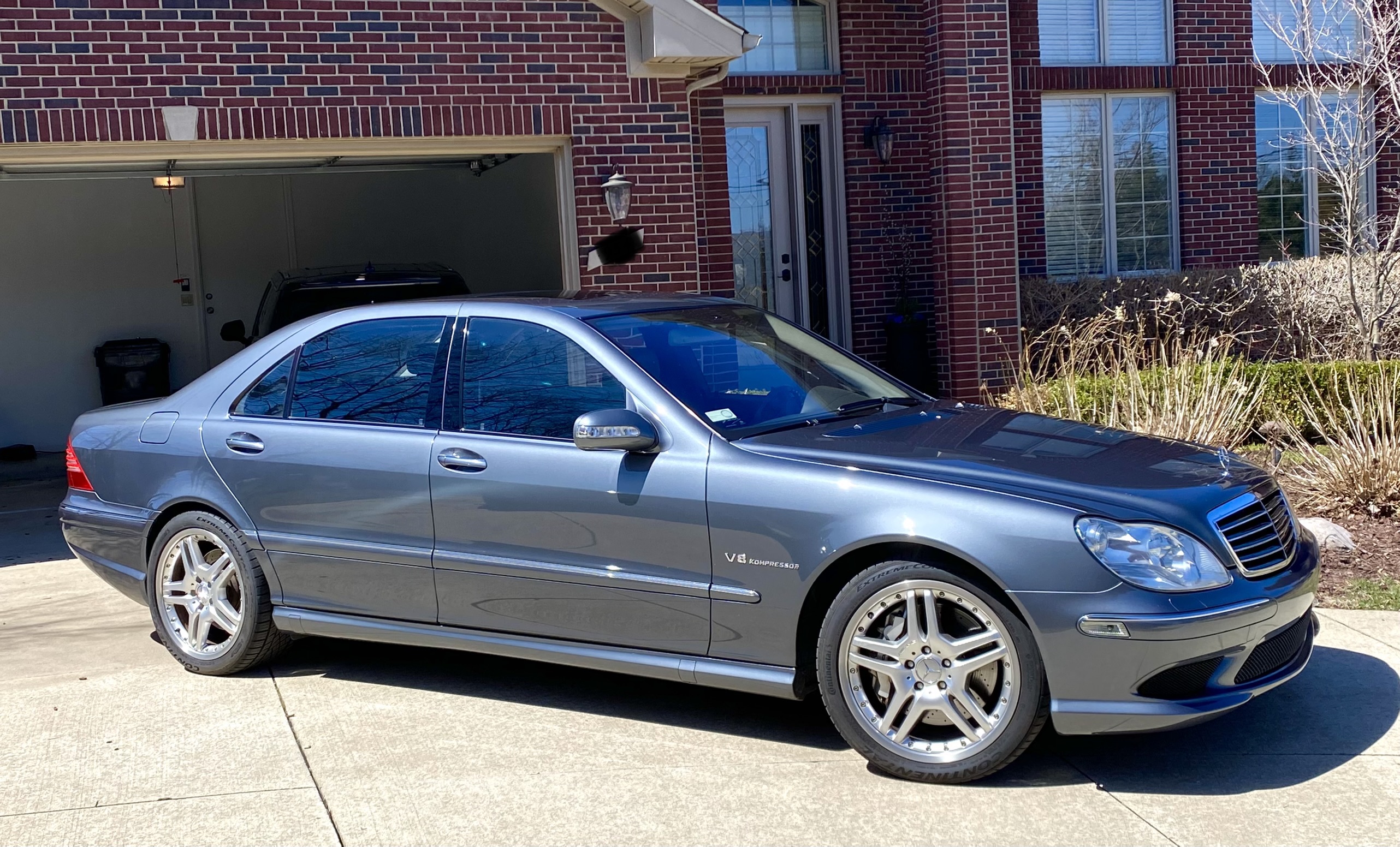

I’m unaware of my chart but it’s been discussed at length. 248/285 on 19” is fine and feels stock-ish but with better grip once you dial in tire pressures to your liking. I’ve run this combo on the stock 19” 2-piece AMG wheels for years and the car just feels more planted. Sure the tires are heavier but the car has plenty of power, so it’s not like an E46M car where you’re worried about weight savings everywhere because the engine has no torque. Unfortunately those wheels are now NLA so you’re in for a hunt, likely refinishing and repair(ed) and welded wheels of various qualities. If I have pics I’ll add them below.
