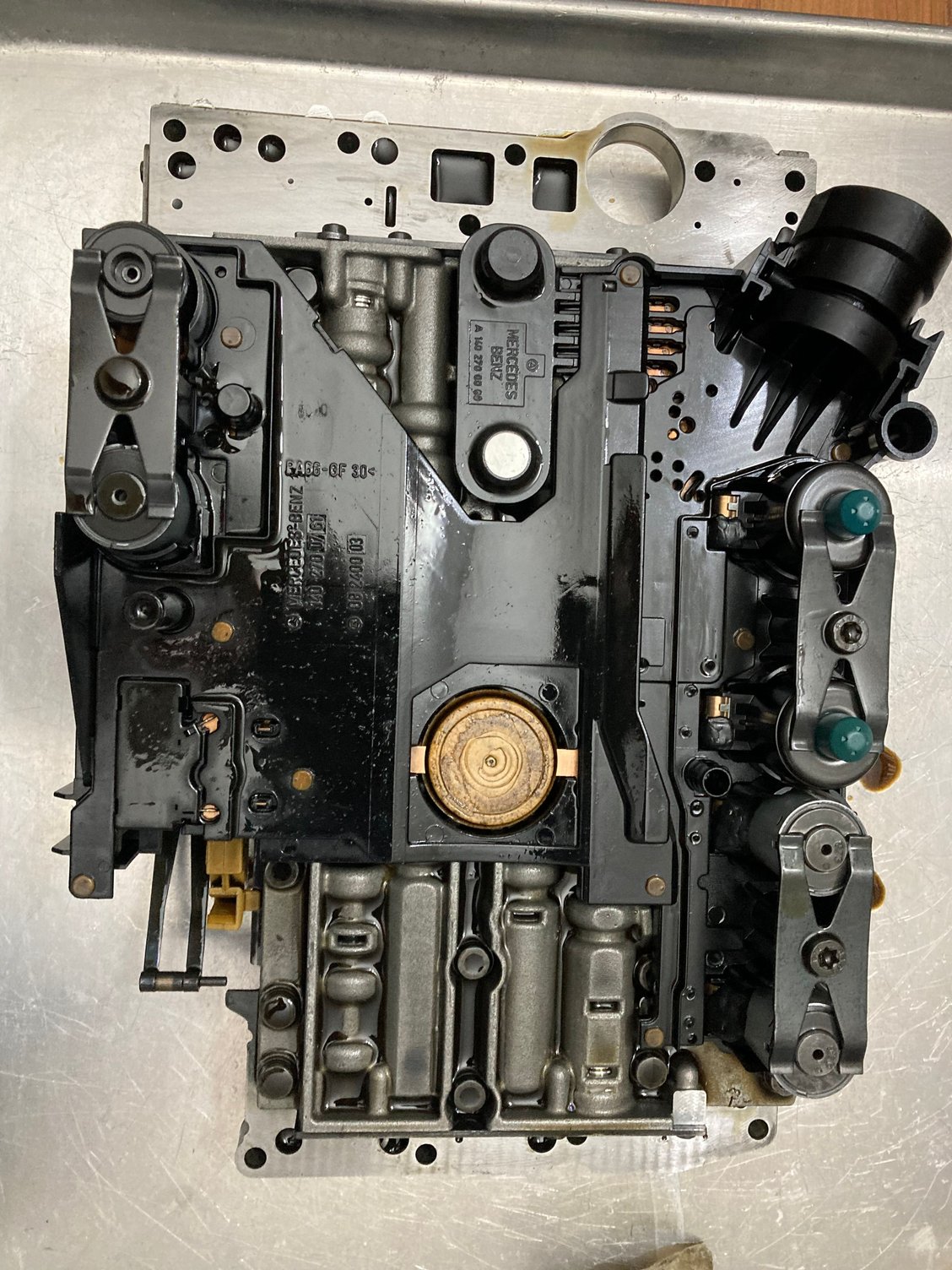

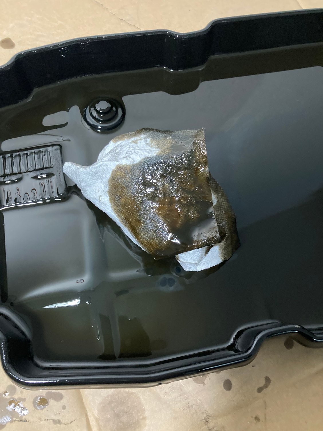

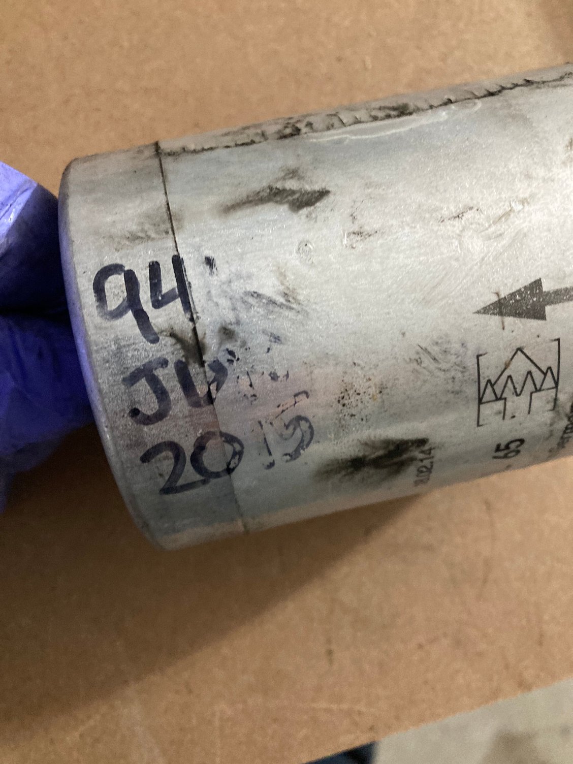

A little update on the car....
It's been on jack stands for a month undergoing mass maintenance as I have time. So far this is my list of what's done and what's remaining. I'm eager to drive the car so I hope to wrap this up today.
-New brake pads/rotors all the way around, including stainless brake hoses and flush
-Fresh oil change, resealed breathers and changed gaskets, changed oil cooler/filer housing seals. Finishing up the breather hoses today when I have patience to fight the driver's side
-Motor mounts & trans mount
-New air filters
-New battery
-New tires
-Plug/wires
-Crank sensor
-New drive belt & tensioner, new SC belt
-New pulsation damper
-New conductor plate, connector & filter, performing flush later today
Still have to flush the ABC system and will probably change the fuel filter today. Also have the SC oil to change.
This car has been another one of those cases of getting what you pay for. However, at least I know everything will be current and done to my expectations.
