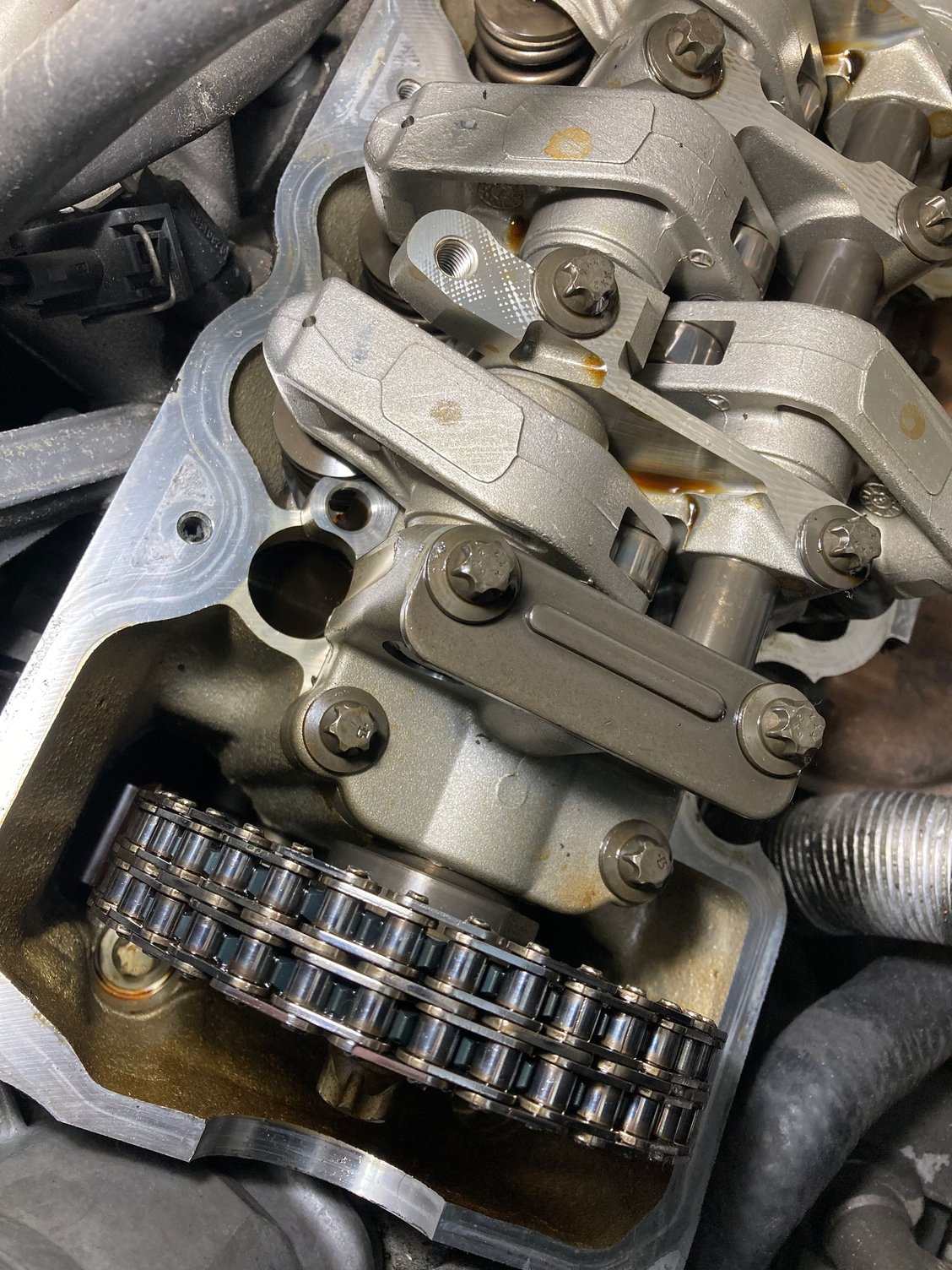

I second that. I’m doing a lot of maintenance on mine right now and this is 140k
Looks clean.

Originally Posted by paste
Looks clean.
So will yours, is my belief until proven otherwise. Mine looked the same. I deleted the pics but they may be on this site somewhere.
