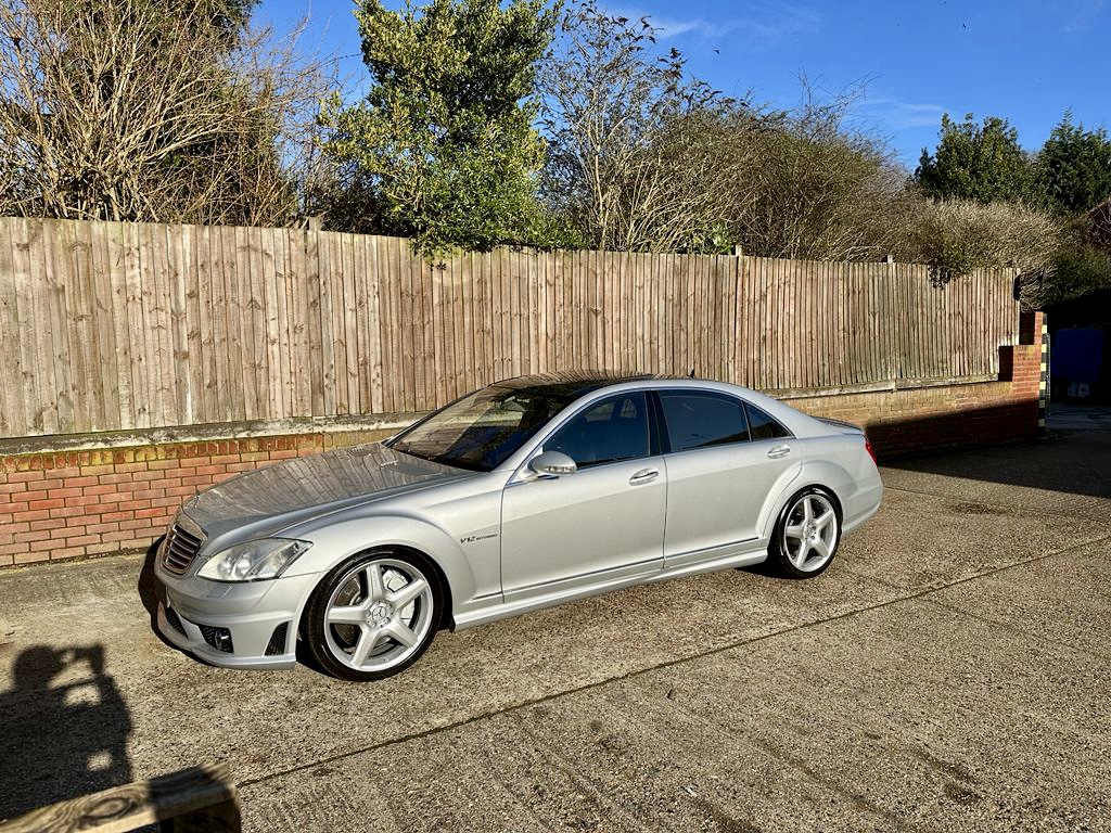

Hello everyone,
A few months ago I decided to sell my e92 M3 CP as I wasn't using it much. I loved the car but I barely done any miles.
To replace the M3, I decided to go for an S65AMG. It's a pre facelift model and I wanted to do a facelift conversion just like I did on my last one but it has been very hard to find anyone in the UK that sells the facelift AMG bumpers for this model S class and after nearly 3 months of searching I haven't found anyone in the UK that sells them.
I have decided to leave the car as it and just make a few small changes.
So far, I have
Lowered the car
Fit spacers all around
Facelift rear lights
Boot lid spoiler
LED number plate lights
Here are some pic's of the car.

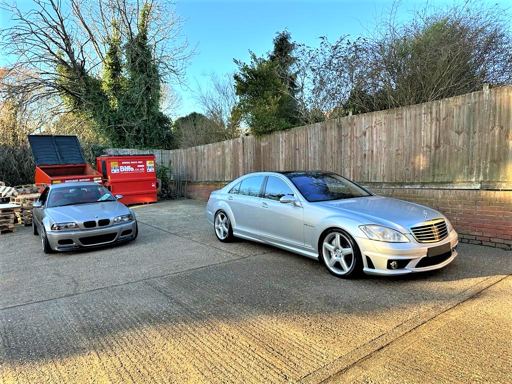

My old S600 with the Facelift AMG kit, lowered and on 21's
This is what the S65AMG replaced. e92 M3 CP

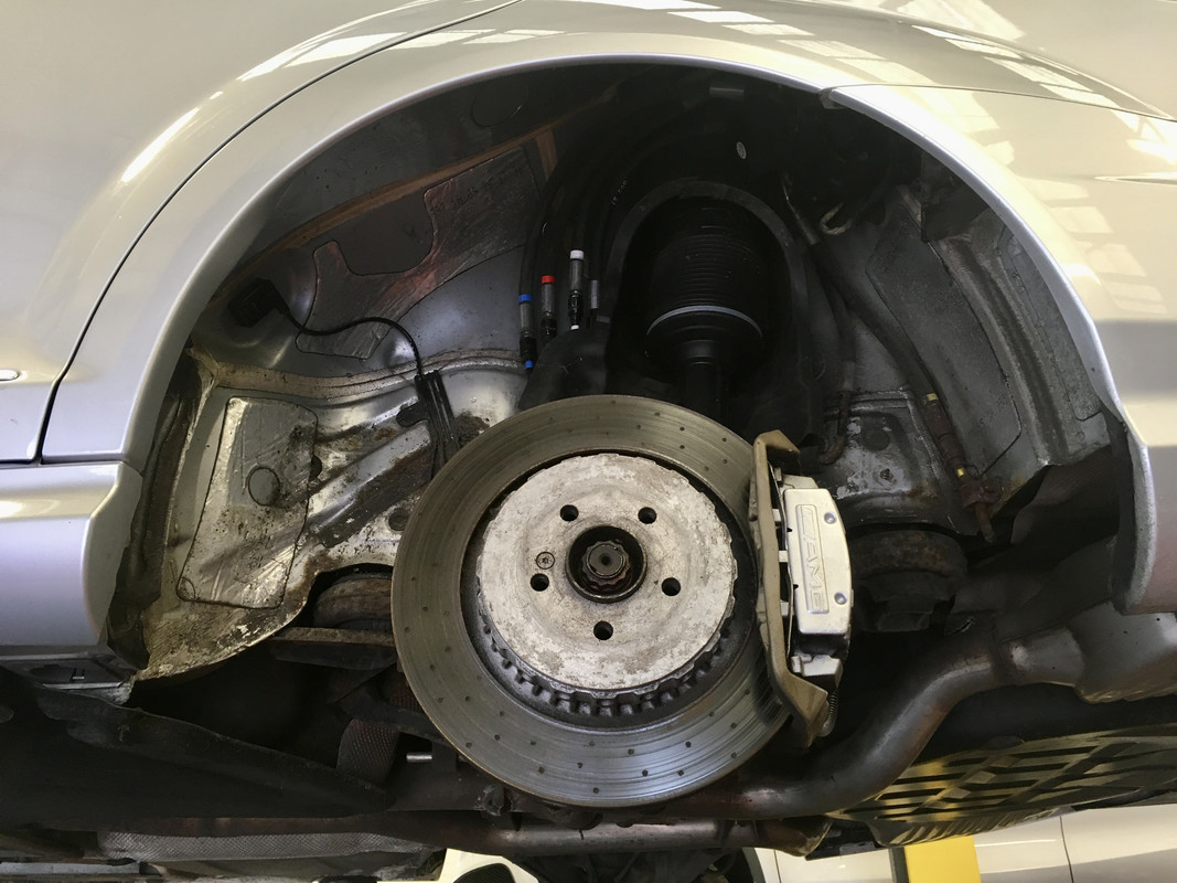

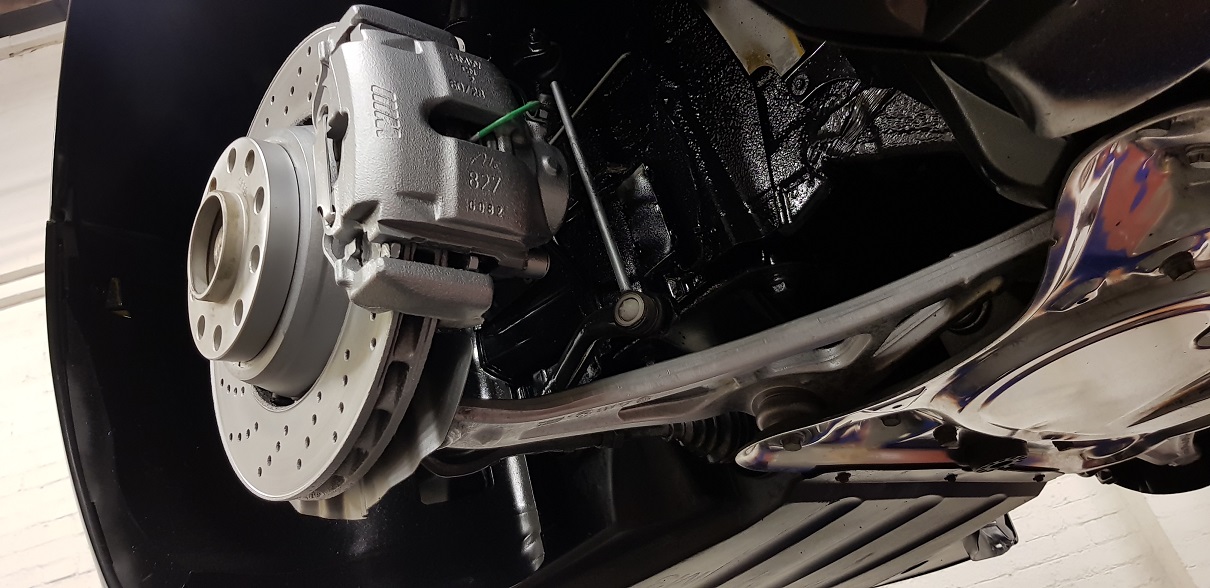

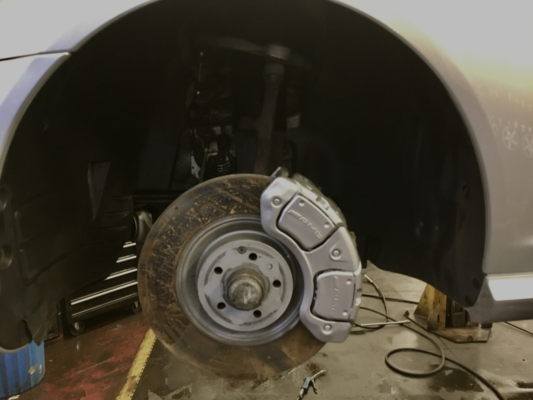

Yesterday I spent all day taking all the under trays and inner wheel arches off to clean the underside of the car. I started at around 11am and I was cleaning until 10pm.
No painting has been done yet and I will only do some minor touch up, paint the brakes and maybe a couple of other things. I don’t want to go too far with the underside this time
forum pictures url
All the under trays put back.... I'll take some better pic's once the brakes are painted

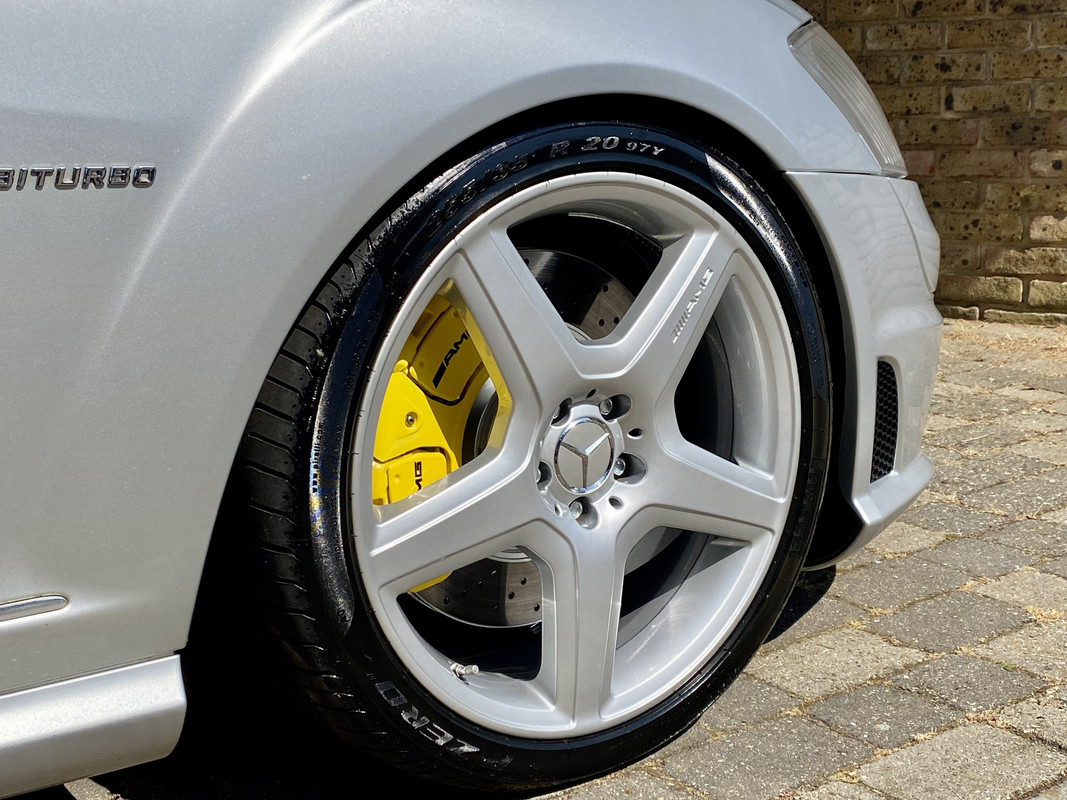

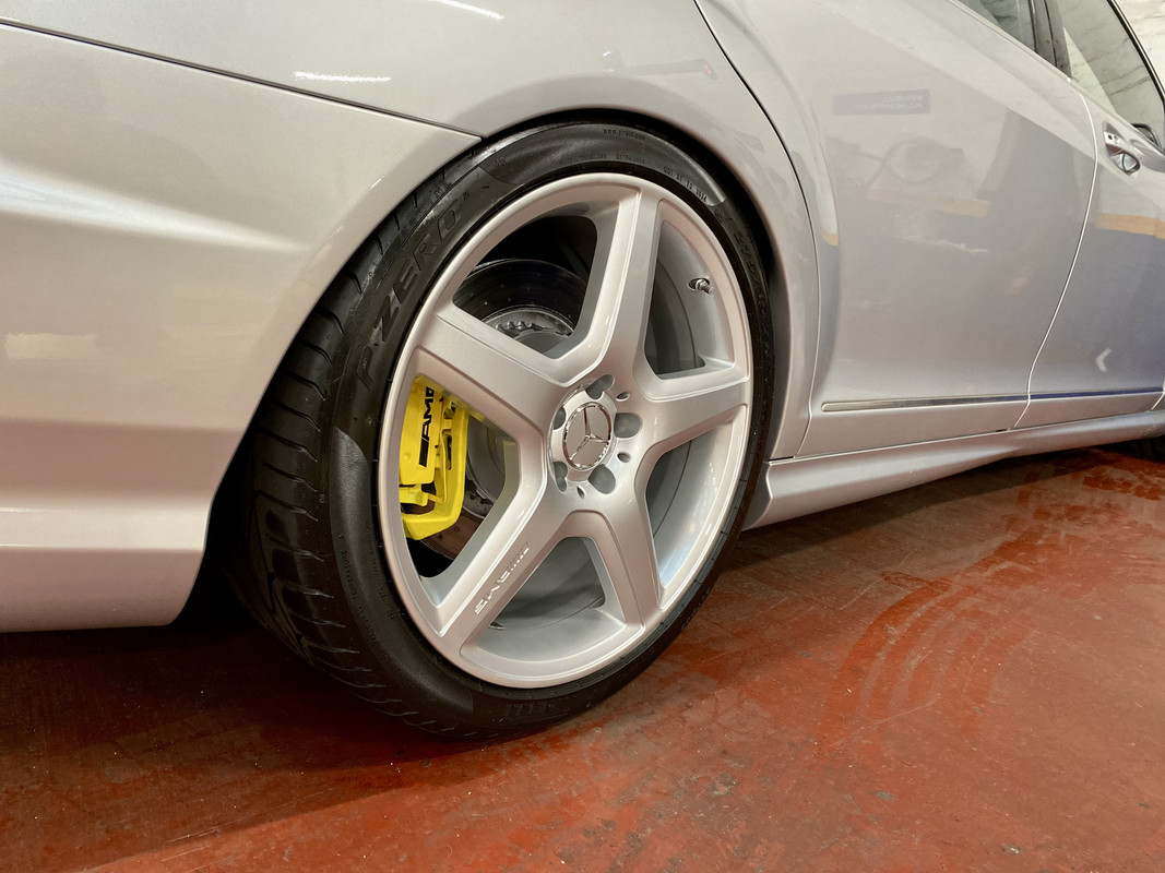

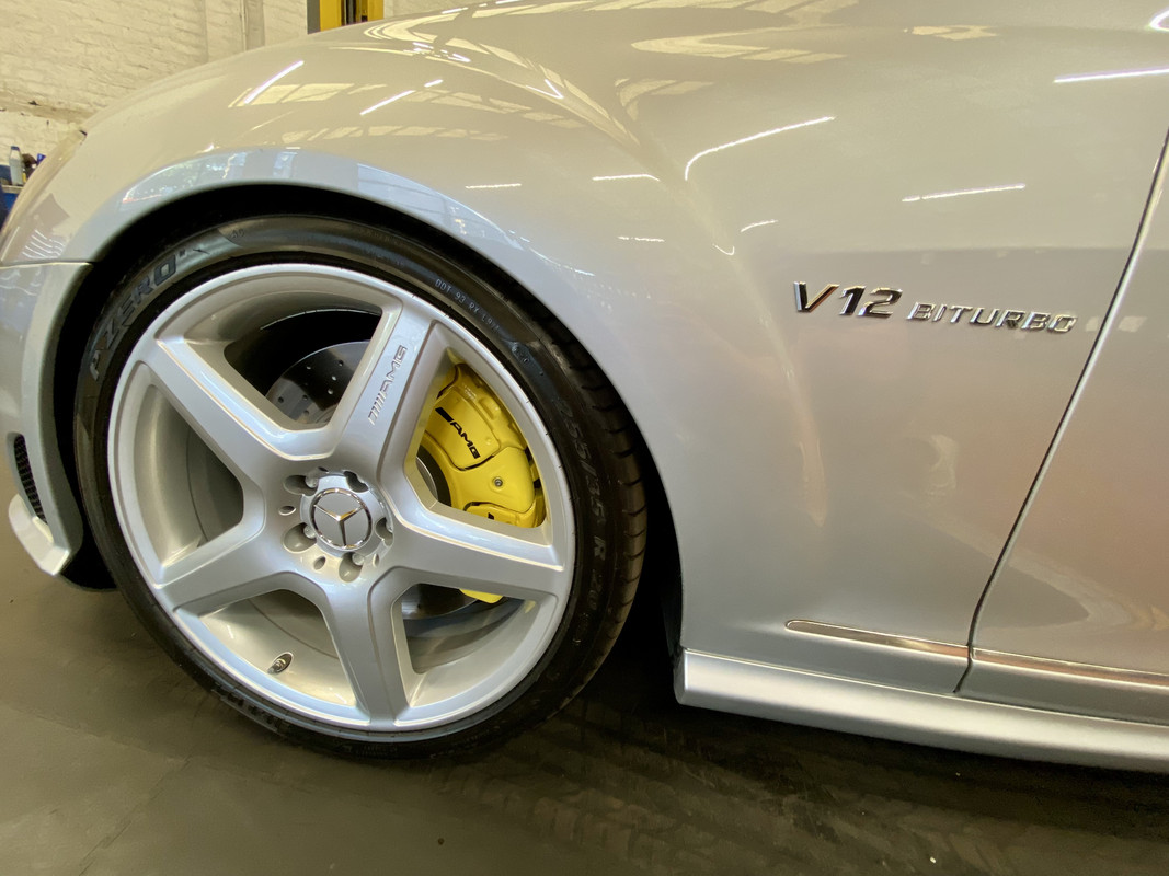

I’ve painted the brakes on both cars and here are the results,
I wanted to do a half decent job on the cars so I went to the paint shop and asked for some advise on what I needed to buy to good results.
I should have just done them like I normally do, just paint them silver and not go ott with it like I did this time but I thought i'd be brave and try something different.
I bought,
X3 primers
X3 white paint
X3 yellow paint
X2 silver paint
X3 lacquer
X1 black paint
It has been such a headache of a job as it took soooo long to strip and prep them. All the masking, painting and waiting for the paint to dry to use the other paints to finally have yellow calipers
I got told after using primer, I had to paint the calipers white and then yellow otherwise the yellow paint would look greenish.
Striping the paint off all the brake calipers, caliper carriers, sanding down and stripping the paint off the covers seemed like it took ages to do.
I spent 3 full days on each car just for the brakes alone. Either I’m slow or it really was a long job!
Here are some pics

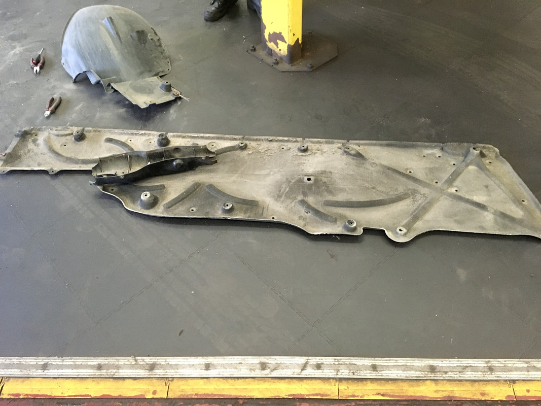

I have been driving the cars on nice days and one Sunday I decided to take the S65AMG to a car meet that was nearly two hours away but by the time we turned up, the show had ended It was still a nice day to go out with the wife for a long drive so it wasn’t a wasted day after all, we still had fun apart from wasting nearly £50 on tickets we never used
Here are some pic's I managed to take once we arrived and 95% of people had left

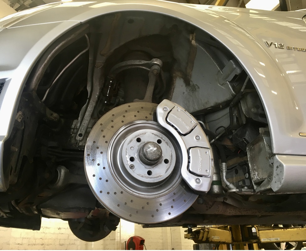

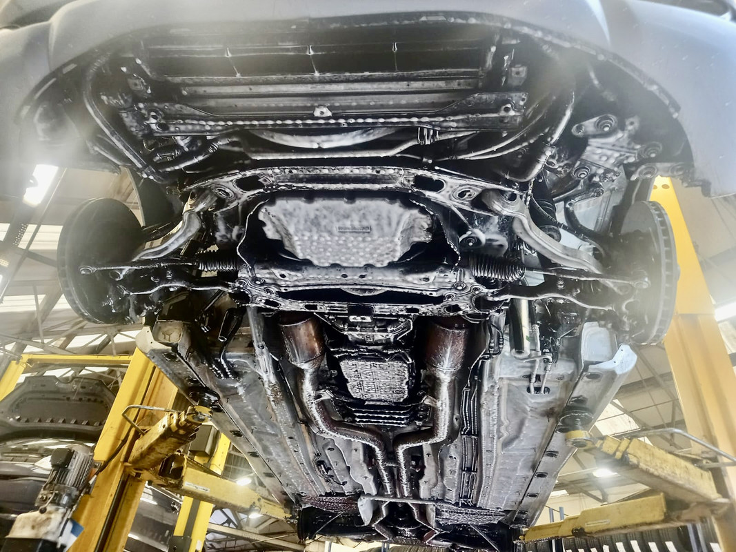

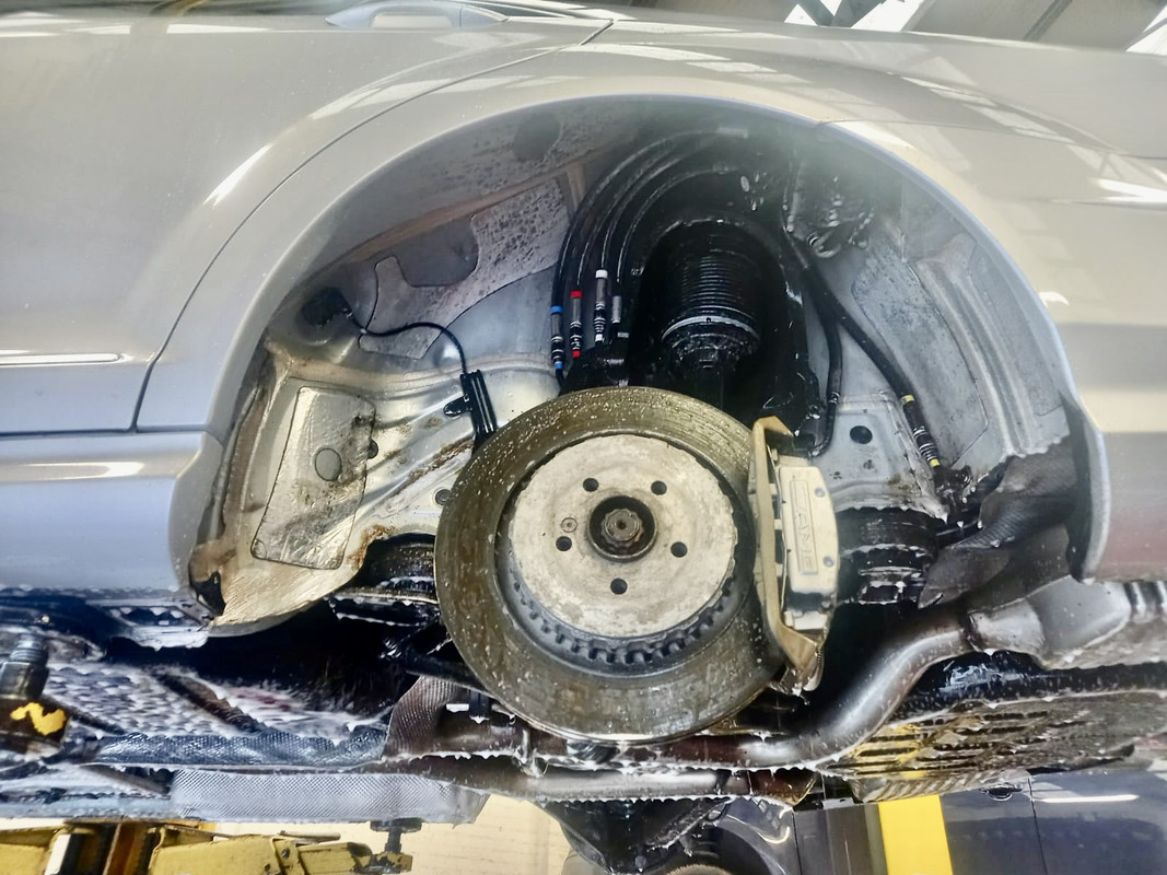

The S65AMG started making some weird noise at random times, like a whining sort of sound that was louder inside the car. I couldn’t figure it out where this noise was coming from. Sometimes I thought it was coming from the engine bay but when I’d open the bonnet, I couldn’t hear anything and other times I thought it was coming from the rear of the car.
One day I put my ear next to the drivers wing and I could hear the sound very loud so I thought something had gone faulty inside the front wheel arch, some sort of a motor that I didn’t know was there but before I started taking the inner arch liner off I put my ear on the other wing and it sounded exactly the same! I was a bit confused.
I put the car up on the ramp and removed all the under trays and I was trying to figure out where this noise was coming from. After some time I realised that the noise was coming from the auxiliary water pump.
I ordered a new one from Mercedes..... While I was at Mercedes, I ordered an AC condenser as it had a leak on the S65.
The AC condenser was £800+ …. It took a month for the condenser to arrive from Mercedes in Germany
I also bought a genuine belt for the alternator and new pulleys.
A few months before that I bought new engine mounts and gear box mount from the dealer for both S classes as the V12 and the V8 like to destroy them due to the amount of torque this engines produce. I knew on the S63AMG they definitely needed doing but on the S65AMG they didn’t seem as bad. I still wanted to change them on both cars as I didn't know if they had ever been changed before.
I called my good friend that helps me out on the cars and to be honest, he’s the only person I trust to work on any of my cars. He helped me change the engine mounts on my old S600 as well and with that in mind we thought the S65AMG would be the same as in the S600 but there was some small differences..... nothing to big.
I should have taken some pics while changing them as it might help someone with a V12 if they wanted to give it a go.
The S65AMG is such a simple car to work on…….. who doesn’t like working on V12’s………… right!!!
To remove the AC condenser, you have to remove a million bolts, a few radiators and the whole front end just to get to it!
I did say it’s a simple car to work on didn’t I
Once the ac condenser was done plus the alternator belt and the tensioners, we concentrated on changing the auxiliary water pump. We left the easiest job for last……….. well, we thought it would be easy but of course that’s never the case!
After changing the pump, we had to bleed the system but after trying for ages, we couldn’t get the water to circulate. It was nearly midnight so we left it there and decided to finish the car off the next day.
We pulled the car out in the morning and tried to flush the radiator as we thought that might be blocked. It was blocked but not too bad as we managed to unblock it but we still couldn’t get coolant to circulate. This is what came out of the radiator
We also removed the intercoolers as we thought it’s best to make sure they are not blocked. The intercoolers were not blocked but the one of the passenger side, we noticed the pipe was slightly bent which might restrict the flow. We fixed that.
While doing all this work we wanted to make sure that every pipe or anything else that had to do with the cooling of the turbos was not blocked or damaged.
There are two pipes that run under the coil packs. Could they also be blocked?
Of course they would be!
Drivers side was unblocked successfully but the passenger side wasn’t having it. After using a metal wire and trying to flush it, we finally saw water come out but not from the other end of the pipe.
The water was coming out under the coil packs. We thought we damaged the pipe when putting it under pressure.
To get to the pipe, you have to remove basically everything that’s on top of the engine including the coil packs.
Once removed, after looking at the pipe, I thought it was just blocked but I also noticed a tiny little hole and that’s where the water we saw was coming out from. I was trying to figure out how to maybe repair that small hole as I was inspecting the pipe.
Off I went to Mercedes to order a new pipe but seeing as the faulty pipe had corrosion, the other side must have had corrosion too even though we managed to unblock it so I thought it’s best I order both of them.
This was the good pipe
As always, every time I order anything for this cars, I have to wait ages for the parts to arrive as it seems like they come from Mercedes in Germany. After waiting a few weeks, the pipes finally got here in the UK.

Looking at the condition of the metal pipes, we wanted to remove any pipes, hoses that had to do with the coolant system and make sure everything was cleaned.
Just look what came out from this pipes!
While I was waiting for the pipes to arrive and the car was in pieces, I thought I might as well order the ABC filter for both cars and new ABC fluid as that was another job I wanted to get done to the cars.
I ordered 20 litres of ABC fluid. I wanted to flush the system on both cars properly. If I’m not mistaken, the system has 5l of fluid.
The new coolant pipes were fitted and we started to put the car back together.
Once everything was on, there was more fun to be had……. Bleed the complicated system that Mercedes had designed for this car!
After getting all the air out, I took the car for a spin to make sure everything was good.
