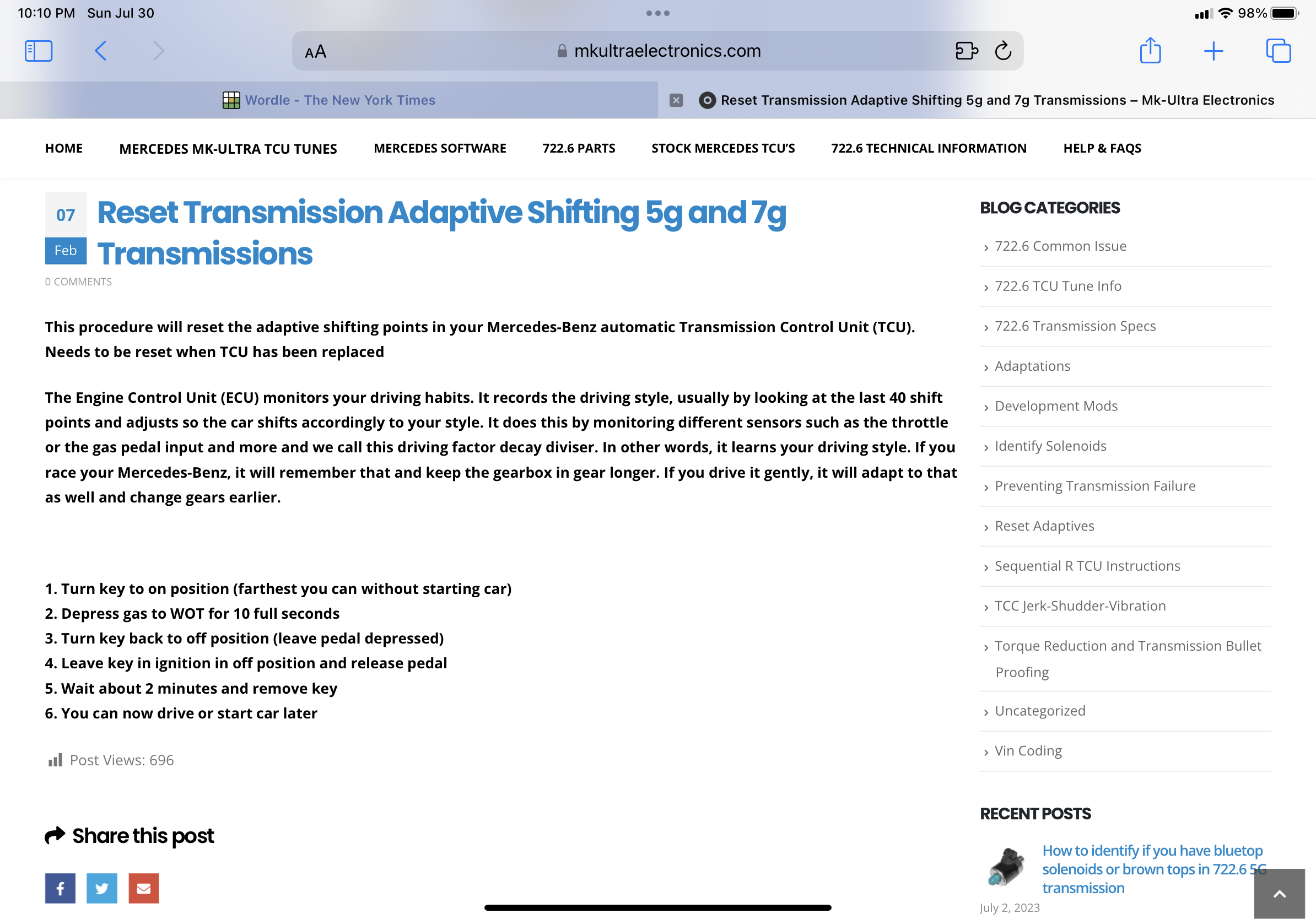

I noticed the car kind of jerks sometimes when im accelerating for a slow speed. It does this a lot. It has all of its power and the idle is super smooth. Im getting all the fluids flushed out on Friday but do you think this might be the trans fluid. No issue with gear changes at all. Every once in a while i might get a crazy jolt and it throw me back in my seat upon initial take off from a light. I suspect old transmission fluid in there especially since the previous owner sent me off with a new trans filter and fluid.
There’s a TCU reset procedure I’ll send you tomorrow when I’m at a computer if no one beats me to it. Usually clears that up. Part of the learning curve — car learning you and vice versa.
maw
EDIT… try the attached for now.
