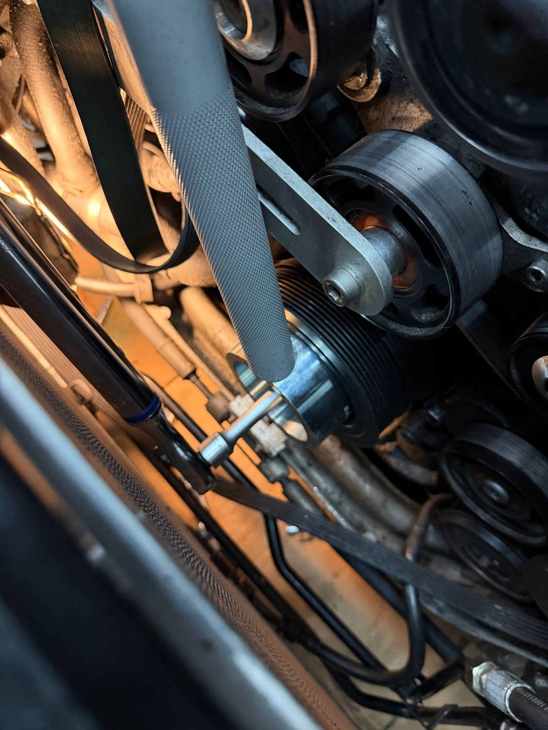

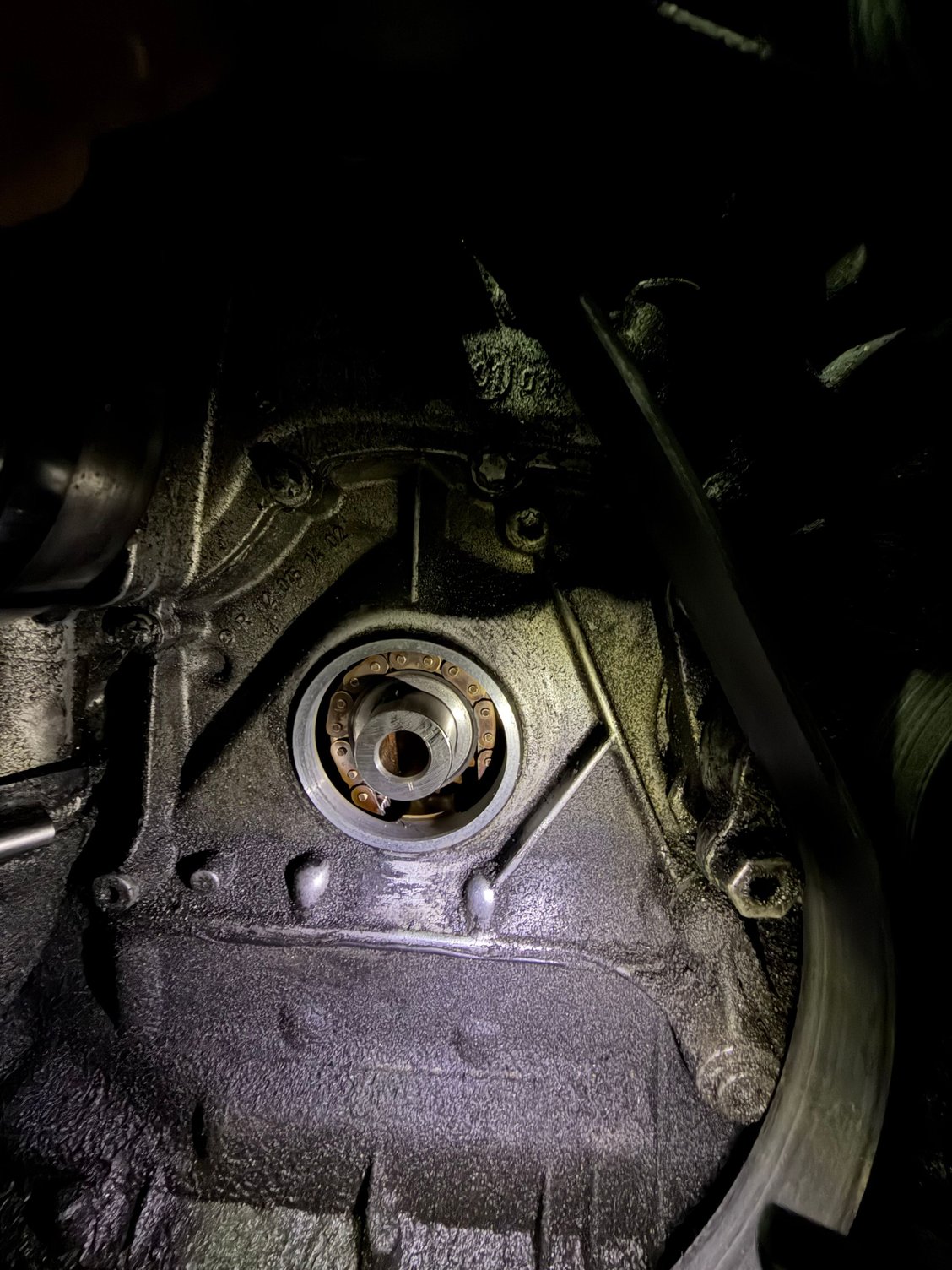

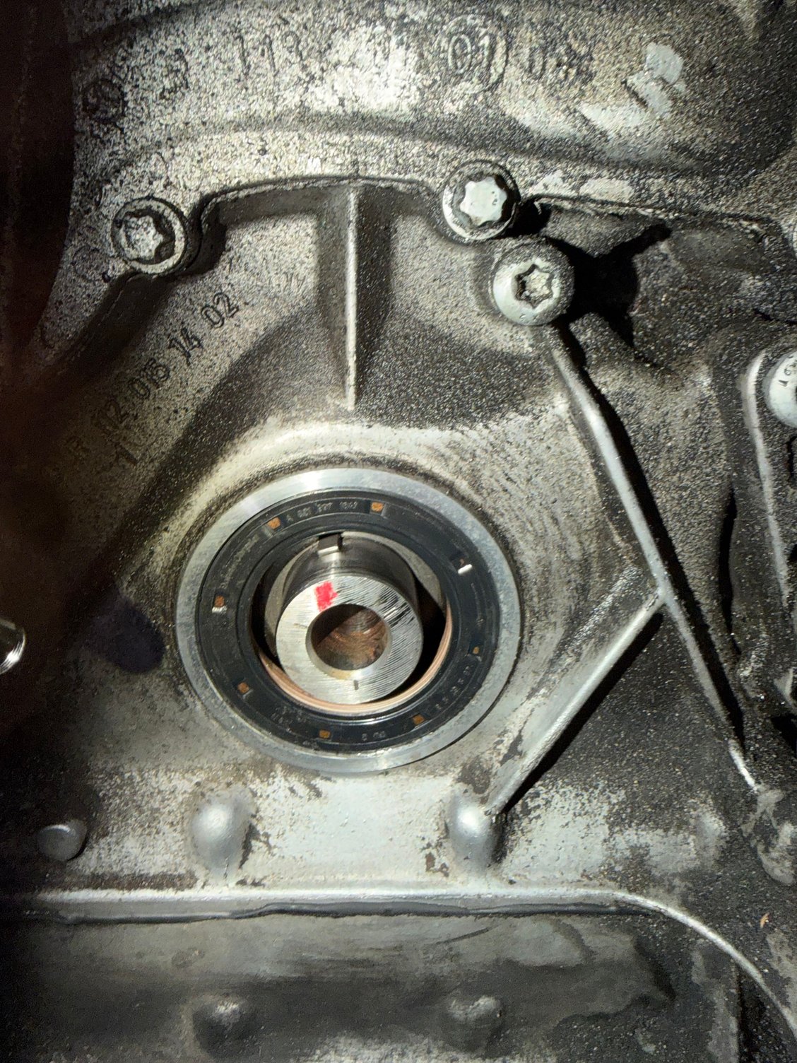

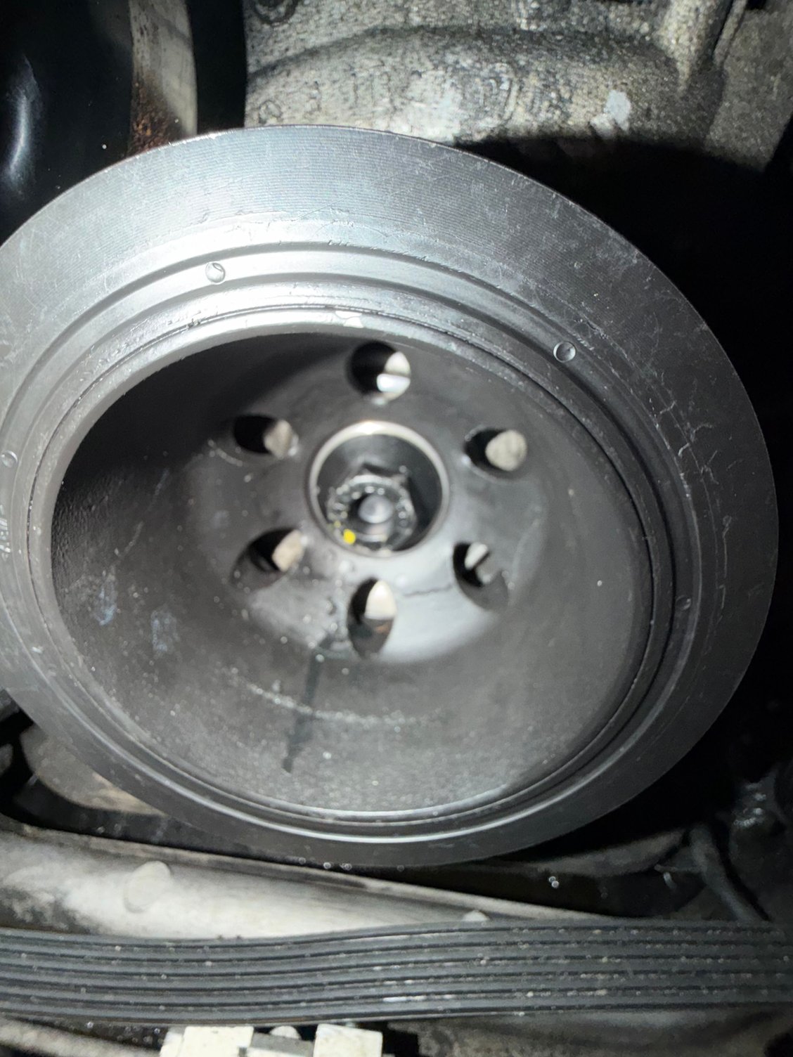

Tough week for the S55. Pulled it out of storage last weekend to give it a bath and the driver rear window regulator went out. Drove it around for the weekend and while heading back to storage i put my foot to the floor and ran through 3 gears, music up and enjoying a nice warm day. I get to the light and hear some kind of metal clanking noise, turn the radio down and it sounds like something is wacking or caught in the fan. Pull into a parking lot, turn it off, pop the hood and realize my Crank pulley decided it had enough and blew apart
On the other hand, I took some time before all of this and rebuilt the front ABC Valve block. Unfortunately the car is still dropping down and loosing pressure somewhere in the system. It seems to be more pronounced on the driver side then the passenger side. Not sure if its the struts or if possibly its leaking through the pump and i'm not sure exactly how to diagnose either. There are some S600 Shocks on Marketplace by me for sale that if i can get a deal on i may try swapping for the hell of it. I've been giving my C63 more attention recently as I want that car done before the end of Fall or before we hit dead winter here in the NE. The car is still sitting too low in the front, so i may try to readjust the front links to bring it up higher on its highest setting. I've never done a rodeo or a re-calibration so maybe i'll give that a go as well.
Regarding the Crank pulley, i was thinking about buying a VRP modular pulley but I've heard they cause a decent amount of vibration, and they're also $1400 dollars. I think i'm just going OEM brand new from the factory and it looks like they're around $450-500 for a new one with the Bolt. I really don't feel like spending another $200 or so on a crank pulley tool so if i cant find one cheap i'm just going to rig something up to get it off/on.
Possibly over the winter I'm thinking about ripping it apart and installing the 550cc Injectors i bought for it, replace the supercharger oil and throw on that 83mm pulley Dave gave me with a proper tune. If I can get the outside of the car squared away by next spring/summer that would be great. I'm looking at pulling both bumpers and having them repaired/resprayed, some small additions around the edges like a nice front lip and a rear window spoiler, and have a proper paint-less dent repair specialist come out and pop out some dings around the car. All of that along with the set of HRE's i have for it would really make me happy and the outside of the car would basically be done. I may pick up a pair of rear quarter windows that haven't been Delaminated and maybe re-tint the entire car. Who knows we'll see. If i saw more of these out on the road i probably would have sold it by now quite honestly, but i swear to God every single time i drive the car I get a thumbs up by some random person on the road, a compliment, or someone coming up to talk to me about it while i'm pumping gas. Every. Single. Time. I don't know what it is but it makes me enjoy it that much more. If only they knew the pain i go through with this thing! LOL
- Joe

No fancy tools needed to get the crank pulley off. If you don’t have a burly 1/2” drive air gun hold the torque converter with a pry bar and loosen with a breaker bar. Slides right off.
ABC drops? For it to be a strut it has to be peeing on the floor when parked. Valve block most likely culprit. Give it a rodeo. Always good practice.

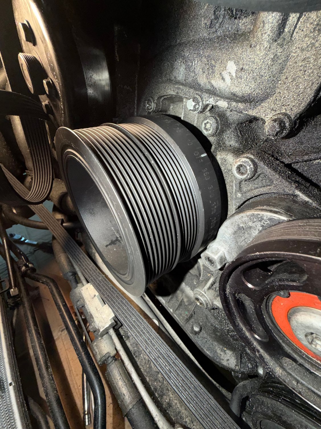

Positive Update:
Over the last week i had some time to spend on the car. It's been on ramps and jacks since last September when i blew apart the crank pulley. FB Marketplace came through once again and patience is always your friend if you have the space and time. Found a brand new OEM pulley for $150 and the tool for another $150. All in for Parts at $300 isn't too bad. Last week i dove in and tore it apart. Pulled all of the plastics underneath, all of the cooler lines off of the fan shroud (What a PITA), pulled the fan and made some room for tools. I will say a proper video borescope is great for this job (Honestly any job) it is such an incredible handy tool to be able to see what the hell you're doing. While the pulley was off i figured i absolutely need to do a front main seal, so i ordered one from FCP Euro and put it in. At first, I didn't have the seal 100% in and figured oh well, the pulley will suck the seal in. No. Not how you do it. I took the handle of a screw driver and pressed it against the seal and took a hammer and tapped it all the way in. It actually sits about 1/8th inch inside the engine. What i found was instead of the pulley pushing the seal into place, it was actually trying to spread the seal as the snout of the pulley is tapered. So as I'm fighting the pulley and seal, i'm keeping my eye on the torque wrench and realizing its not getting pushed in and i'm getting close to 148FT LB's of torque on the wrench. Pull it back off, take a day off, talk to my mechanic, he says no put that seal all the way in and take a torch and heat that snout up, it'll slip right on. Well sure enough thats exactly what i did and it slipped right on like he said. Torqued it down to 147.5FT LB's and then 90 Degrees and she's in and good to go. Put everything back together yesterday, and i've been driving and enjoying it all Holy Saturday. Sure is a treat once again.
I still have a few things to check off the "To-Do List" like a new rear window regulator, Flickering driver side headlight (STILL) and some other small stuff, but it was a pleasure to blow the winter cob webs off and make sure everything is working properly.
My next order of business is to order a window regulator and get the headlight squared away, and in the mean time I actually just found a Cat-Back exhaust that was built for an S600. It's from a company based down in Sarasota i believe called "Renn-Haus". Full bolt on cat back with resonator delete to 2 Magnaflow mufflers. Looking forward to how it sounds as i was looking for something very similar to this kind of set-up. I didn't want to start cutting the exhaust up and i can always revert back to stock if i don't like it. Then well do pulley and a tune and see how she likes it.

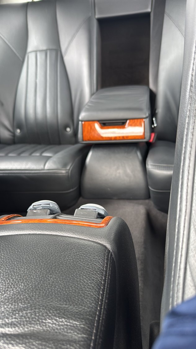

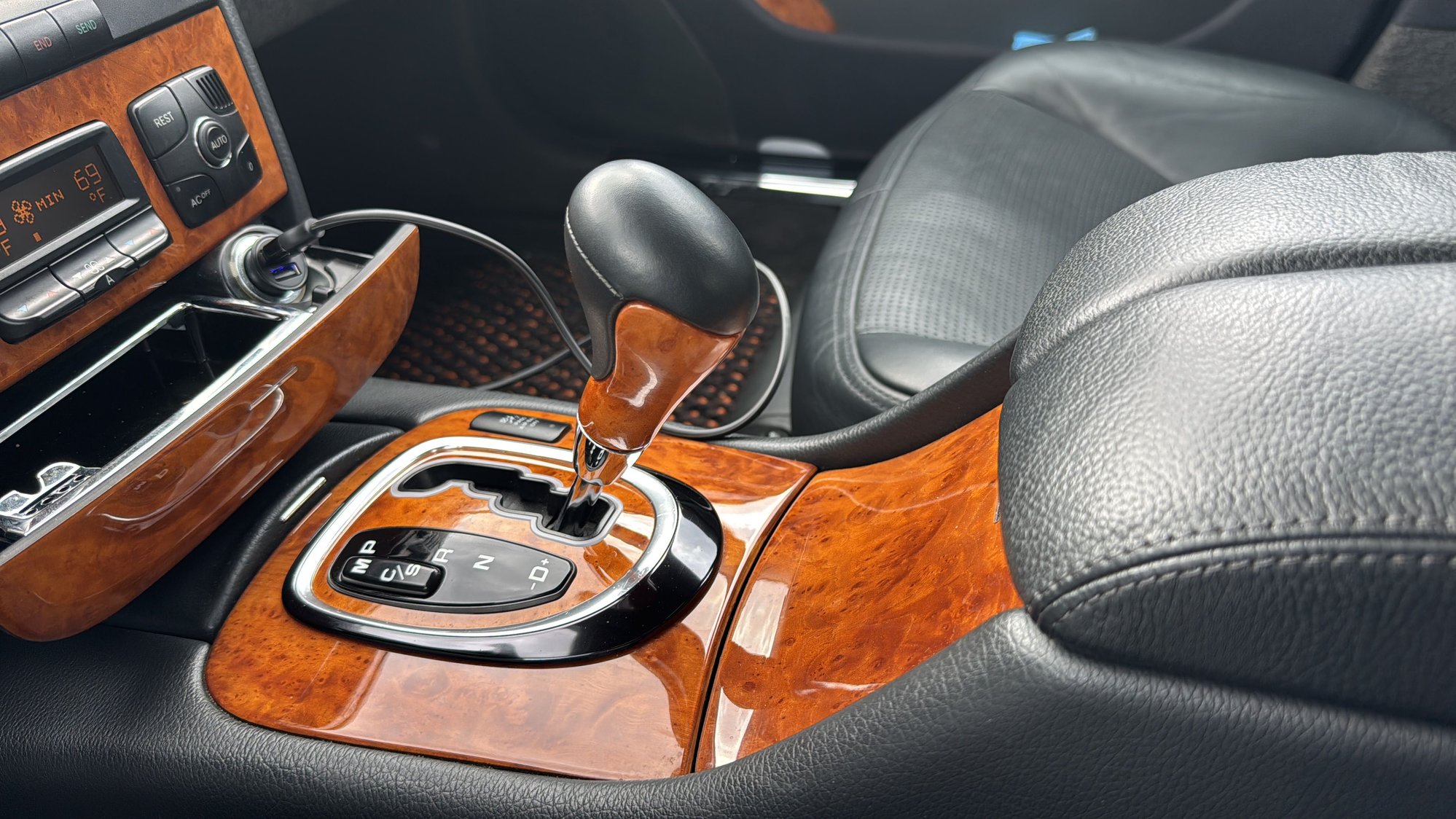

Got this in with some other minor interior tweaks (attached). Low level "groaning" vibration gone and no more leaks. Which is weird because it felt like it could have been driveshaft flex discs or center bearing or differential (something bigger and rotational) but it wasn't. All of that was fine, my buddy (mechanic and shop owner) refused to replace the rubber, diff fluid was new and full, etc. I'd been chasing that vibration for a year or 2, maybe 5k miles, and for all that time he's been refusing to change the rubber, which I'd suspected because it's original. He was right and I was wrong. When we had the transmission out for the rear main seal there was no play whatsoever.
Interior tweaks attached (leather airbag, wooden shift knob and rear armrest wood). Trying to get parts out of the stash and onto the cars LOL
Cheers,

Looks Great MAW, well done. Love the wood accent, gives everything a high end classy feel.
