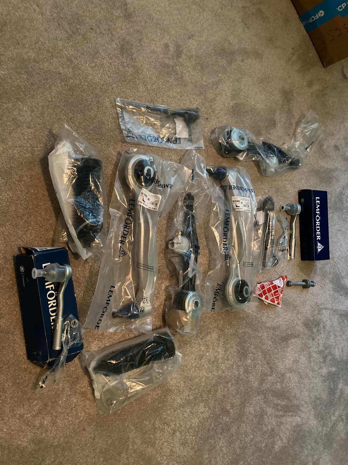

I recently changed the engine and transmission mounts on my 2003 S55.
I installed the Black Series engine mounts,
which I got from FCP Euro.
The driver’s side engine mount I removed
was totally blown out, and leaking fluid.
The transmission mount was also shot.
So, be aware that fluid may leak out when removing the engine mounts.
I wasn’t wearing goggles but it’s a good idea.
Changing these mounts was well worth it, as the car is a lot smoother now. I also changed
the power steering rack bushings.
I will be changing the lower thrust arms, ball joints, lower spring control arms, inner and
outer tie rods, and boots soon. Then, align
it. I also will be removing the supercharger
and changing the gaskets, oil, and the fuel injector o-rings.
I’ve seen videos of people jacking up the engine using the oil pan when changing
engine mounts but I decided to use the transmission bell housing area instead.
If the oil pan got cracked, the car would be bricked, and there would be 8.5 qt. of oil,
all over the floor.
Other items to inspect/change are the water pump, thermostat, belt tensioners, pulleys, belts, temperature sensor, and hoses.
Here’s a picture of my S55.

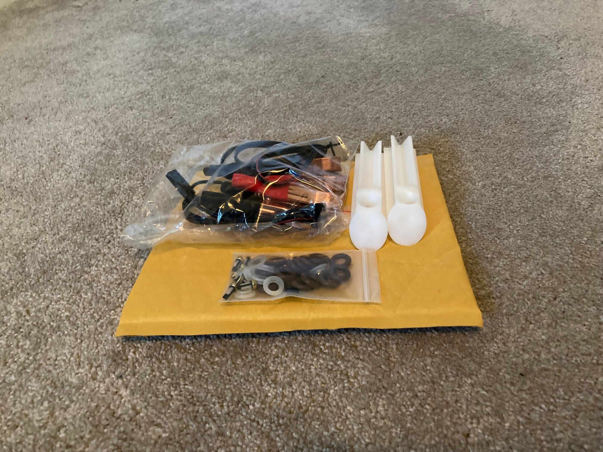

Preventative maintenance. The fuel rail has
to be removed, to get the supercharger off.
I bought an injector rehab kit which has Viton
o-rings, filters, and pintle caps. I also bought
an injector cleaner kit, to flush the injectors.
A new MAP sensor, and air temperature sensor
will also be installed.

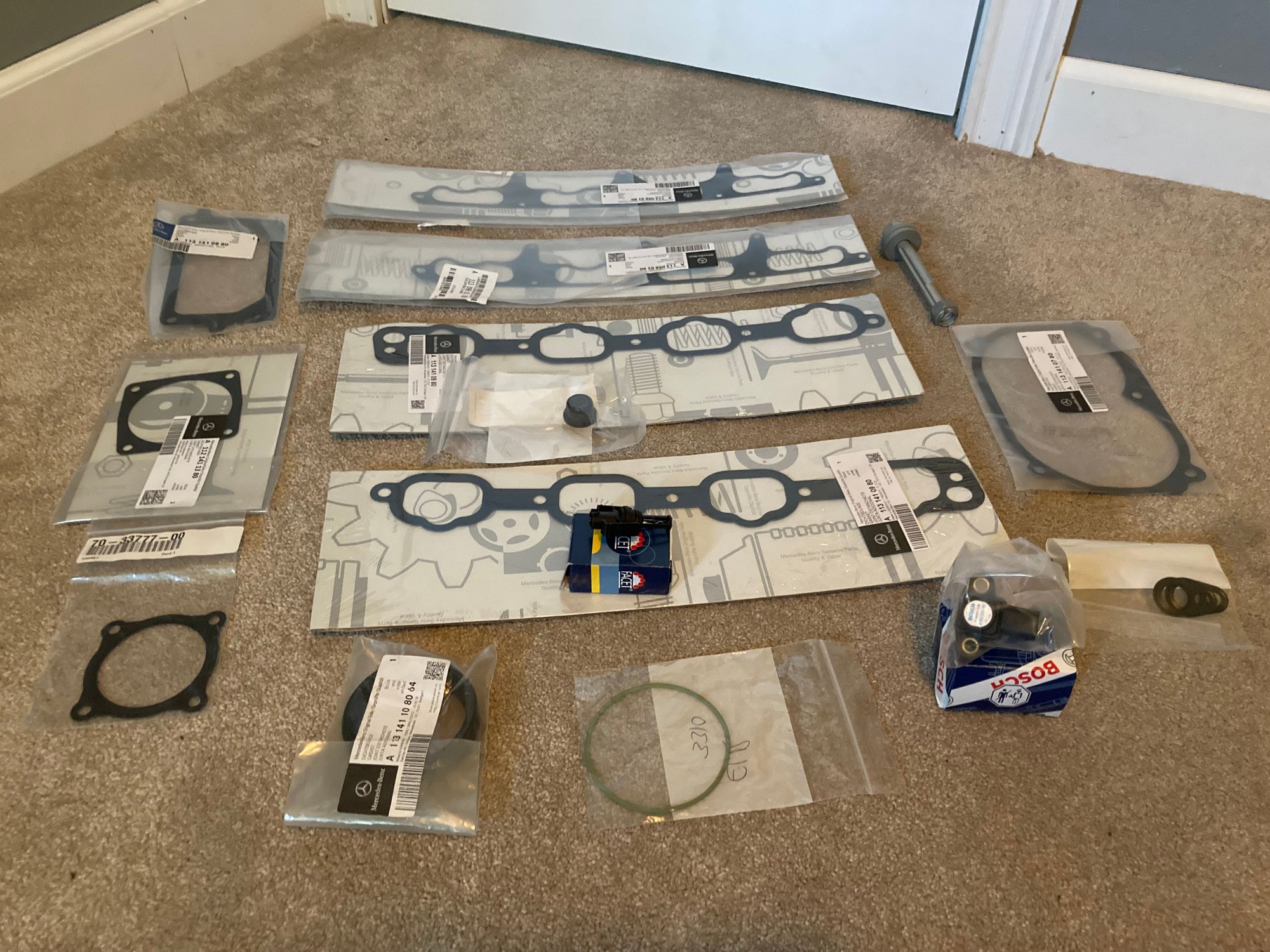

Old Oct 17, 2023 | 02:56 PM
  #34
Mr Bike's Avatar
Joined: Nov 2020
Posts: 162
Likes: 15
'03 S55 AMG / '09 E550 4-Matic / '08 E350 4-Matic
Here’s some pics of the parts, I’m going to install soon.
