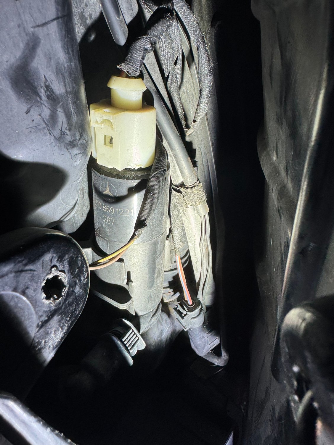

I'm working on this same issue with my W221 2008 S63... the headlight washer is working, but not the windshield spray. I think our setup is different than most info I've found due to the ABC.
I can access the headlight pump by just turning the steering wheel to the right and opening the front wheel well cover. It's right there on the left side of the reservoir. I see the part number is 210 869 1221 267, but it looks very much like the replacement part I bought for the windshield. I'm afraid I might have bought the wrong pump. I don't think I can see the windshield pump without more disassembly, but I'd rather wait to do that until I know I have the right part.
Is the same part used for both the windshield and the headlights? Can anyone point me towards the correct schematic? Thanks for any help!!

@Nyshadw If no one responds, I plan on pulling the wheel and the cover off in the next few days. I should be able to see the other pump then. I will post back as soon as I get a part number on the windshield pump.
The pic below is what I see by just pulling back the front left wheel well cover. I can hear and feel it vibrating when my wife activates the headlight sprayers.
