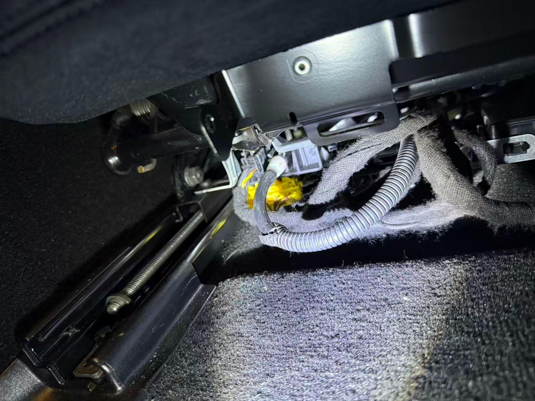

Originally Posted by Gerilpz@live.co
My battery was dead, so I took it to AutoZone and they charged it for me once I installed it. I went back so they can check the battery and the alternator. They stated that the alternator was charging, but the battery was only at 60% when they charged it It was at 100% it. I only drove half a mile right back to AutoZone and it drained half the battery. Can this be an electrical shortage?
My battery was dying and had to replce it before it is so dead. Recently found the root cause was from the multi contour seats air leaks issue that causing air pump non-stop refill the air, that dried up the batter too often. Gald I found the issue in time, and fixed it with no cost. Was very easy to find under both seats reachable. See attached.
