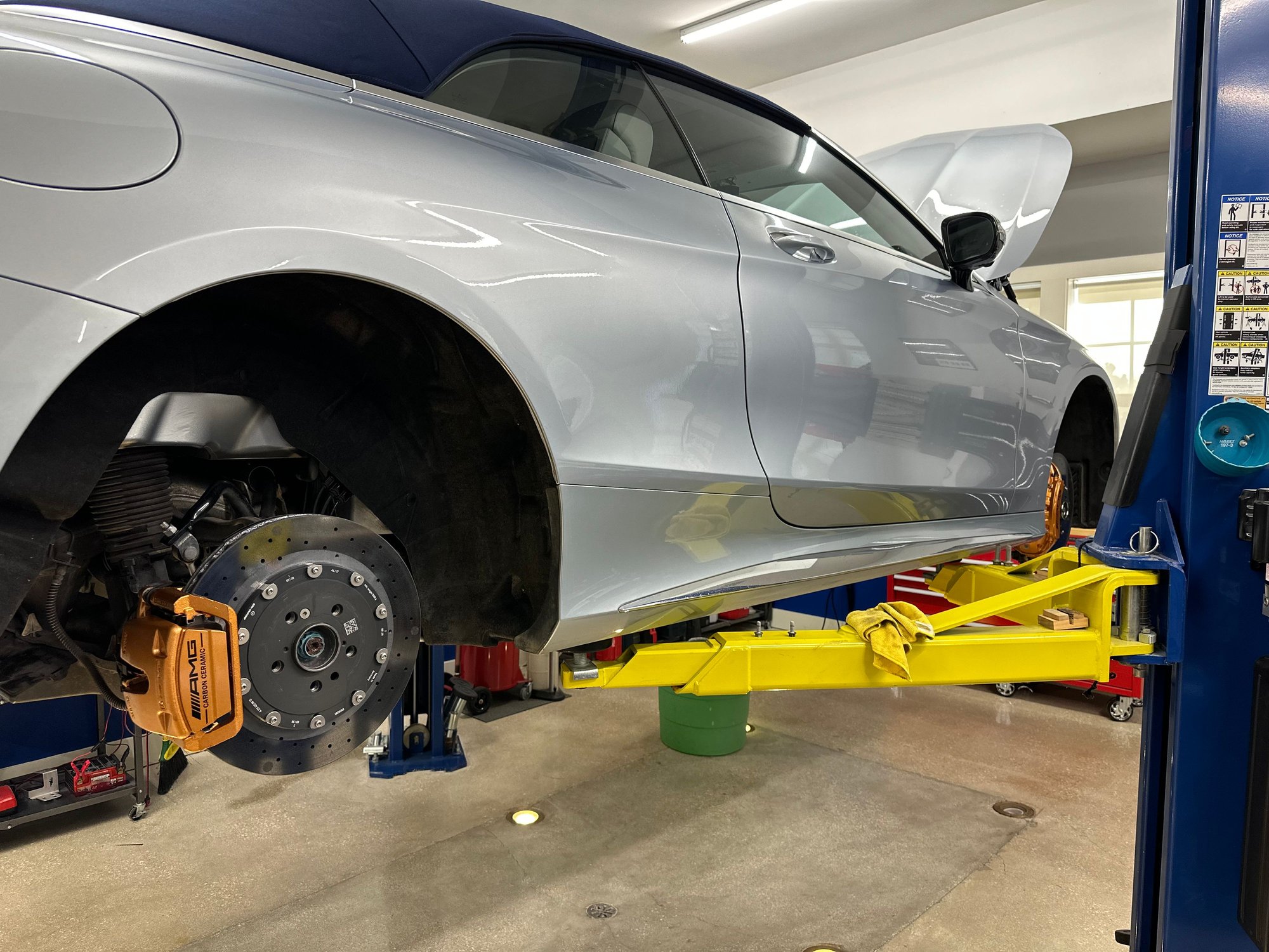

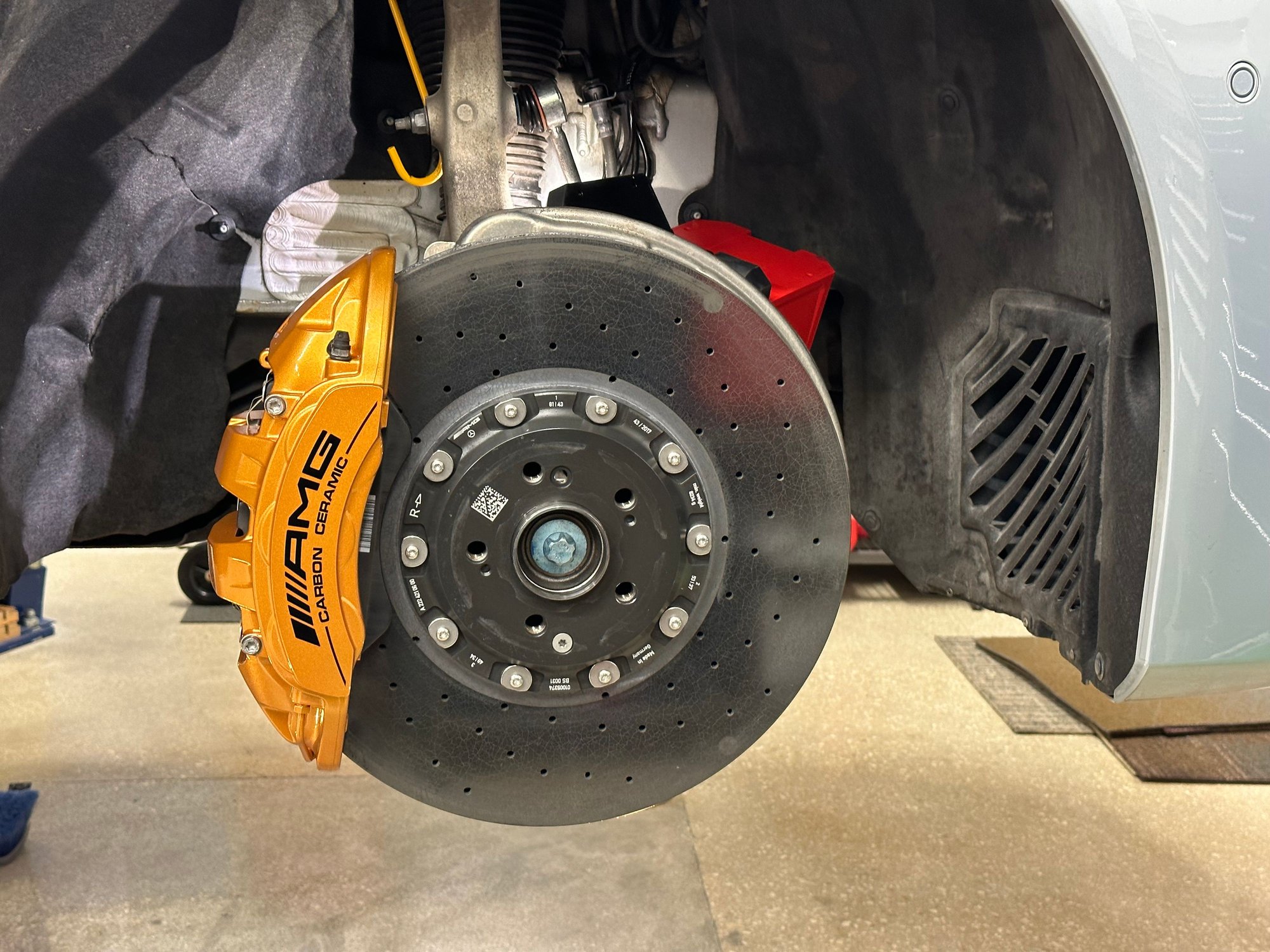

Any issues, what exactly did you end up replacing besides the rotors and calipers?
They bolt right up. Installed new pads and wear sensors. New caliper fixing bolts (this is what is recommended).
Had a slight issue with the mounting of the front caliper wear sensor attachment bracket as the cable was just a little short. I flipped the bracket upside down and don’t have clearance issues. The cable is too short because of the larger diameter of the CCB rotors pushes the caliper up away from center just enough and there is not enough slack between the bracket and the first grommet holding the cable behind the wheel hub. I did not see an easy way to replace the cable in the wheel well, but don’t think there will be any issues.
Vacuum bled the brakes, easiest brake bleed i have ever done. Was my first time trying to vacuum bleed. Have not tested or bedded in new pads, as I finished just before a scheduled trip. Will report on that after a few weeks.
