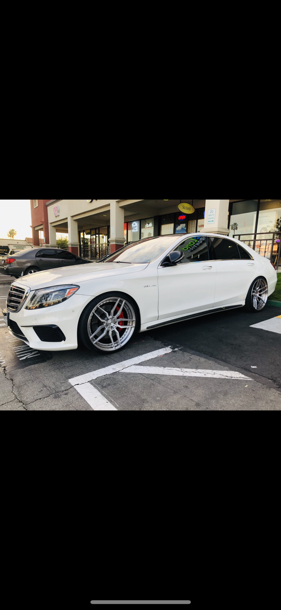

Hi. Based on technician advisement of the wheel specs for the GT63s, they will not fit your S63. You can not downsize the “tire” size from a set wheel spec. You can however up 1 size of the tires usually for a more aggressive stance, but not downsizing them.
I had 22” Adv1 as per attached and they are 265 front and 295 on the rear with same wheel spec of the OEM wheels except they are 22” wheels and tires. I hope this help.

The Mercedes GT63 and S63 Coupe have totally different wheel fitments. Yes, you have seen some S63 Coupes use wider wheels & tires like the one we did below (21"x9.5" || 21"x12" with 265/30/21 || 325/25/21) however those specs were only able to be achieved when the HRE P204's were built with the correct offset. When you try to mismatch tires on factory wheels from a different Mercedes model you risk encountering multiple problems both mechanical and visual. The tires may hit the inner struts or fender liners. The tires will also fit on the wheels different front & rear causing a funky look. If you have any interest in purchasing aftermarket set of performance wheels that are specifically built to fit your S63 Coupe and the specs it requires give me a shout and I'll help you ever step of the way so that you acquire a perfect fitting set with no headaches.
