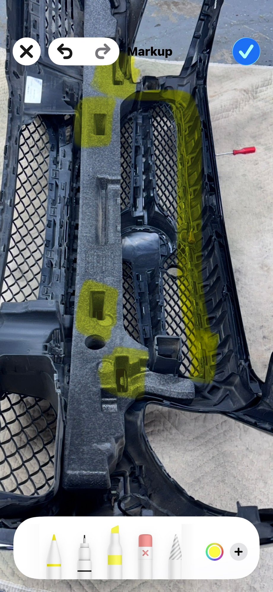

So after the two hidden bolts gentle wiggle and when bumper finally comes forward depending on your model and options mine had 2 wiring harnesses in driver side unclip those and away you go.
with bumper laying on saw horses or on ground on moving blanket, etc you will have crash guard (?) cross member you need to remove (see picture -highlighted in yellow) two recesses in each side.
then along top you have clips you need to push the centers toward center of grill and bottom I had some guard that made it difficult to find and push in.
the star twist 10-15 degrees (remember to look at orientation). It only goes in one way but what. A PIA to figure it out when you don’t 😳🤦🏼‍♂️
clean up and reinstall. Good luck with mods or better yet trying to keep it stock 😊🤷🏼‍♂️
On top is to the right, 4 at bottom from crash bumper support. Clips along top, sides and bottom to push inward

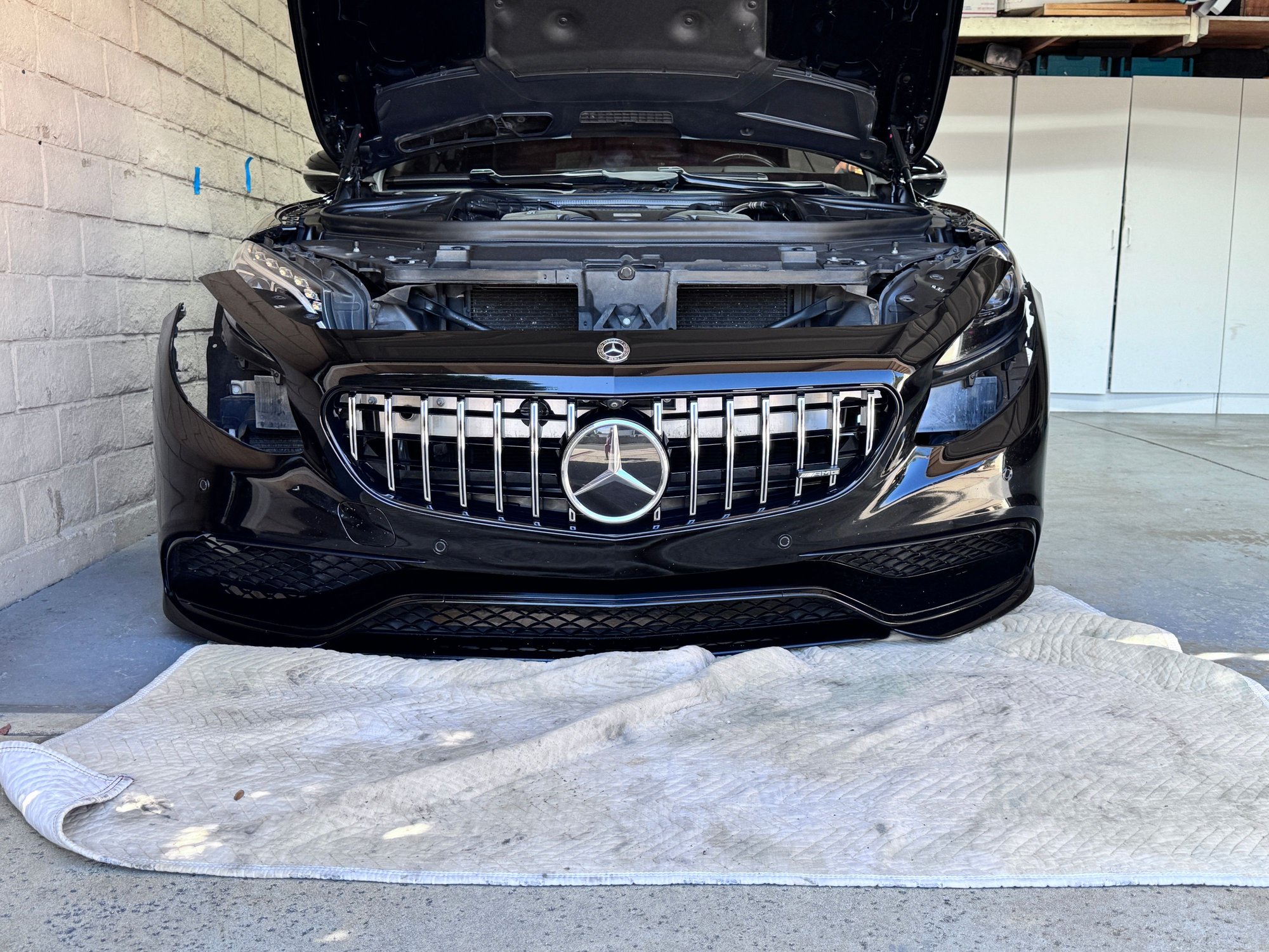

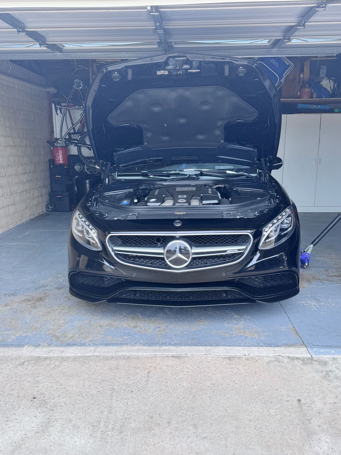

Old Apr 2, 2026 | 07:01 PM
AMG_55_cruiser's Avatar
Joined: Aug 2014
Posts: 283
Likes: 40
From: SoCal - OC
2004 CL55, 2003 SL55, 2017 S63 Cabrio and 2009 G55
Before and after
