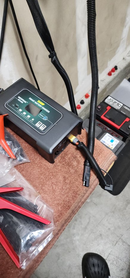

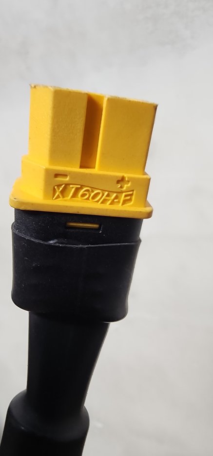

I wired mine under hood, + wire to the + jump terminal and - wire to the ground lug under hood, bought a 35 amp charger tender off Amazon as it was also rated to charge Lithium Ion batteries. Got the right plugs off Amazon too, to make and extension cord. This charger also works well keeping the battery charged while doing diagnostic repairs. And know this, the AMG's use a Lithium Ion battery that is hard to get if at all, if you need to replace it with a AGM, your car will need to be reprogrammed to charge an AGM battery, SEE THE BENZ NINJA!
I put my S63 on the charger anytime it's not going to be driven 3 or more days.
I also run a new set of these electronic rodent/insect repellants. Mice really love Mercedes-Benz wiring, yep Amazon.
How exactly did you wire it to the terminals. If you could take a pic that would be amazing and would appreciate it.
Negative jumper.
Everything going into this juction is +
AMG Lithium Ion battery is no longer available.
Negative jumper.
thanks again for these pics. I installed the M10 eyelets in the same spots as you and I have my Noco Genius 10 plugged in. It’s perfect because it’s a smart charger and goes into tender mode so I never have to touch it. Thanks again.
