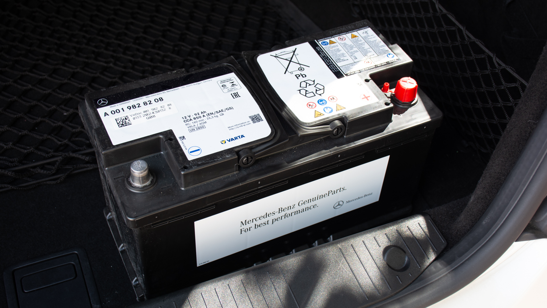

it's a regular MB 105Ah battery (A 000 982 18 08), which you can easily replaced with another model battery (92Ah), which is SIGNIFICANTLY cheaper (A 001 982 82 08), while having the same size and crank current (above 800Amps).
(original S63 W221 was also ~105Ah large, then they revised it to 92Ah). When checking part numbers, the large one shows up as OE for my S550. But when I look again at the 92Ah one's list of compatible vehicles - your S63 and mine S550 shows up again... strange? :-)

Originally the S63 (the 2014 at least) came with a Li-ion battery to save weight ~45lbs. The dealer hasn't gotten back to me yet about whether a regular battery will work, wasn't sure if the charging module was different. But yea, I see the AGM battery is listed for the car. I wouldn't mind the original weight saving battery if it were available, although the dealer said it lists for almost 2 grand... I could find cheaper ways to save 45 lbs, like not eating pasta for 6 months.

My SA says I cannot switch over to an AGM battery. ?!

Yeah I figured you wouldn’t be able to switch. It’s best for the car though.
