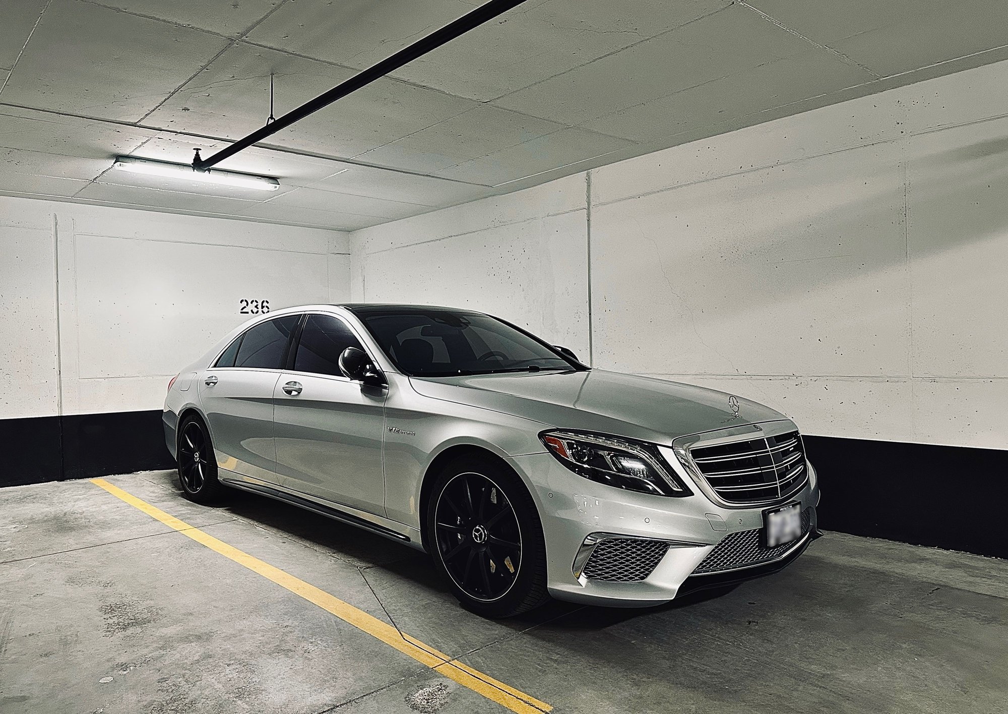

Hi folks!
My pleasure to join the forum. I've been reading up for a while, and finally decided to register - this is my first post here.
I've recently had the privilege of buying a 2015 S65 AMG pictured below. The car represents significant sentimental value for me, as I owned it at some point in the past and always regretted selling it. After seeing it come up for sale, I couldn't pass it up.
Now, the car appears to have been well taken care of in the meantime, including a complete maintenance record. The interior and exterior are also largely immaculate.
What bothers me a bit though is that the car is ever so slightly on the wrong side of 100,000 miles, and from my experience, this is when "it" starts to hit the fan. I'm planning to get this S65 in Concours shape and never sell it again.
I've crawled over the entire car myself, and got it inspected by 2 separate Mercedes-Benz dealers. Both have assured me that the car is in fantastic condition, and requires nothing aside from a few minor maintenance items (e.g. new wiper blades, new brake pads, etc. - all are already taken care of). I've also replaced the following, just for the heck of it:
