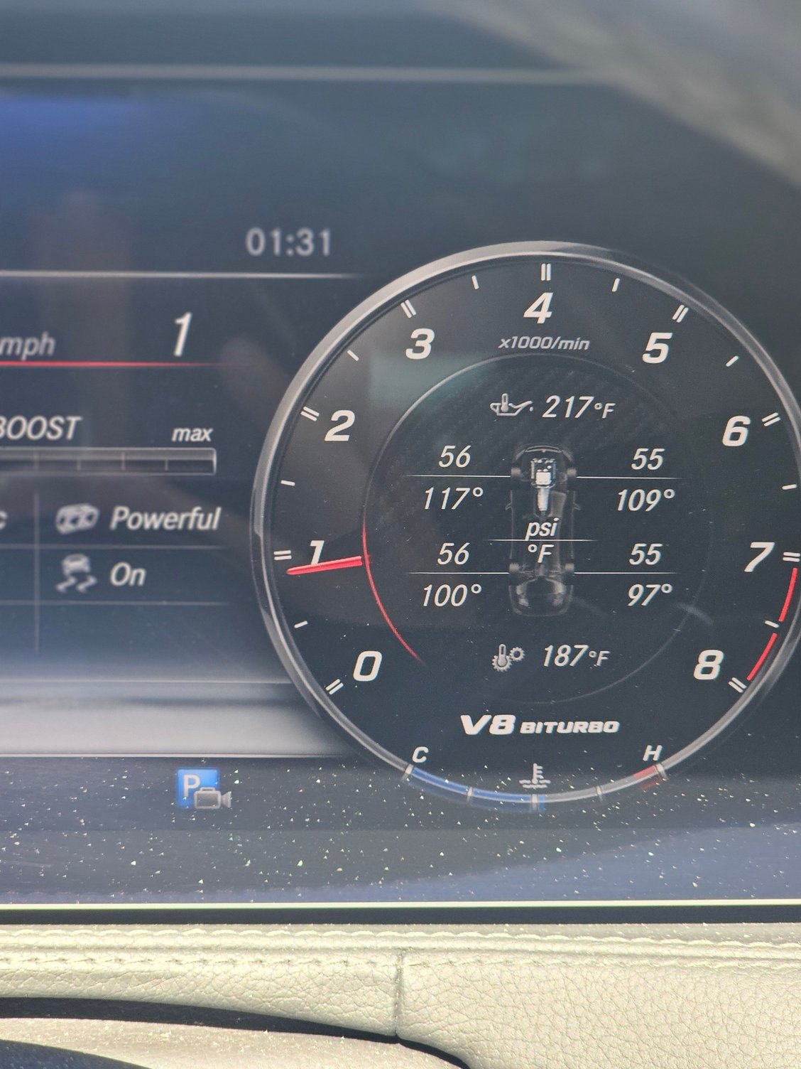

Just realized two things, no squeal brake noises until the brakes get really hot, prolly above 140 degrees. My driver side front tire temperature is always about 9 degrees hotter than my passanger side. Usually 5 to 10 degrees hotter, avg 9. Attached pic.
Somebody else needs to chime in here and help. I can't relate to your fluid temps. I'm up in the moist PNW so I never see my temps on anything as high as yours. But that's not to say that means anything. Even when my rear brake temps were at 190 degrees farenheight, my tire temps never went above 80 degrees. But maybe that's based on ambient temps around 55 degrees. Your temps might be normal for warm climates. Your tire pressures are extremely high; a few lbs above max pressure. What are your cold tire pressures? You should set them somewhere around 45psi, most guys go even lower. I have mine set around 49psi.
Just realized today after turning on the air pressure sensor it was 55. Gna lower to 40-45. Max tire is 50psi on tire itself, on the door it's 49 psi front, 51 back, but cold.

My oil and tranny temp gets that high in the summer.
Thanks for the input, that's good to know. My oil temp rarely topped 200 in the summer, even when I pushed it, and I never remember seeing my tranny temp above 150f. I'll see what happens this summer.
Scratch my last statement. I just saw transmission temps close to 175 today. 175 is totally normal.

222 S-65
Carlos here in the valley of the sun I see transmission temperatures of 220 any day with ambient over 85.
Engine oil temperature finds its way to 200-220 and will climb from there when I’m a savage or going up a long hill at three digits.
As for tire temperatures WOW! Mercedes you have gotten deep in the weeds for things to get owners to worry about!
Tire temps.... Not an exact science just as TPMS sensors sending a signal are going to be off some. Worry not.

Originally Posted by Vanquish59
New issue guys.
  1. Squealing/high pitched wine coming from the front of the engine, right by the fan. Bearings? Alternator? No cel. Noise pops up after the car has been driving for a good 10-20 minutes while IDLE. (This is the primary major issue). Attached audio.
  2. Front pads are already worn out. I replaced the front ones with powerstop's (Z231291) 9 months ago, and drove them only 3 months. 6 months of sitting and they are already flattened. Stuck piston? Calipers? Kind of weird. I did notice the tire temperature of my front left is about 8 degrees higher than my right (can be because its worn down more). I ordered the high performance version instead (Z261291)
@carlosinseattle
@superpop
@PeterUbers
Regarding tire temperature higher for front left vs right tire:
I have noticed the same for both my S63 - learnt this has to do with radiator position and heat venting. Same anomaly with BMW cars as well.
I have noticed up to 10-12 degree F difference - not an issue.
Old Jun 16, 2025 | 05:52 PM
  #200
Vanquish59's Avatar
Joined: Jun 2014
Posts: 517
Likes: 71
From: Los Angeles, CA
2019 S63 AMG (Current), 2015 E63S, 2008 E63, 2005 E55
yes, learned that as well, thank you!
