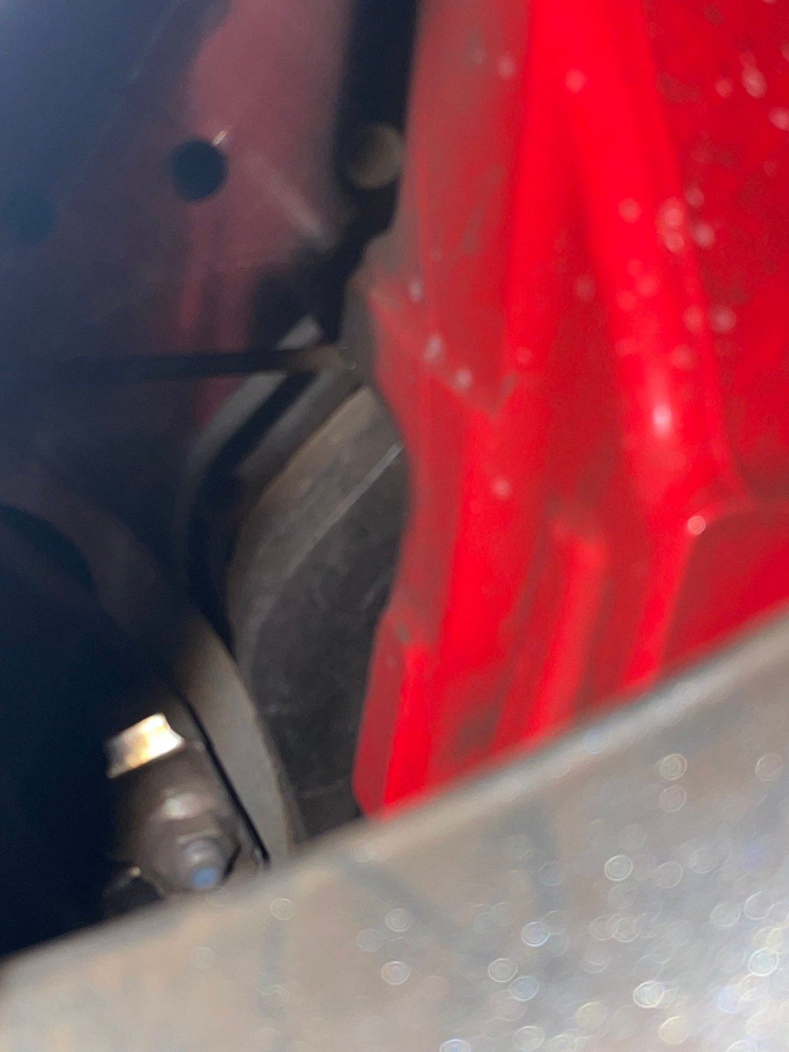

First set of pads on brand new brembo rotors. Aggressive driving. Maybe 5k total miles. Changed 9 months ago front. The rears i changed almost 2 years ago and they still have a lot of life. Both front and rear pads were put on brand new aftermarket brembo rotors.

usually the rears burn out faster with all the rear traction control and stability assist with aggressive driving; you seem to have the opposite experience.
5k miles with aggressive driving and the fronts are toast? Dang, I guess that could happen, people that track their cars get maybe two or three heavy track sessions out of a set of pads so 5k miles? Why not. It's a heavy car the s63, too.

daily spirited driving s/s+. Attached pic. Pretty odd seems to be decreasing in an angle. No track days. Rotors still seem ok tho right? Brakes are ok, no issues cept crease noise. Stop power has decreased slightly. Ngl, oem has better grip but I'll take ceramic no dust over oem anyday.
no bueno - not supposed to wear like that / install may be bad, issues with slide pins etc you may be correct about stuck caliper slide pins - hence your aggressive wear

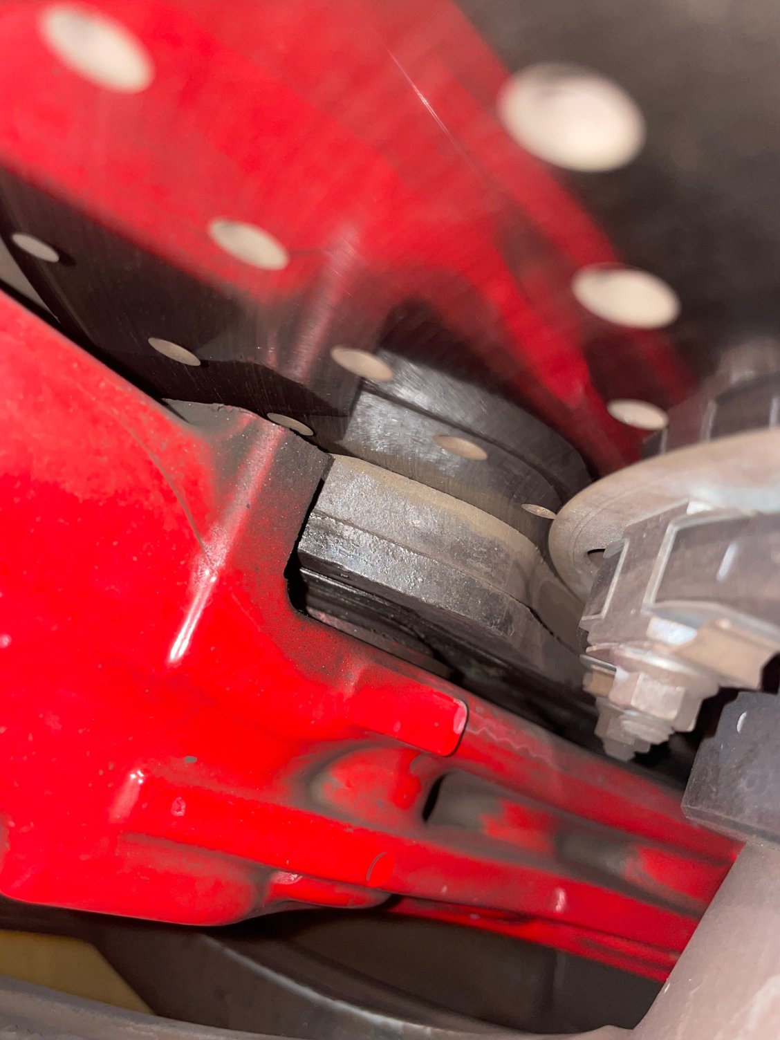

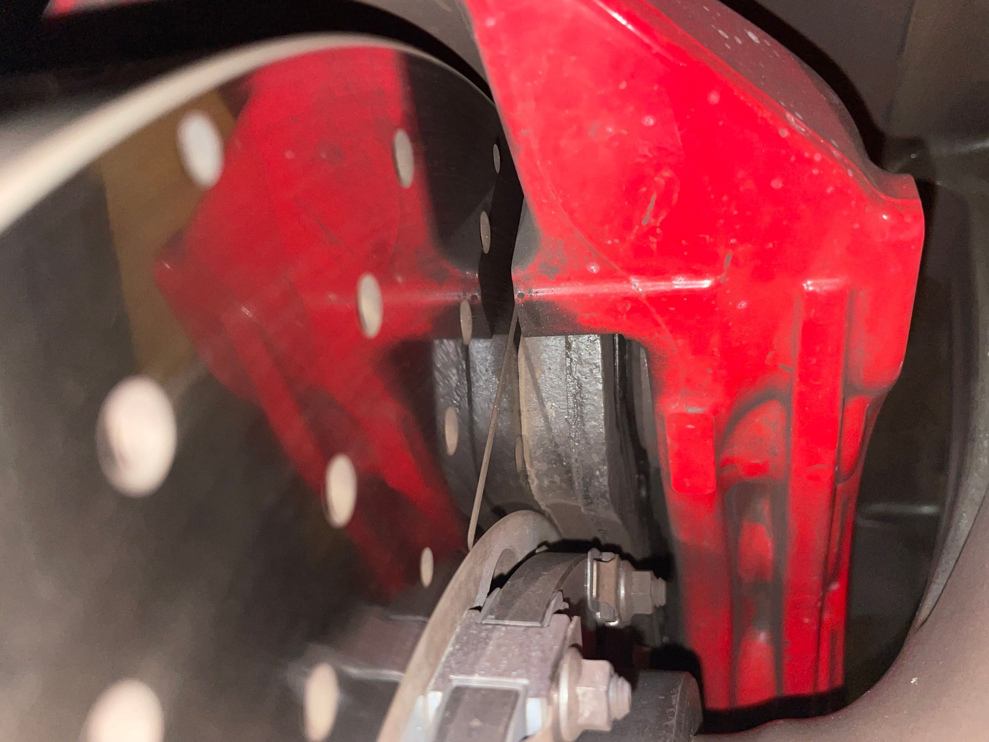

and why is this brake pad sliding out of this caliper - same on other side? Who installed these?
myself, followed the documentation to the tee, even changed caliper bolts, which are one time, and torque speced them. Replaced rotors, cleaned caliper bracket, installed pads.

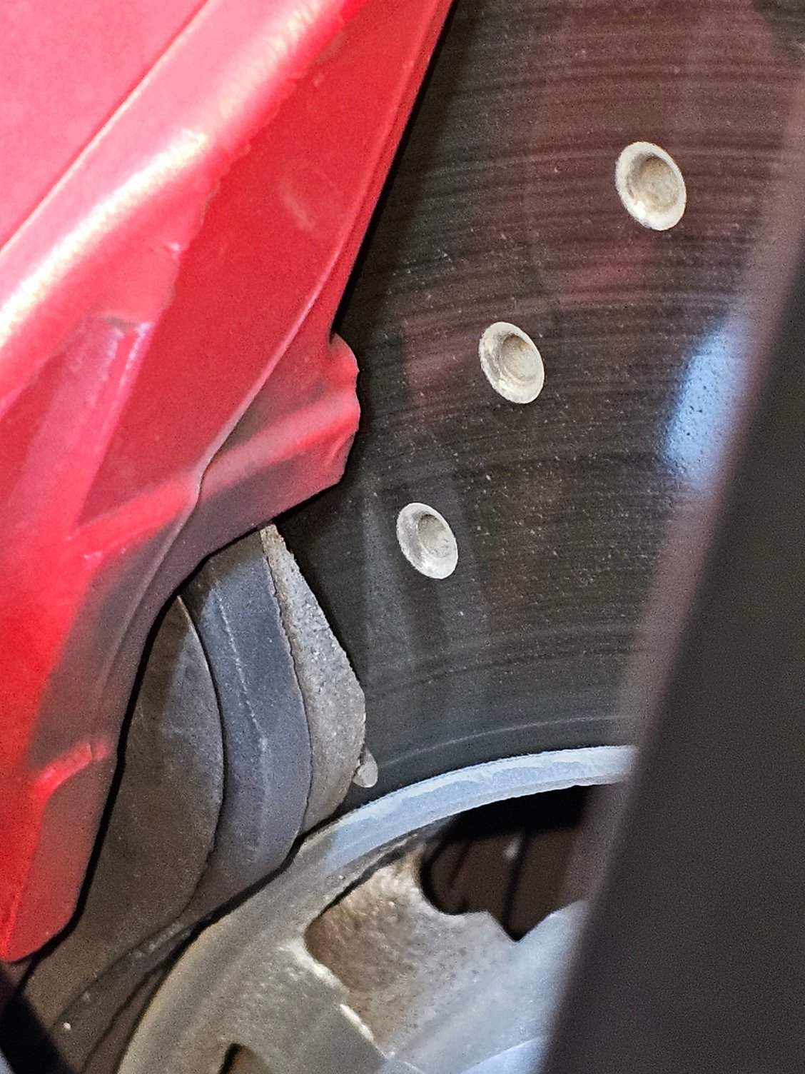

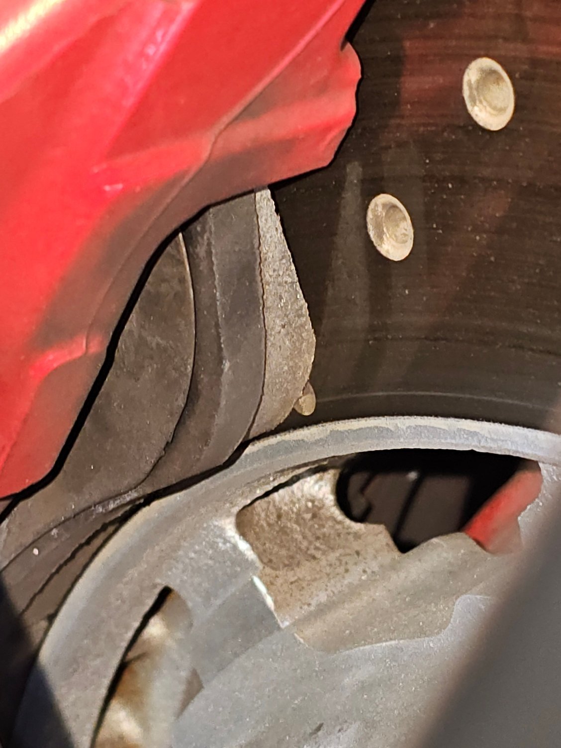

Originally Posted by superpop
Pads look fine to me, the Powerstop pads do have beveled ends so that can make the pads look thinner than they really are. Also, the pads are not sliding out, that is how they sit in the caliper. I have 25K on my Powerstops and they still have about half the meat left front and back. Maybe it is just the angle of the pics but you appear to have most of the pad left.
Rears definitely are wearing out evenly. Fronts are wedged. Also when I apply the brakes, I hear the slight metallic contact coming from front. Anyways, I already ordered the high performance version of the powerstops(Z261291), will be changing them next Tuesday, will post pics. Ever tried the Z261291?
I have the Z26 pads on the fronts and the Z23's on the rears. They have worked flawlessly. What do you mean by wedged, if you mean they are wearing more towards the inner circumference of the pad vs the outer or vice versa then that is typically caused by the pad hanging up on the slide pin. if you are talking about the chamfered edge on both sides of the pad that is how they are made from the factory.
The wear looks wedged. The inners seem more cooked than outers. I had z23 on both front and back. Can months of sitting cause the slide pin to seize? Are we talking about the two long nails that you have to hammer in or the bolt that goes into the rubber boot?

Did you grease up the slide pins? I'm sure you installed them fine - the pic just seems weird and wedged like you said - my calipers don't look like that I'll try and snap a pic
is your pic there the front or rear caliper and pad?
Yes greased, front.

Pics are left and right front calipers

On the AMG 6 piston front calipers, there is no slide pin other than the pins that hold the calipers in place. They are a fixed caliper with 3 pots on each side that equally compress. The rears do have a floating caliper though with slide bolts that mount the caliper to the caliper bracket. If you are saying that the inner pads are wearing faster than the outer pads that would indicate a sticky piston on one or both of the front calipers. Very unlikely that both calipers have sticking pistons though. I would pop the front wheels off and remove the pins and pads and do a true visual inspection. Hopefully it is all just an optical illusion based on the limited view you currently have of the pads.
