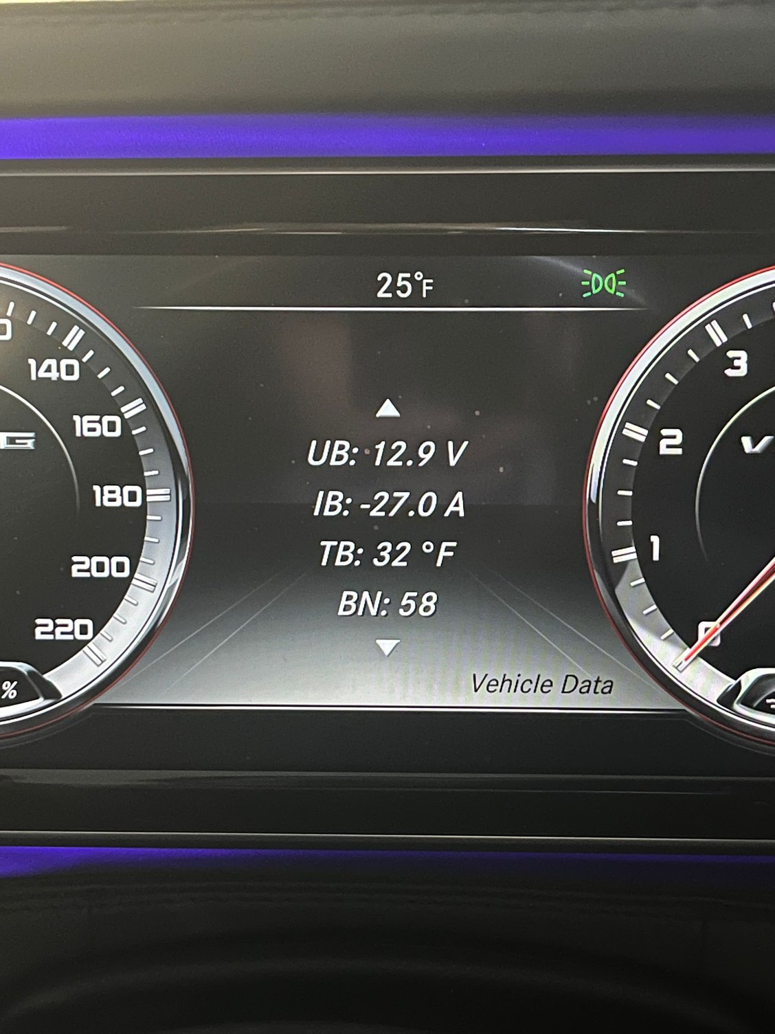

Hi guys, I’m an owner of 2015 s65 with 48k miles on it. I’m new to the forum and would like to get some help from experts in the forum.
so I have owned my car for about 9 month and the car is mostly great but have some issue with battery.
The car will be dead if I do not drive it for about 6-7 days and I would have to jump it. Is this normal for the lithium ion battery for S63/S65?
I checked the battery voltage, etc from the workshop page in car and it looks to be normal, but I let AutoZone to test the battery and they said the battery test failed probably because CCA is lower than expected? I’m not sure how accurate that is.
I’m not sure if the battery itself is bad or there’s something that’s consuming amps abnormally or the car is supposed to like this.
would appreciate any information and help!
The reading when the car is not started and sits for 4 days.

Thanks for the input. So seems like there’s something wrong with my electrics/battery.
How do you know the aux battery needs replacement? Could that be related to the main battery drain as well?
I think I might need to check the battery date first, and then find a specialist to check the root cause of the drain.
