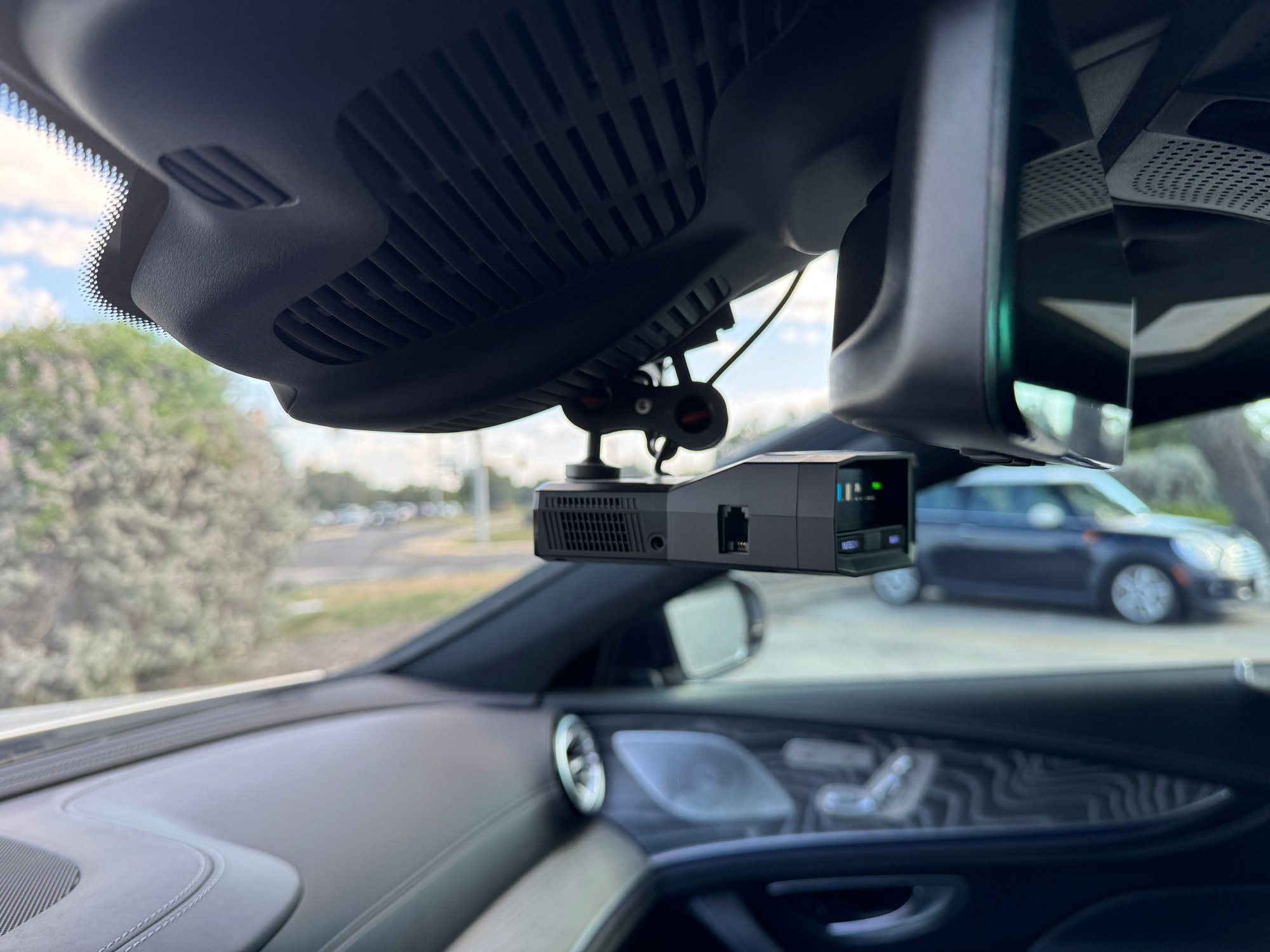

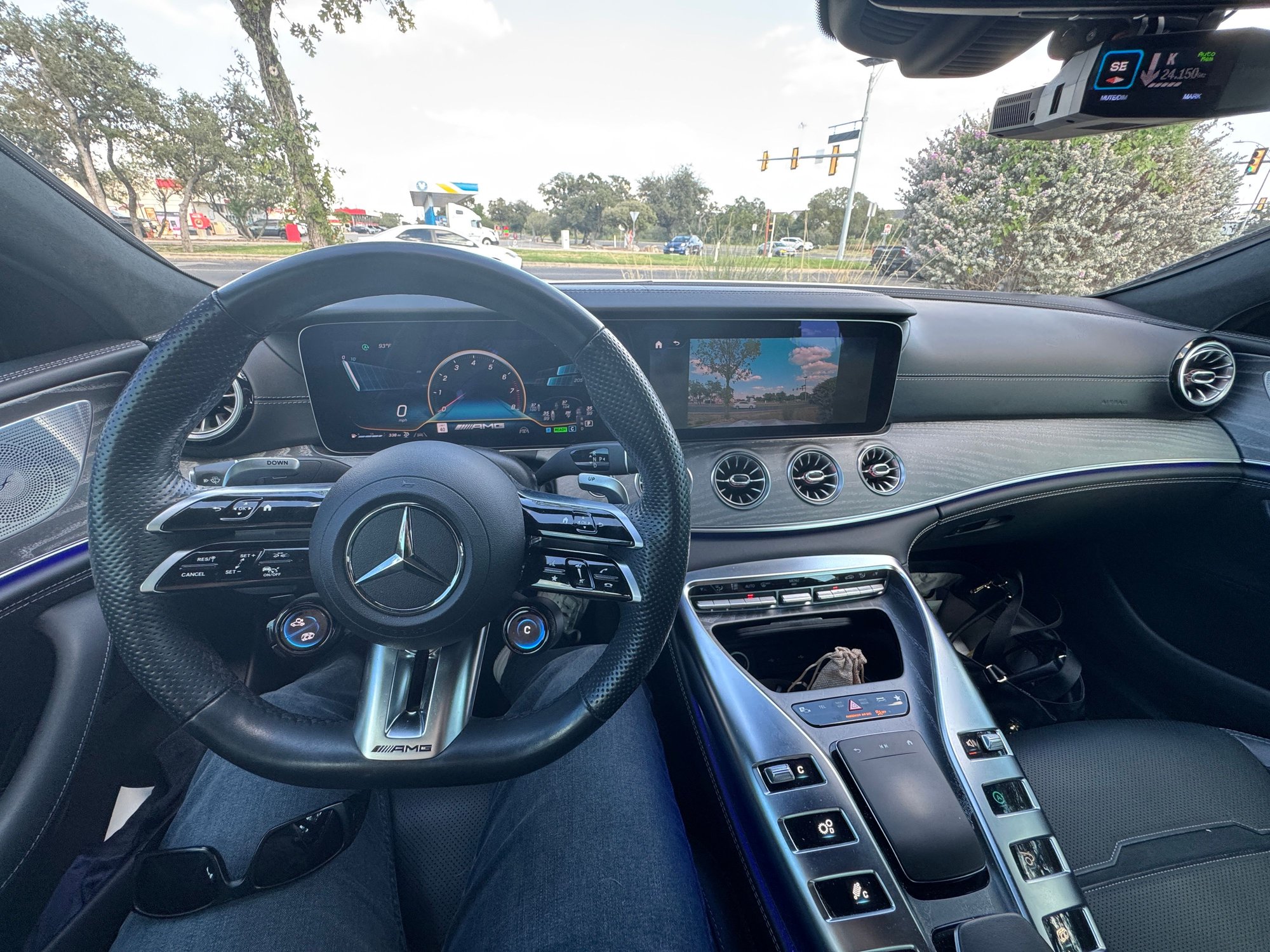

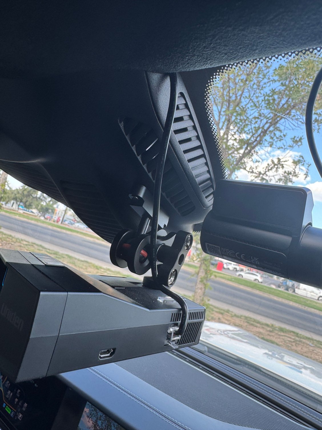

Here's how I mounted mine. Ran power along the bottom door sills to the trunk fuse panel.
