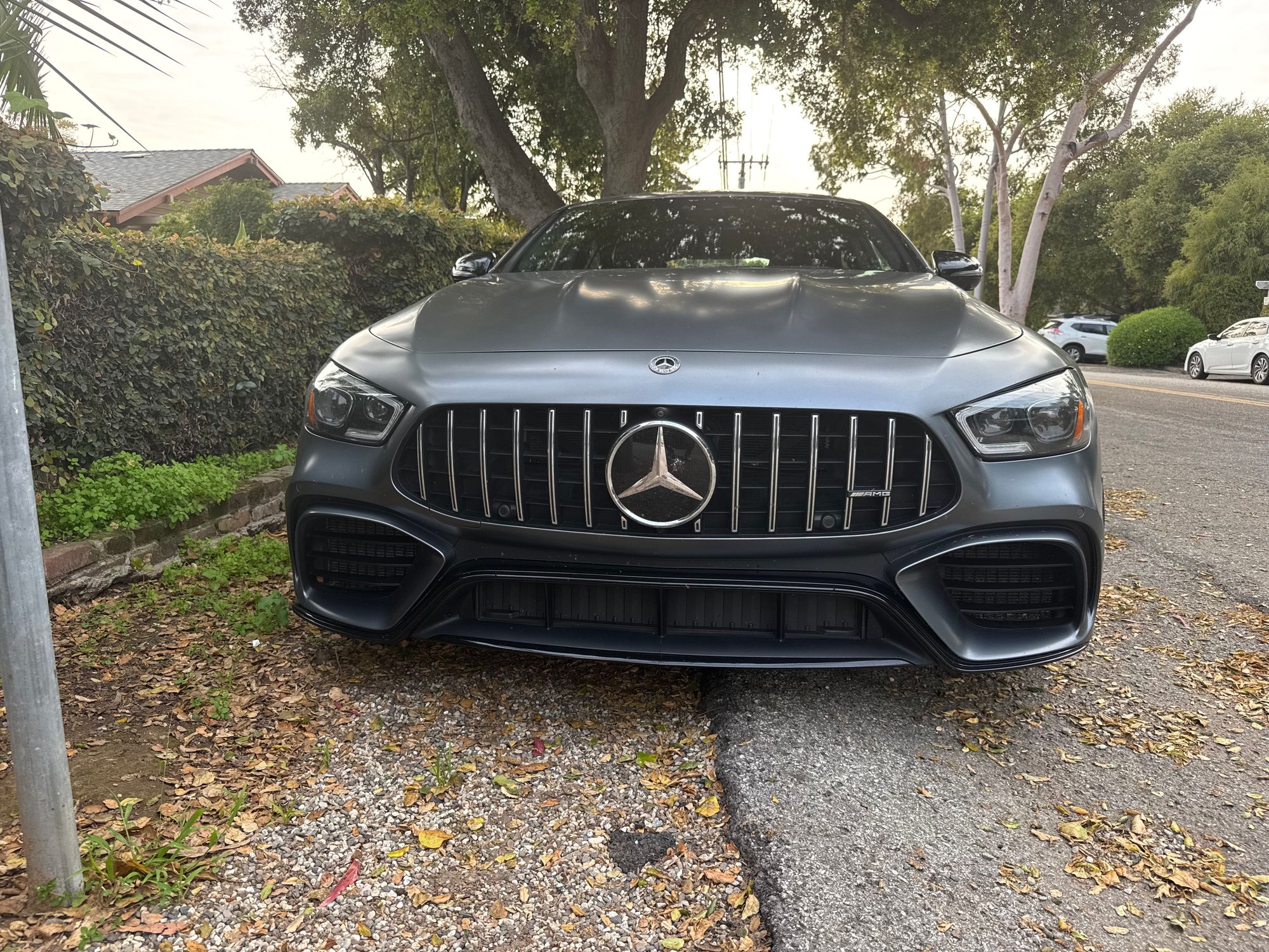

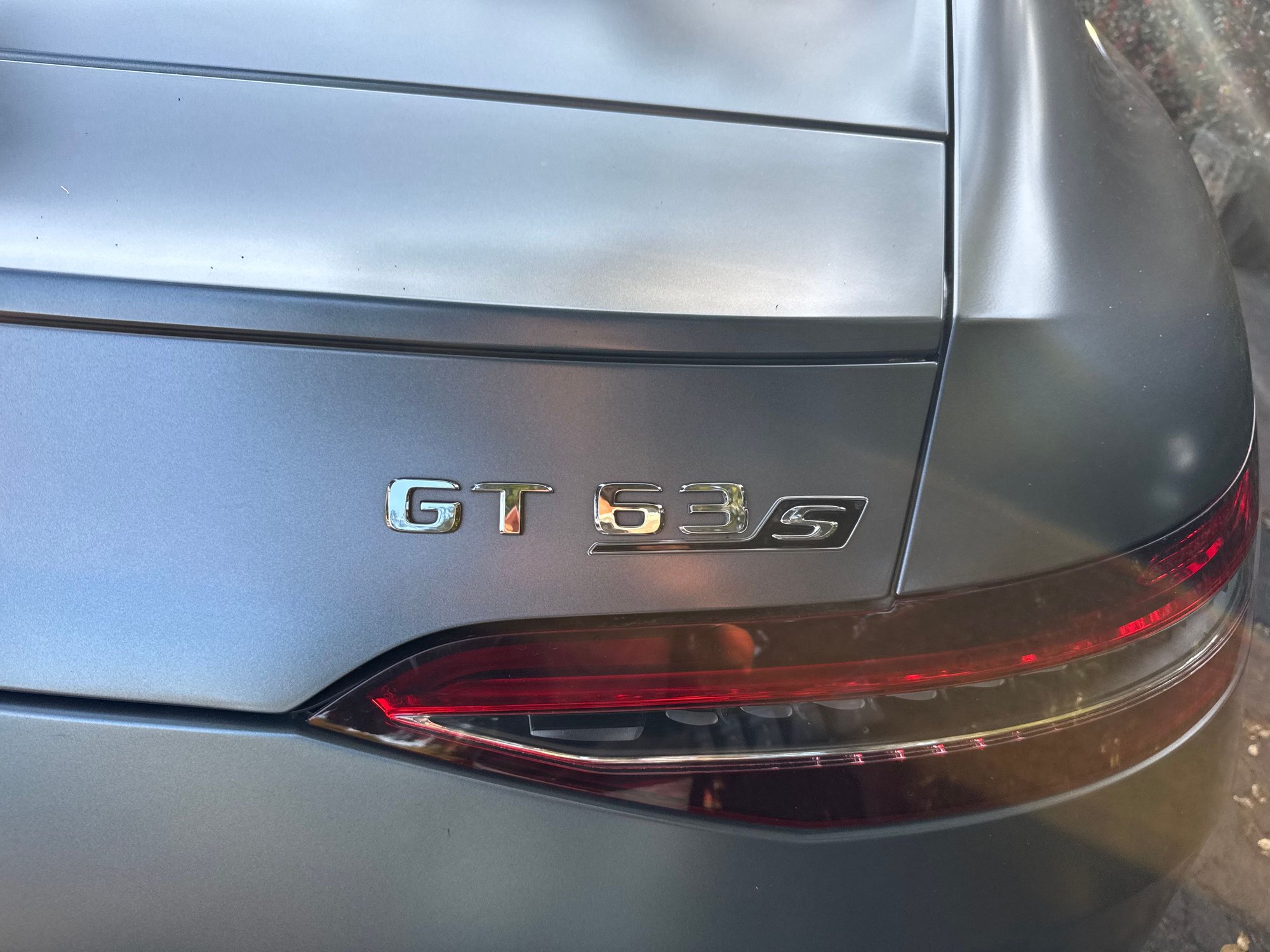

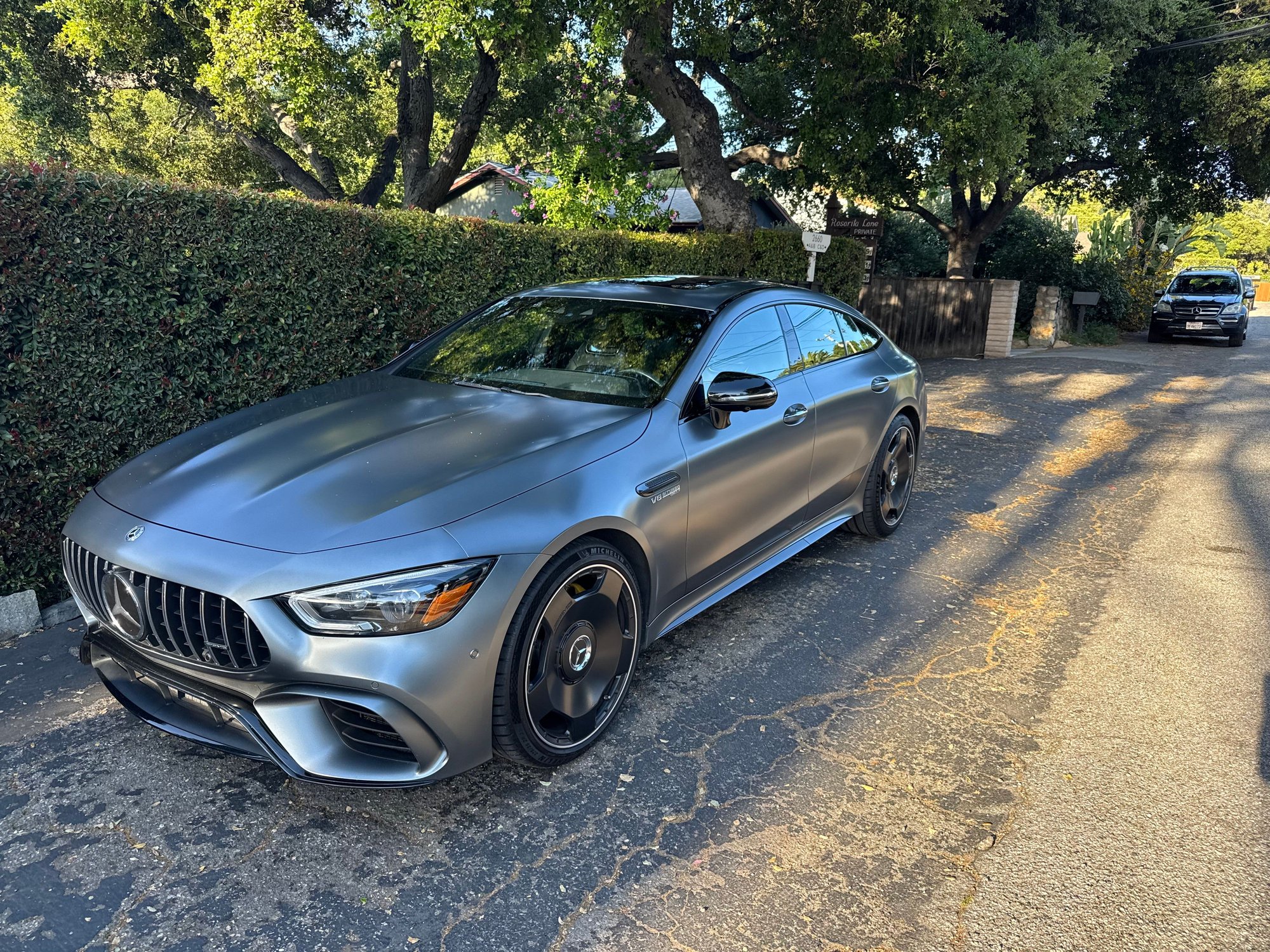

Hello,
Thanks for the advice and links, I will review them.
Here are some pics.

wow , like this magno grey colour
