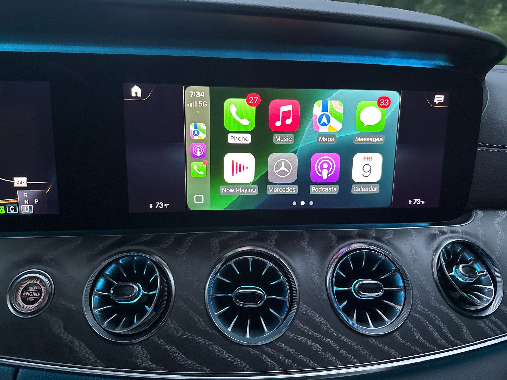

Does anyone know how to code the apple car play to be full screen like it was in the 2019 GT’s?

not quite possible with MBUX 1.0, I am wondering if you can use those android auto adapters/boxes instead.
Or maybe it is possible, ask a third party coder such as the one with the banner on top of the forums.

MBUX 1 doesn't support full screen. Those two virtual buttons for home and messages have to go somewhere due to the lack of physical controls. Is a step backwards like many other things in MBUX. I remember seeing a firmware upgrade in later model years making it a bit wider, but still not full screen.

Just to add a bit of technical background. The screen itself has an aspect ratio of 8:3 (or 24:9). That's an aspect ratio Apple CarPlay natively supports, so on NTG 5.5 it's therefore full screen. However, with MBUX 1, those touch buttons take away screen real estate, so it can't display CarPlay at the higher 24:9 aspect ratio. The next lower native aspect ratio is 16:9, which is what it's using here, so that the CarPlay UI is narrower than the screen itself, leaving room for those touch buttons. There's technically a common aspect ratio between the two at 21:9, but CarPlay doesn't natively support that. It supports it via scaling, but that can distort apps as they are not natively designed to render at 21:9. The gist is you are essentially stuck at the lower 16:9 aspect ratio. It's not a matter of coding. It's a matter of UI compromises to support touch first, and the aspect ratios that CarPlay supports natively without stretching the app UIs. MB corrected this with the much larger center screens in the current models. There, CarPlay takes up all the available space above the climate controls and home button, just like the MBUX screens themselves.
