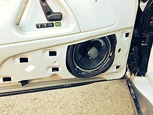

I got new speakers did not go whit bose they r old get some 2ohms jbls
