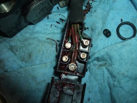

I would say the wires to the valve block Y36/6 have lost their insulation and were causing the 4 Ripa valves to open sporadically. If the OP would choose to inspect the valve block wiring, he would probably find that this is the only thing wrong with the ADS II. Just open the electrical connector block near the passenger side strut tower and take a peek. Bear in mind that none of the wires are colored green.
