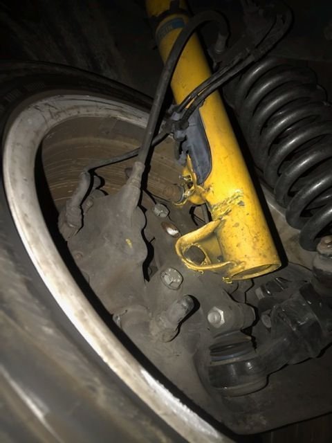

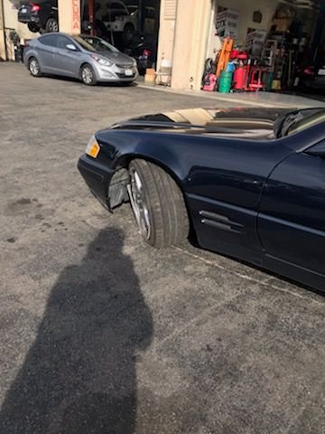

Last Saturday I felt a little racey and flipped off the ASR on my 98 SL500 for a stop light race, no problem with that however I forgot to turn it back on. So a little later I took a fast right corner with a lot of room, but not enough. Spun out and folded left side against curb, lucky no body damage but broke sub frame, both wheels front and rear knuckles, links, tie rods and other sundry items. Drove it about 2 miles home on three wheels as the left front $B6 mount broke off so wheel was dangling in the wind. Now large parts order on the way

Jeeze Louise. Hope you're alright. Post some before and after pics if you're up to it.

Here is a start more pics next wee at teardown

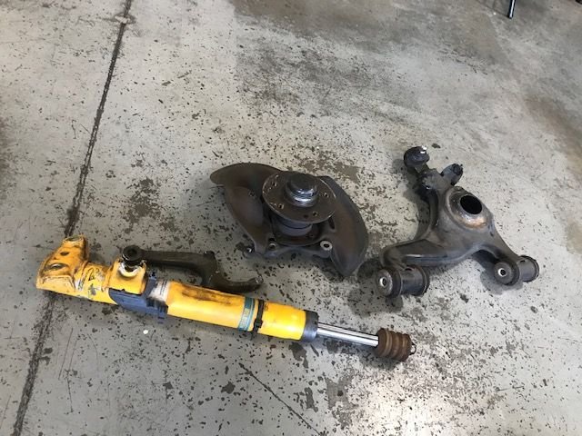

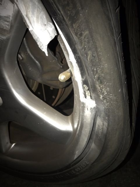

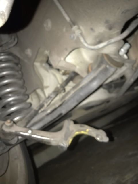

That steering arm is forged.
Very impressive path of destruction.

Well as I see it, all the racing I've done with my 3 R129's and the worst cost I've had to suck up is about 4 trips to Disneyland and my "E" tickets are still good 24/7. Now a mishap like this at 160+ ????

That's a pretty good adventure and a testament to the car's stability.
A big slide, hit the curb sideways and DIDN"T flip.
Everything looks replaceable, but you won't really know until you get it fixed and on the alignment machine.

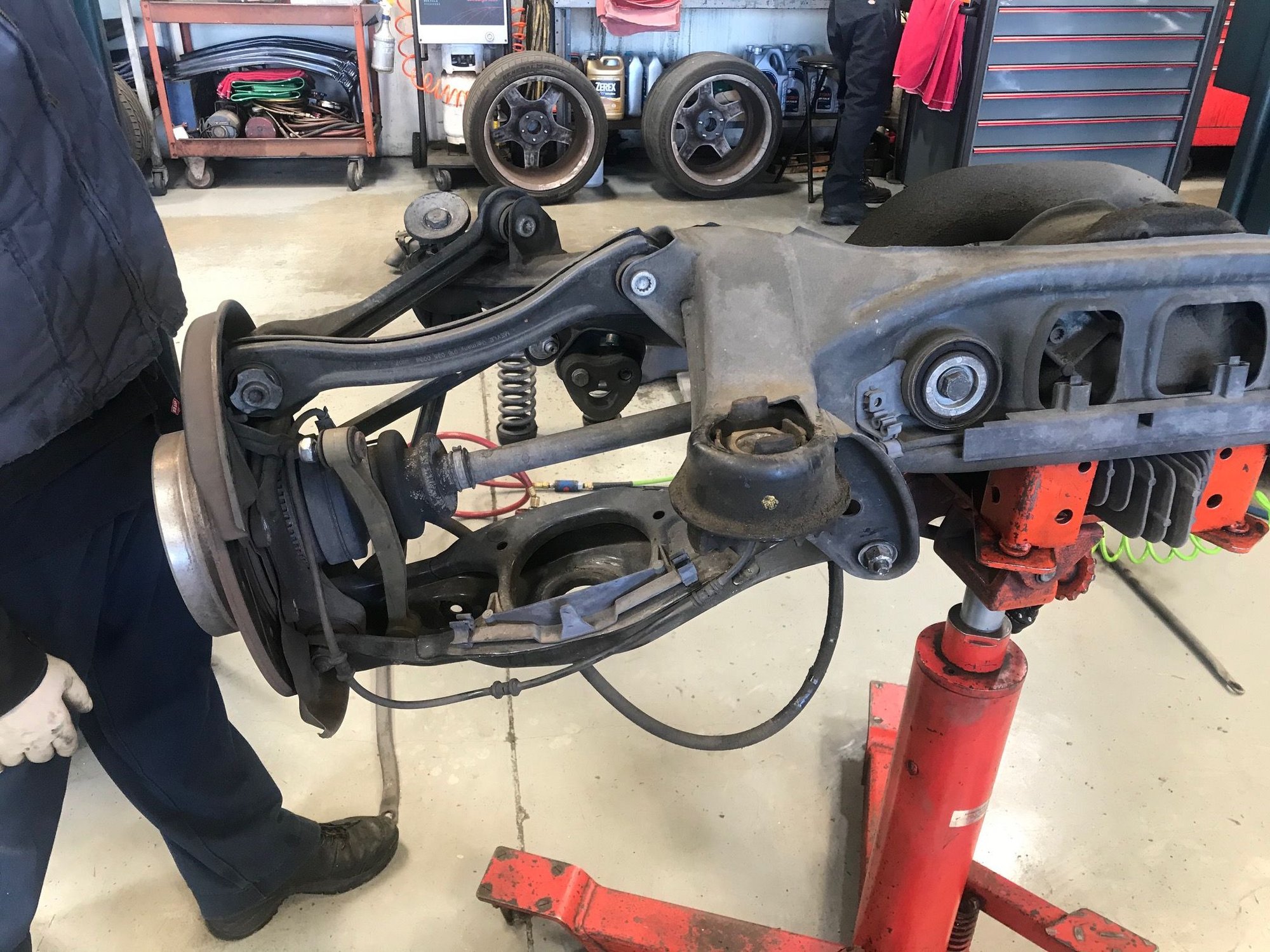

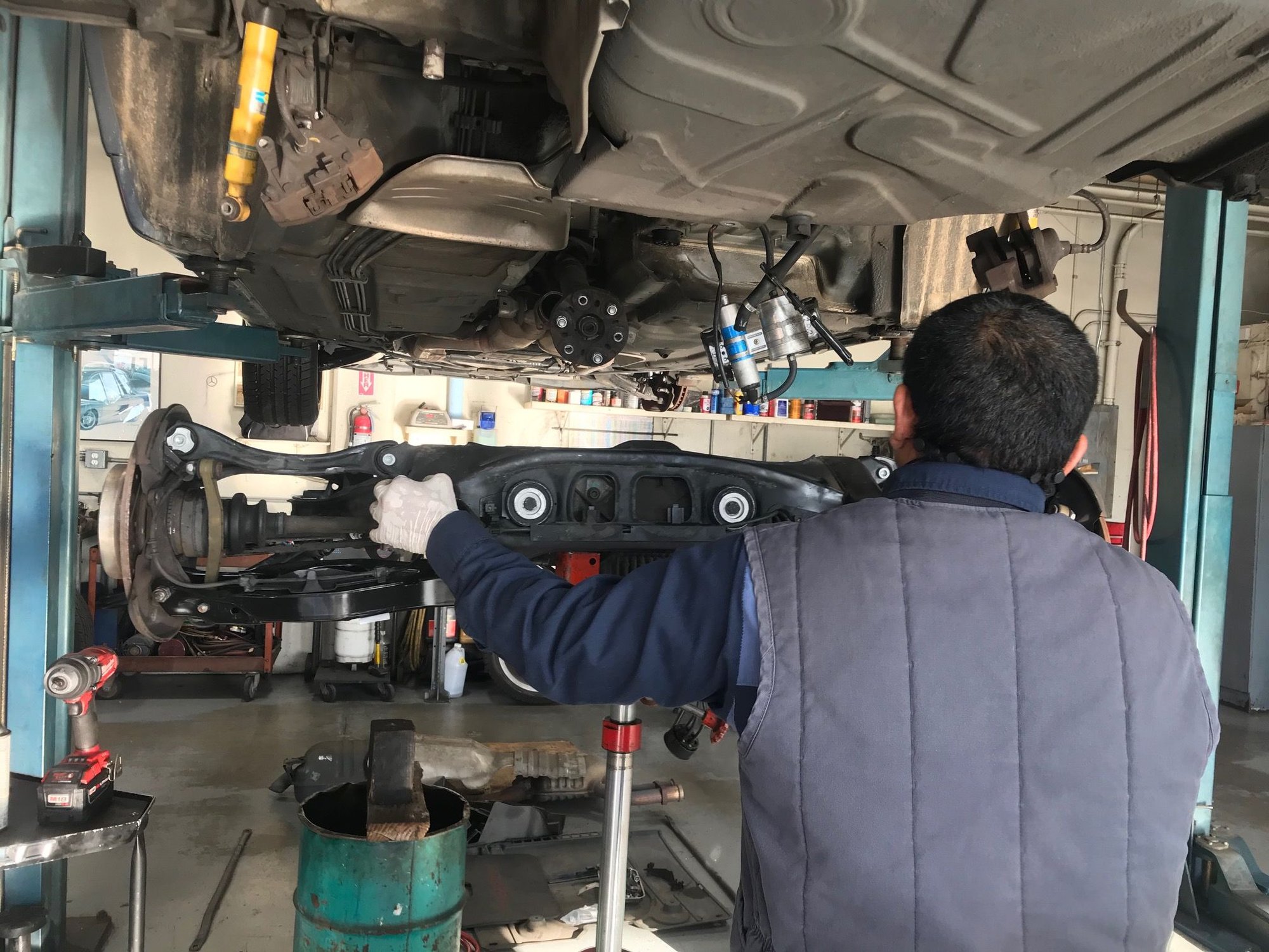

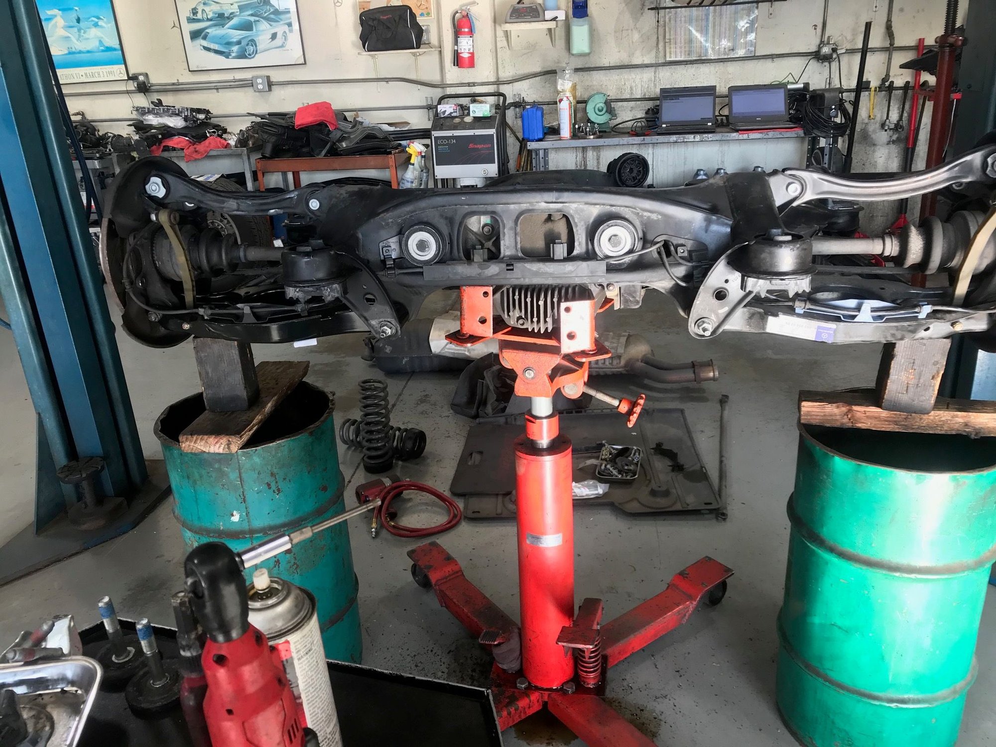

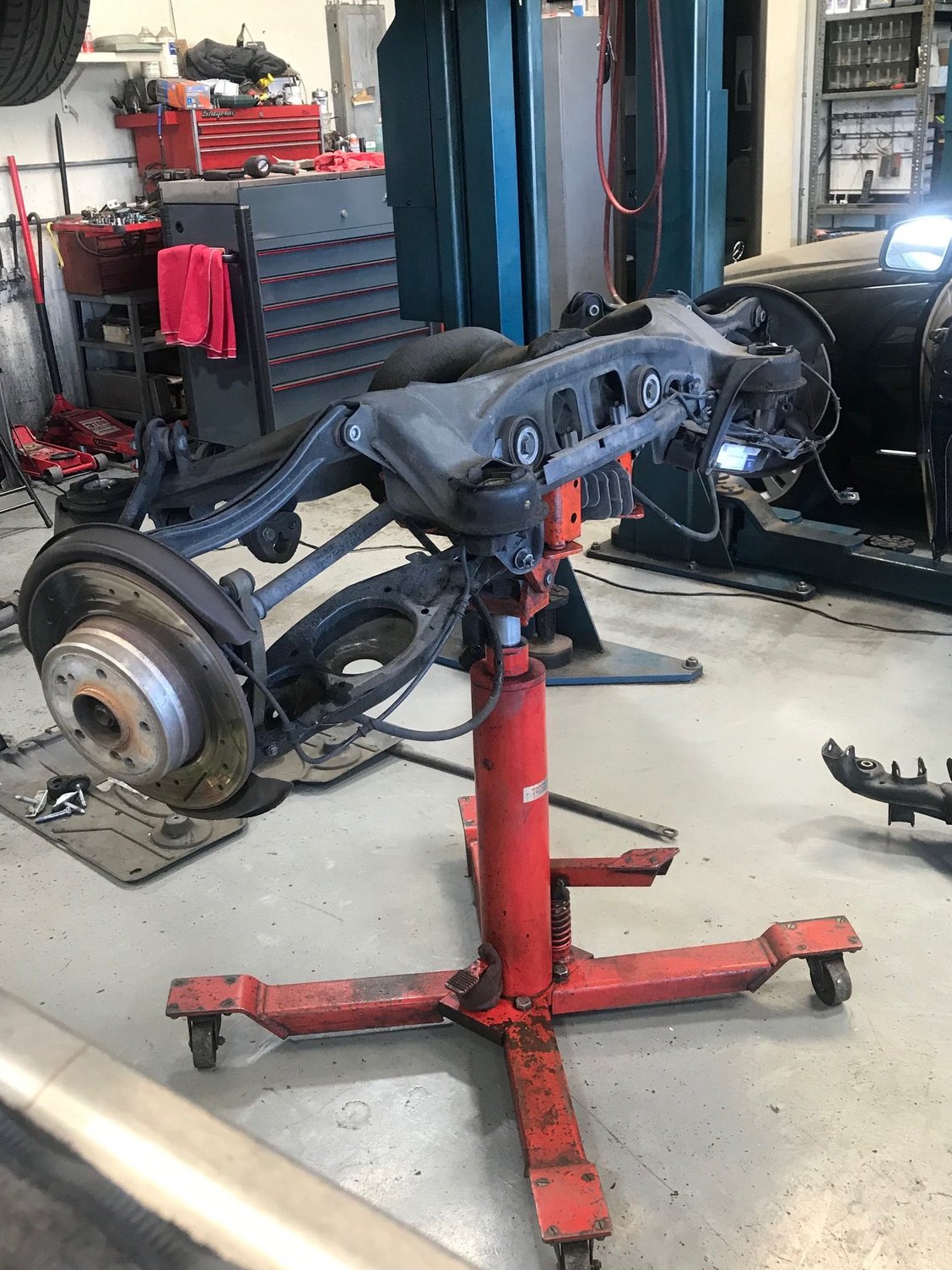

So we got started today

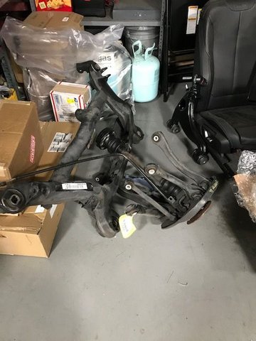

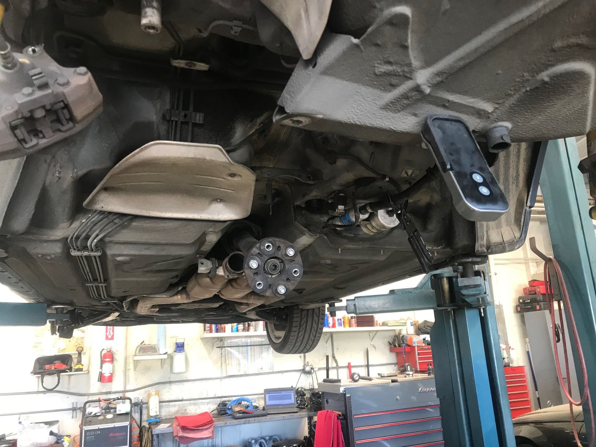

I have one concern about the part number on the subframe I bought, 129 350 8600 The seller stated that its1999 SL500 only however as far as I know all the R129 subframes are the same. I called the dealer and he said that number does not come up on the system. The seller had two of these and I just can't figure what could possibly be different between 98 and 99 SL500 subframe. The seller did state the VIN of both cars these came from and they are 99 SL500 US build, Does anyone know this part number.

If your subframe is still in the car you can check the very big part number sticker if its still there.
The replacement subframe should also have the enormous part number sticker.
Old Feb 24, 2021 | 08:47 AM
FATHERTIME's Avatar
Joined: Dec 2014
Posts: 326
Likes: 47
From: Yorba Linda CA
94 SL320 98 SL500 99 SL600 07 SL55
Well the frame is still in the car but the sticker I think is on the top as is the frame I bought. We may get it down tomorrow> All I can think is 99 is the first year on the SL500 with ESP maybe it has some bracket for a sensor?

My car has ESP and I don't think there are any extra brackets for the rear subframe.
There's the 3 body sensors; 2 on the strut towers and one near the battery. And the yaw sensor under the console. Other that that, ESP uses info from the wheel sensors via ABS and chassis info from ADS. Your car probably didn't have ADS, so that system didn't provide input to your setup. Besides, ADS get's its body info from the ride height sensors which are linked to the sway bars and the sensors are mounted on brackets that are attached to the body.
You should be good to go with your unbent subframe.

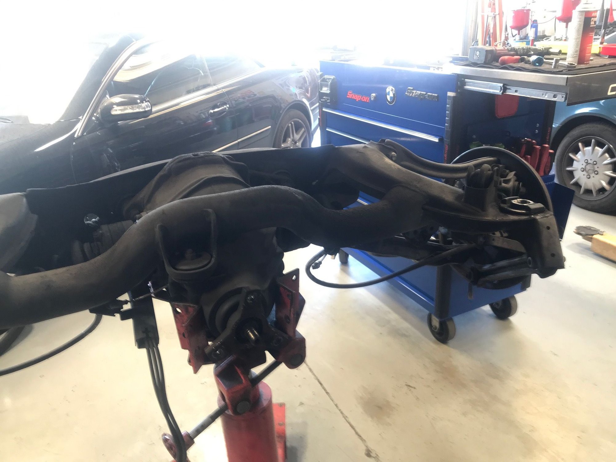

Sub frame will come down on Monday so I hope I all the parts I need. Funny no rear subframe bushings listed for R129 I put new ones about two years ago and used C43 bushings as recommended by mahunt they fit perfect. I know rear suspension will be rite but gotta see what front looks like when on the floor I hope I don't need a frame guy, As one of the pictures show that left control arm is really bent but the new one did slip in the way it should I see no visible damage to the front frame but something may be hiding. What the hell does that spoiler mean on my last post

I'd also take a look at the center link.
Although they look stout, I believe they are sacrificial. Also the idler arm and bushing.
That was a heck of a sideways knock.

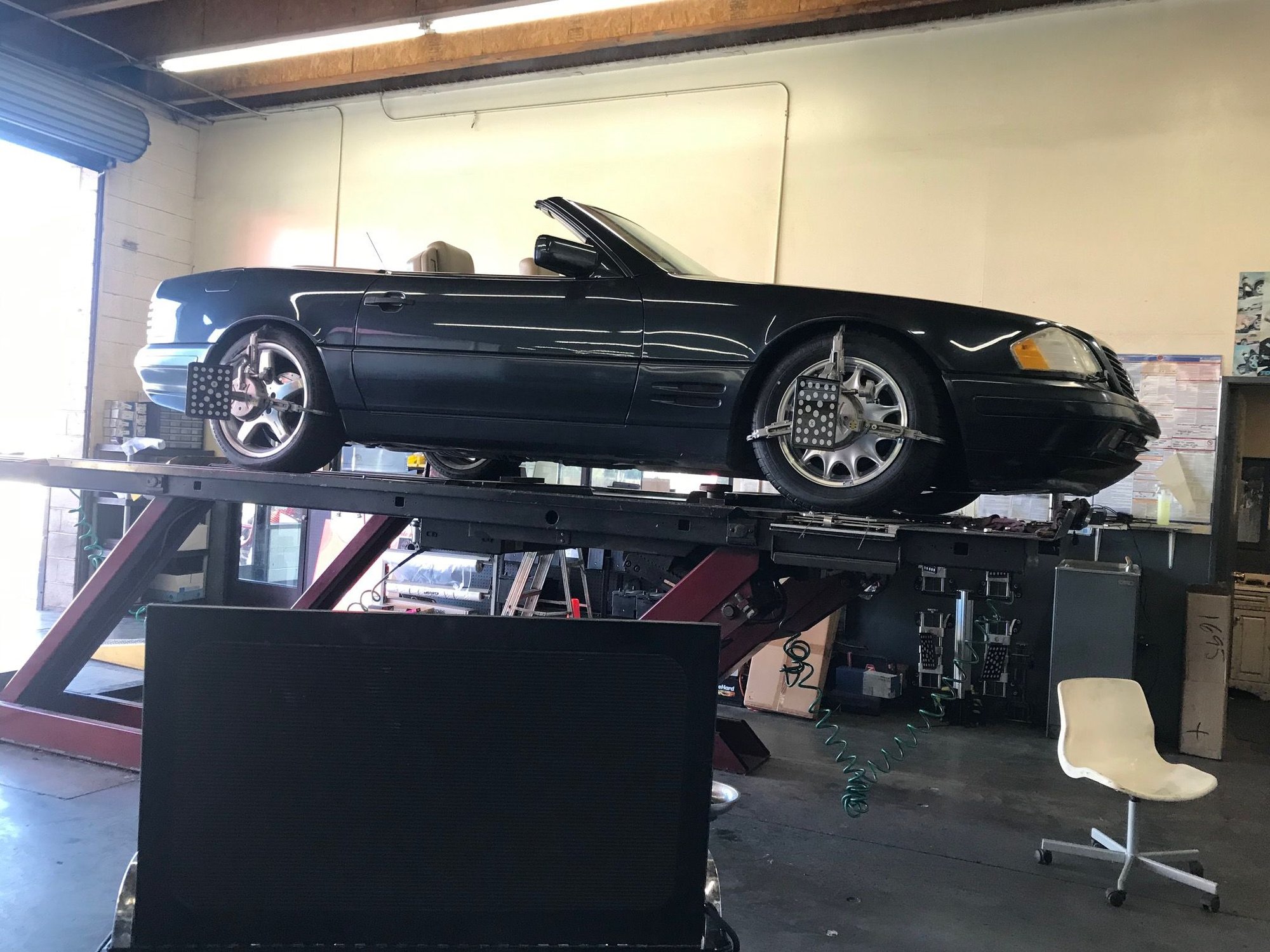

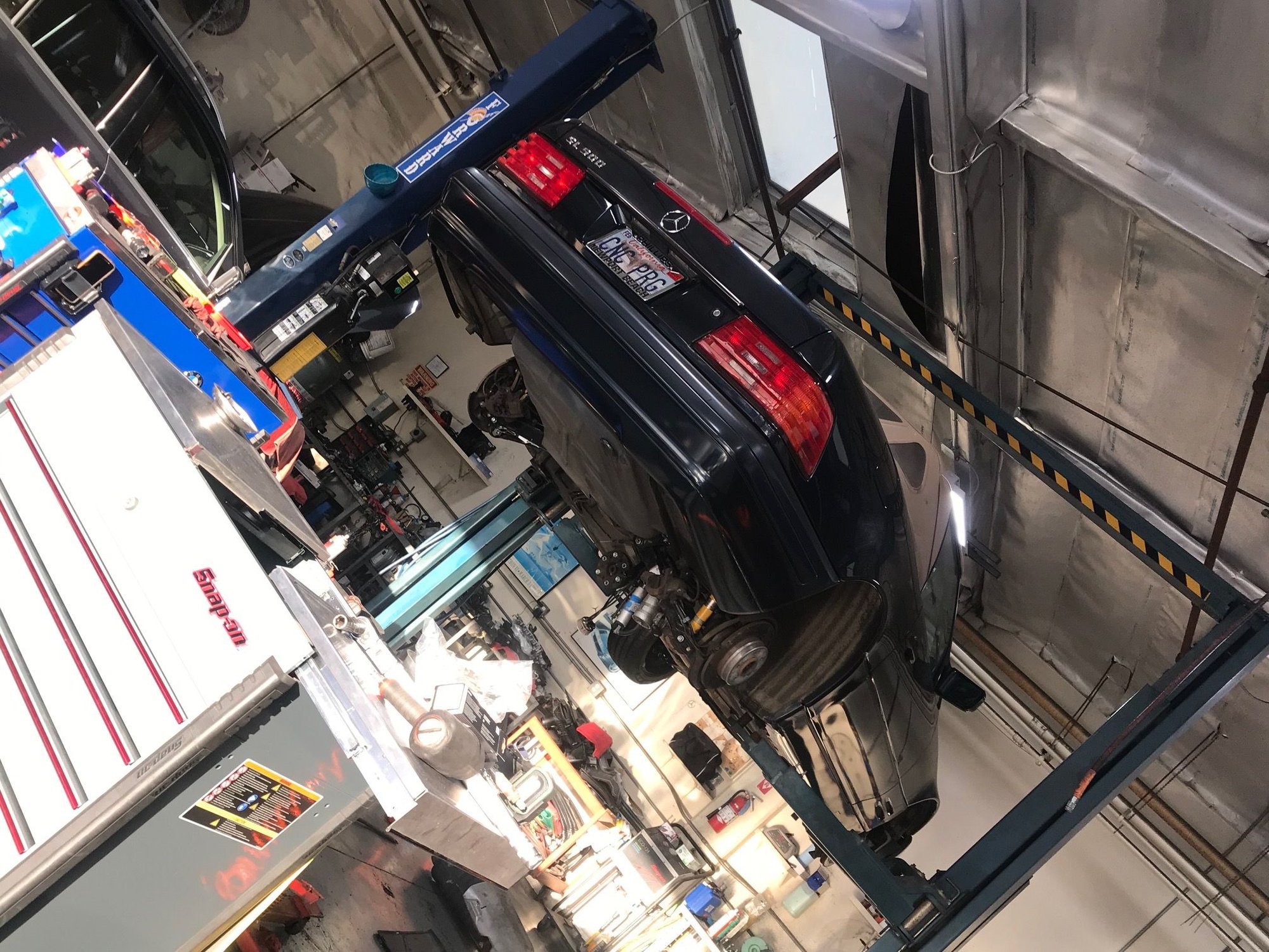

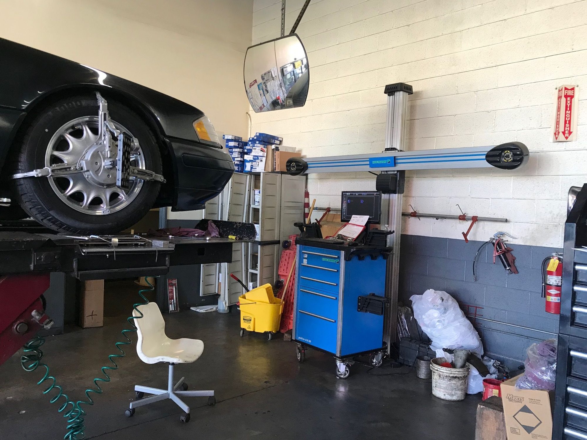

Ok so I'm on the road again front left frame not damaged so alignment went smooth car is tight as new. Waiting for a couple wheels from back east so used spare wheels from 500 and 600 for alignment .We put it together last night and today. I aint good at pictures but here's what I have may be a few duplicates of what I already posted. You can see that a rack is golden for this job. If I'm not mistaken I think mahunt posted pics doing thison his 600 on the floor My hats off to him,

FWIW, I had my trusted independent do an alignment of my '00 SL600 on a computerized rack like the one you have pictured. I got the impression from his comments to me that it was a giant PITA to do - something about how the R129 is setup makes it fairly unique and time consuming to dial in on the alignment rack. Did you have a similar experience?

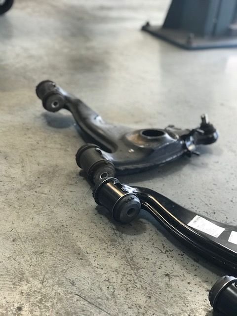

The V12 car alignment requires someone knowledgeable about ADS as the height varies. There is a procedure.
Fathertime,
It didn't look like you used new subframe or differential bushings.

I did use all 4 new subframe bushings and new differential bushings just may have missed that picture, Funny thing is I bought the bushings from same seller and he sent ma a note asking if all 4 subframe were for my SL500 cause 2 rears I ordered were for a C43. I told him not a mistake they do fit R129. I don't understand why no rears a listed for R129 even AZ Autohaus. My alignment guy knows engine needs to be running to make adjustments cause camber will change if car settles with engine off,
Problem is if car settles with engine off you can wind up with positive camber on one wheel.
