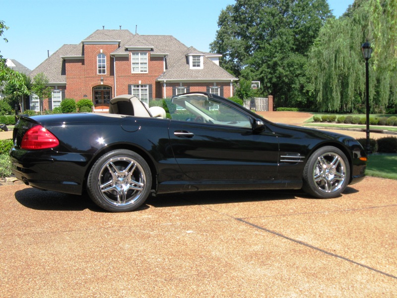

I also would like to thank you for taking the time to detail the steps necessary in completing this upgrade. After reading your post and DIY instructions, I decided to purchase a set of SL55 AMG tail lights for my SL500. Enclosed is a pic of my car pre new tail lights.
Thanks
Frank

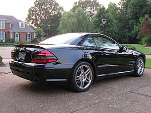

I got my new tail lights early this week. This morning, I installed them. I absolutely love the new look. See pic. The conversion was a bit of a challenge in some spots. "Tight fit getting the 8 mm deep well socket around the tail light posts. Another area of frustration was one of the carpet locks. In trying to remove I ended up taking the top right off the male post. I did manage to finally get it out, but a trip to the MB dealer is planned for Monday to replace.
