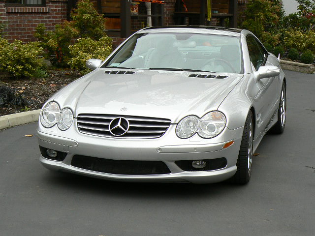

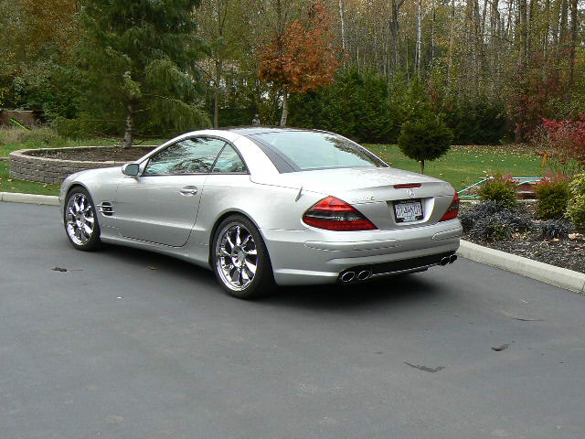

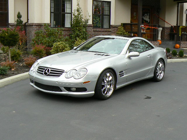

It started out that I wanted a better exhaust sound and the AMG 4 oval tip style. To do that I had to replace the rear bumper or cutout the bumper. The AMG rear bumper has a lip around the bottom which wouldn't line up with the 600 front bumper and side skirts. So I elected to go with a factory take off AMG sport package for R230. This is front, rear, side including new hella fogs.
Turned out the take off rear skirt didn't line up right with my car so they had to buy a factory AMG rear skirt (with the mesh).
They installed the Eisenman race performance exhaust with the 4 oval tips. The factory AMG skirt fit it perfectly.
The original grill is still installed. The old fogs were removed and the new ones installed with an HID upgrade. Big improvement.
I went to a number of places before I found one that has done it before. I was quite reasured to see a shop full with M5's 997's MB's all done up. At least this way the wrong rear skirt wasn't my problem or expense.
The Eisenman exhaust sounds great. Not loud enough for some but much better than the stock 600 exhaust (think singer sewing machine sounds). In hindsight I think I would have stayed with the AMG front bumper ,as well as the rear, instead or the sport. While much better than the 600 bumper its not as nice as the AMG bumper.

After pics
Heres a couple pics after swap
