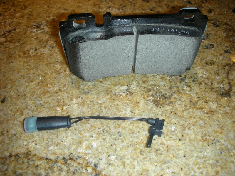

The sensors are really simple. I've attached two pics from a rear pad for a 2004 SL600, one with the sensor out of the pad, and one of the sensor in the hole in the pad. No special german technology here - when the pad gets worn down to the hole, the sensor breaks, the circuit is open and you get the warning. Replace the sensor and the circuit is closed and the warning goes away
Attached Thumbnails Should I change brakes myself Sl500 2003-dscn2484.jpg   Should I change brakes myself Sl500 2003-dscn2487.jpg
