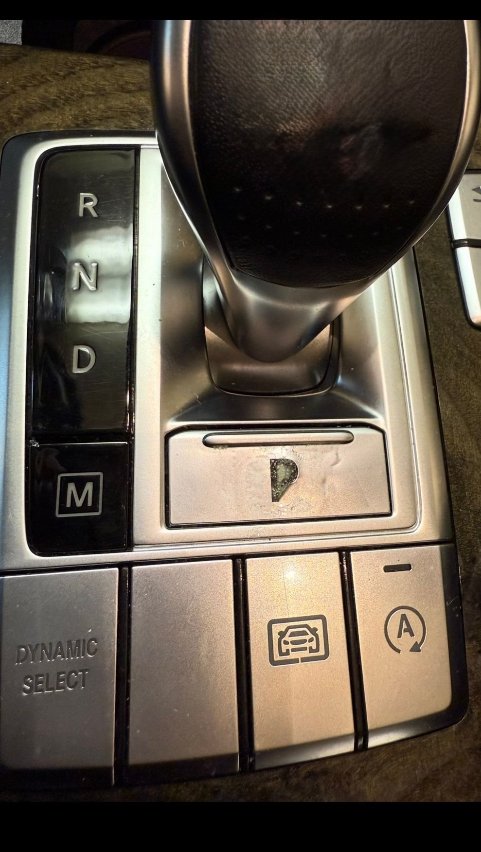

Smile Delaminated park button problem
Hi I have a 2020 Mercedes-Benz SL 550. If your Park button is coming delaminated like mine was, you can find a replacement button that looks fabulous on eBay, ( Mercedes Benz SL park button) or go to FixRite.us
After using the button
Before using the button
