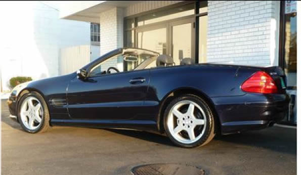

Did this today on my newly-acquired '03. Red "Close boot lid" indicator kept staying lit on instrument panel, not allowing top to open. As soon as the repaired latch re-installed, everything began to work properly. Just one question, only FMI: the bbs were there to "intermittently" plug the ports, but I'm thinking they were supposed to "float back in" to the ports at times to let air in, or release vacuum pressure. If that is a correct assumption, then the fix eliminates half of the function of the ports. Is there any downrange side effect of doing this? Or just Deutche uber-engineering? -- Also, thanks much, Nick, for this great info!
Here's my new wheels (Sun, 01/27/13, Collierville, TN):

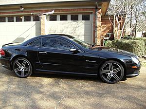

NikleinR6/Nick, I think you're one of my favorite posters/contributors. I am not having this issue, but appreciate your post and taking the time to write this up. Bravo!
I also absolutely love your SL.
Man you really know how to make a post. With the pictures there is no question how to fix this. I wish there were pictures with all recommended repairs. I just purchased a 2004 SL500 and have a lot of the components not working since I replaced the rear battery.
Thanks again.
