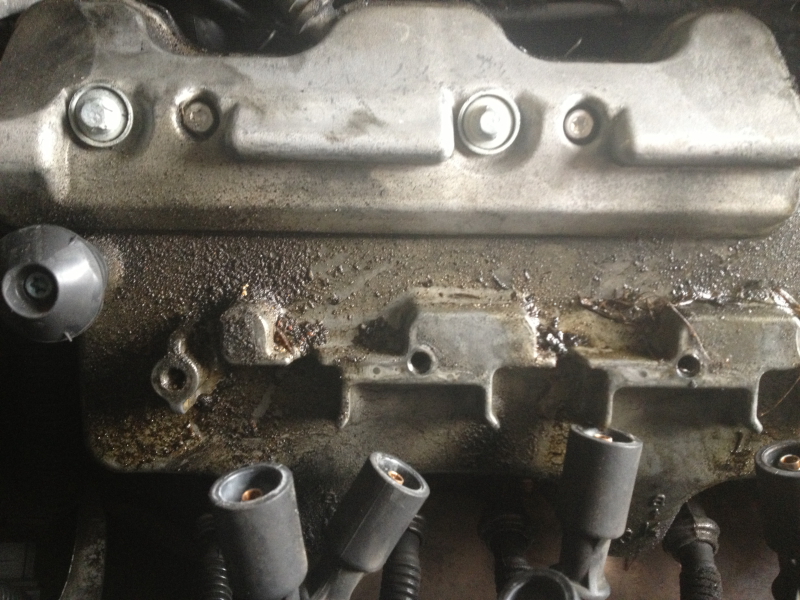

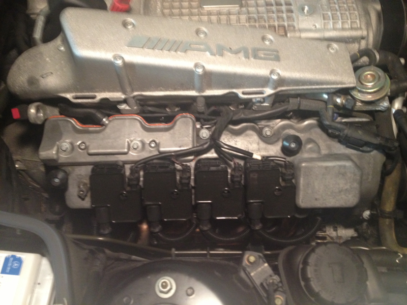

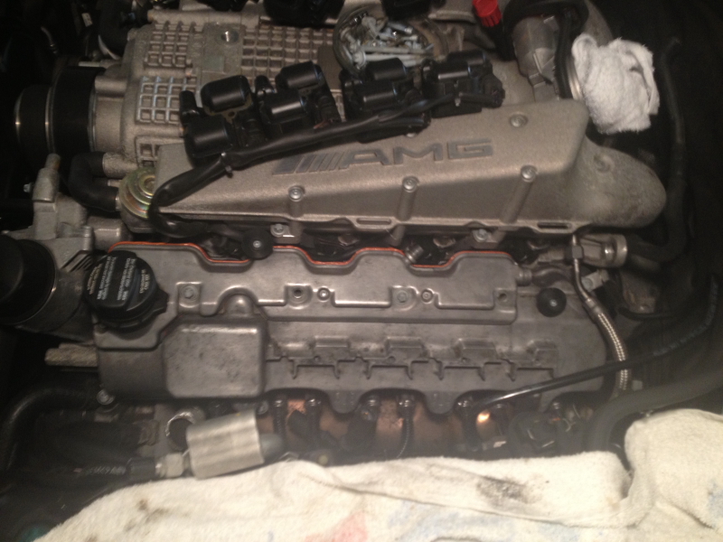

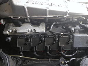

I just thought I'd share my experience with the job. The procedure was pretty straight forward and I believe most people with moderate wrenching experience can pull this off.
-Remove intake assembly
-Unbolt ignition packs
-Remove wires from packs
-Swing packs out of the way
-Decided to leave the wires on the plugs
-Remove all bolts from valve covers
---PULL OFF HOSES CAREFULLY
-Passenger side cover comes right out
-Driver side I had to disconnect fuel connection
---some gas will run out so I reconnected the line while I cleaned my covers
-Took everything inside and degreased all parts
---the small vent housings needed a little "help" to come off
-Used a high temp gasket maker to reseal the vent housings
---kept covers at room temperature indoors while everything set
-Returned to car and placed new gaskets on the covers
-Installation is reverse of removal
-Letting the car sit over night to allow full cure of gasket maker
For reference I have 35,xxx miles and it's driven almost everyday
I hope this post helps a little for those who want to tackle the job themselves and I have attached some pictures for reference. I can answer some questions if any....
Next up is transmission mount
Attached Thumbnails Valve cover gaskets replaced-img_4285.jpg   Valve cover gaskets replaced-img_4287.jpg   Valve cover gaskets replaced-img_4289.jpg   Valve cover gaskets replaced-img_4297.jpg   Valve cover gaskets replaced-img_4298.jpg

Sorry I forgot the pictures, they are up now. The hoses were actually in really good condition, still very malleable, clean inside and not leaking. Replacing those hoses seems pretty easy and don't think removing the valve covers is necessary.
