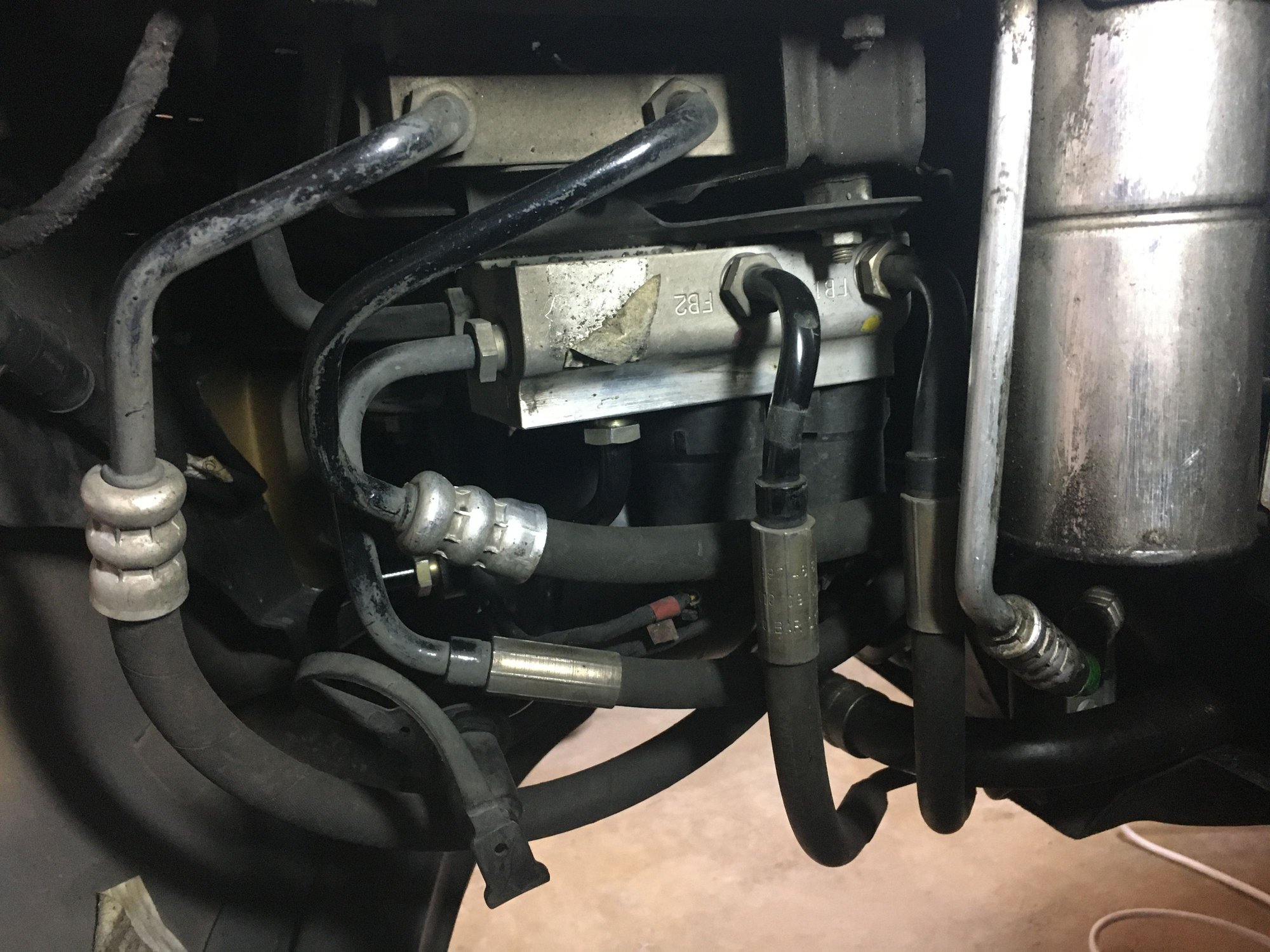

Jul 8, 2022 | 12:56 PM
My technician has swapped the pressure line and return line. However, the pressure relief valve is still seeping. Any reset procedure is required to perform after the pressure relief valve is opened ? I haven’t asked them to check the pressure level.
Before swapping
Reply 0

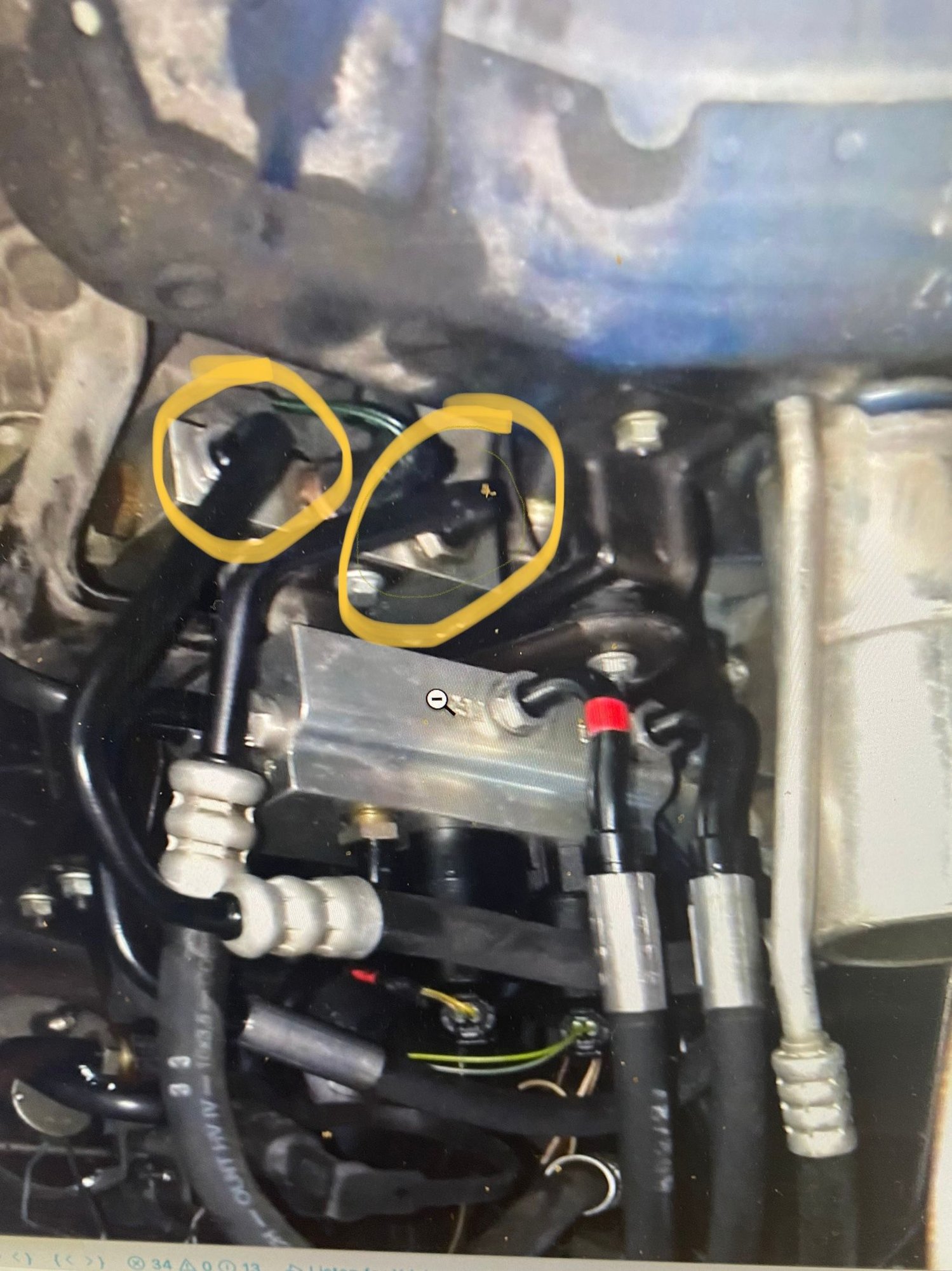

Jul 9, 2022 | 01:06 AM
Here’s how the lines on my 2005 SL65 were configured from the factory.
Reply 1
Jul 10, 2022 | 09:59 AM
The pressure regulating valve is meant to divert pressure INTERNALLY through the return. Swapping those two lines dead ends the return from the pressure valve and the rear valve by putting it on the wrong side of the return regulator. I think there is some sort of rupture disk in the pressure regulator that will release oil in this case. It is not part of the valve function, there is no reset, you need to replace the valve.
Reply 1
