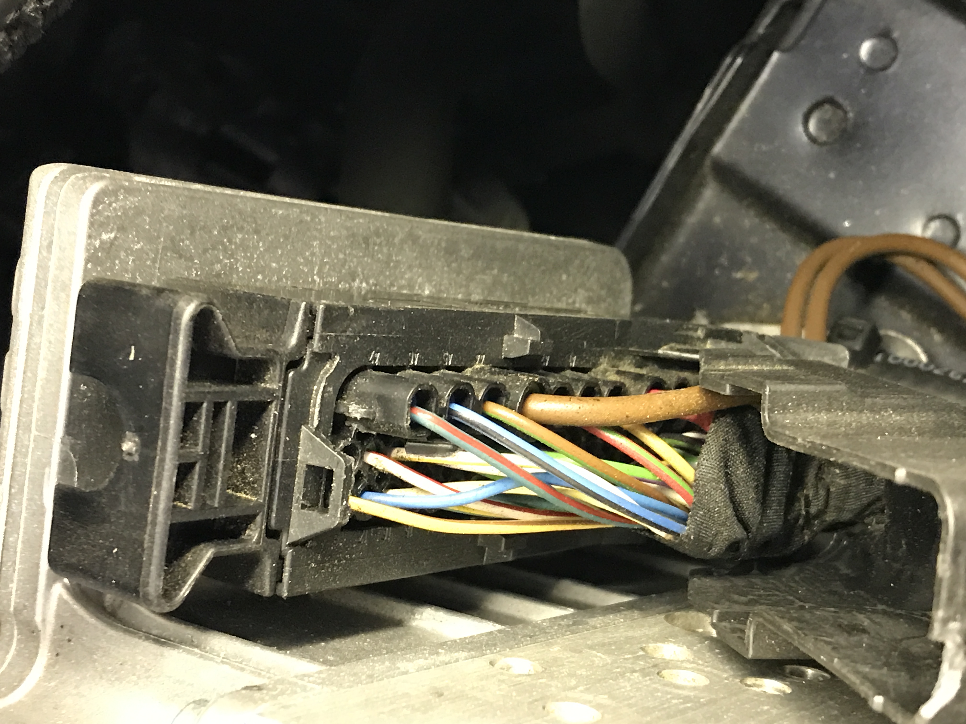

Hi Rodney here are a couple of photos of my SBC unit can you please explain to me how to unplug this. I don't see how with out Breaking anything thanks Dave

There is a way to "manually" deactivate SBC:
http://benzbits.com/r230/DeactivateSBC.pdf
Like I said, don't try to unplug it - that does not release pressure on the system, it only keeps it from re-pressurizing.

I really don't know how to unplug it. I'd have to look at the connector to see what type of locking system it uses. I'm at the beach this week, and we don;t take my car (wife won't ride in it for the 4 hour trip), so I'll have to check when we get back next week.

Thanks again Rodney ok enjoy your beach time and relax I did post photos in post #7 I don't know if that helps? Thanks again for the info
Hi Rodney hope you had a relaxing time at the beach. Was wondering if you had time to look at the SBC plug on how to unplug it? Thanks Dave

Sorry, Dave, I totally forgot! It's actually very easy. I was fairly certain I knew the solution, but wanted to put my hands on it to verify. All you do is pull straight up on the part shown below. It even has indentations on the sides for finger grips. It will lift easily about half an inch, then you have to pull harder to get it to release the connector. You'll see the connector begin to move away from the unit as you lift. There is a gasket on it to keep out the elements, so I'd clean and re-grease it before reconnecting.
Please keep in mind that while this will disable the pump motor and keep SBC from cycling or operating the brakes, it DOES NOT relieve any pressure already in the system. You should not rely on this as a substitute to properly disabling SBC when servicing! Also, after replacing brake components, it is necessary to have the SBC system recalibrate itself, which only happens if it was properly disabled.
