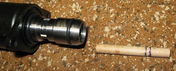

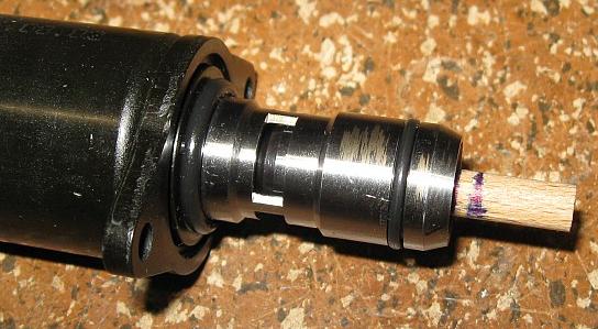

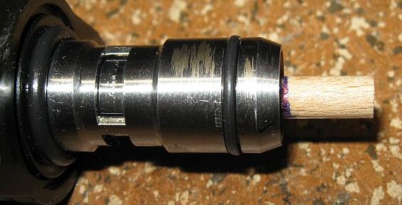

Your valve appears to be moving around 3mm. Have a look at an open valve with a 6mm wooden dowel inserted to gauge its displacement (attached screenshot from this German site).

How are we sure the German website has a good valve? Not saying you are wrong, but just have 2 different versions; one person that had changed a bad valve that says the valve should open up almost the entire length of the window.....and the bad valve has the same or even alittle more travel than mine.

Used the butt end of my caliper to test the travel, it does have a total travel of 3mm. I also tested OHMs and its the same as the German webpage... have a friend who will test a spare.

Although no surprise to Bobterry99.....got a 2nd valve and same travel...if you cant measure it what you should see if the beginning of the beveling to travel to the midpoint.
