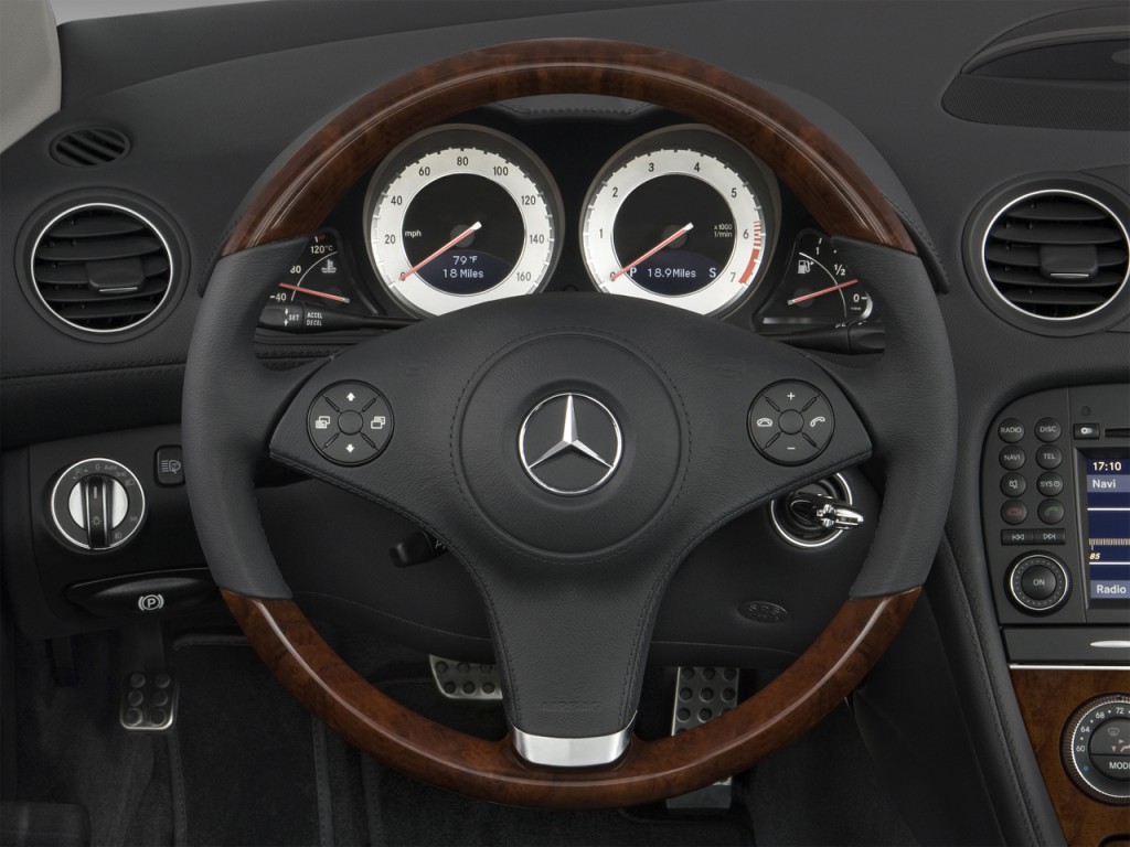

- the thing that i least like in my car is the current steering wheel. I would like to change it for something like the steering wheel of the next image:
would it possible with all the old steering wheel options working?
I am not sure all of the buttons would work. That wheel has 10 buttons, which is the newer style, where your will have only 8 buttons. IT might would require some rewiring of the harness so that 8 of those buttons would match the outputs for your wheel's original 8. An easier swap might be with then MY2009 facelift wheel, as it should be plug and play:
Many thanks for your help. This steering wheel that you send in the picture is great. Can you give the part numer of it? is just plug and play?

The 3 spoke steering wheel on the pictuer looks great i think
Also the buttons are the same from the first model year of the R230 so do you think that this 3 spoke steering wheel will fit a 2003 and up SL, R230?

I don't see why that wheel could not be used on an earlier model. The only issue might be the wiring connections from the clockspring. I recall a forum member with a W203 who was trying to replace an older wheel with a newer one and ended up having to do a little but of wiring to match the new wheel, even though it had the same buttons.
Somebody jnow tge part number of the wheel of the last picture?
Old Sep 6, 2017 | 08:23 PM
Rudeney's Avatar
MBworld Guru
Joined: Dec 2009
Posts: 10,782
Likes: 1,011
NO LONGER ACTIVE
A2304601876 (plus color code 9E38):
https://www.genuinemercedesparts.com...PWxheWVyXzE%3D
Plus you need the airbag:
A2308602302 (plus color code (9E38):
https://www.genuinemercedesparts.com...23086023029e38

When i come to think of it, if you change to the newer 3 spoke steering wheel perhaps you will have to change the slip ring behind the steering wheel?
