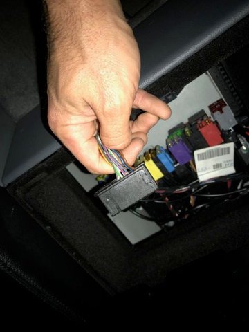

I did find this unconnected inside of the fuse box behind the passenger seat - any clue if this might be a contributing factor? Or is this perhaps just part of the wiring loom for some option that my car does not have...?
Does the SOS lamp just above your rear-view mirror blink when pressed? I can't confirm without seeing the pin faces to the plug, but it looks similar to the Tele-Aid plug. The TeleAid system is now obsolete, and it is known to malfunction, causing the Tele-Aid unit too continuously attempt to make a phone call, thus resulting in overnight battery drains. Simple remedy is to unplug the TeleAid unit the which resides near that plug you're holding beneath the rear storage cubby. The original stereo amp also resides beneath those cubbies (Passenger side), as does one of the diversity antenna control units (don't know the official name?)
