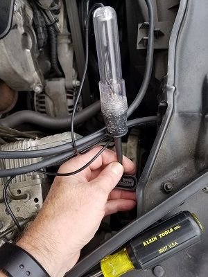

2) Unplug the 6 pin plug from the rear of light housing..Using a test prob check for power.
DO NOT TURN ON LIGHTS.. activate turn signal only.. on my 2003 SL500 the signal wire is black with white stripe..
if the wire has power you have found the problem. The contacts in the housing are bad.. Now you can replace the old plug with the new wired plug.
3) with a small standard screwdriver push the female pin down and out of the electrical plug..
4) use the small plug included in repair kit to close hole in plug
5) connect power wire to new plug and attach ground wire to chassis.
activate turn signal..
install new socket in housing and you are done

I had this problem on my 2005 C230. I used the OP's troubleshooting procedure, and I have power to the white/black wire on the connector when I turn on the emergency flasher. I don't see any damage to the socket, but it appears that a defective bulb socket is the most likely cause. I don't like to "throw parts" at a problem, but I have ordered the bulb socket repair kit because I don't see any other potential cause for the problem.
