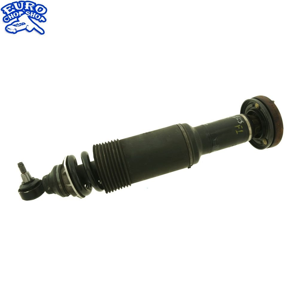

1) Was your Mechanic a Mercedes Specialist with knowledge of Mercedes wheel bearings? Since it would only cost you a tube of lubrication grease, and a few moments of your time, I'd remove the wheel bearings and repack them. This is an often overlooked routine maintenance item that likely is overdue anyway. Often the retaining collar for the wheel bearings on Mercedes loosens and simply needs to be reset, which is just a matter of screwing the collar snug then backing off 1/8th of a turn and tightening the allen bolt.
2) Check the condition of the bushing on the Tie-Rod fitting on the lower end of the shock absorber. This is a common wear / failure part on the shock. You'll need to have the wheel off the car to check for any play and to see signs of any cracks in the rubber.
You're looking for wear in the spindle on the left side of the above picture.
